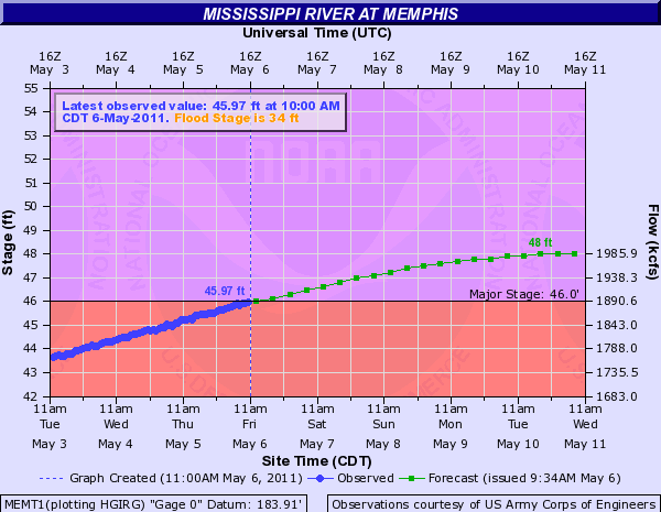

I don't know if you've heard, but we're experiencing near record flooding here in Memphis. As such, driving through certain parts of town can be a challenge. I was wondering, without a snorkel, how deep I could drive through and be alright. Should I use the location of the air intake as my estimate?
Thanks.
