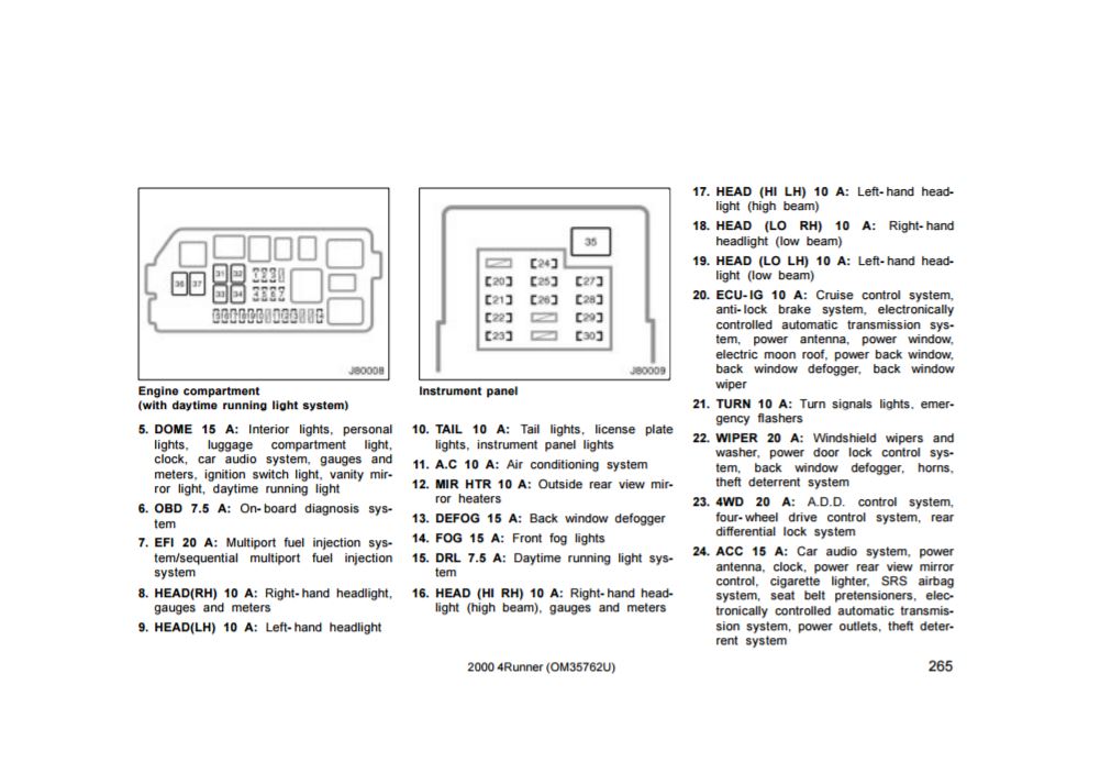

Thanks guys. I like both of these options as well, but before those I would really like to try and tap into the automatic functionality. I think I might order a cheap strip of LED's to see what I can get to work. According to the manual, the DRL system has a 7.5A fuse, so the two-pin connector may actually provide power. I'll have to verify this with a multimeter later, unless someone knows this already. If it does, then I *think* my plan will work. I don't know enough about this though, so I won't find out for sure until I dive in.
Actually, that fuse is just for the relay that switches between the DRLs and the full heads. Take out that fuse, and you will be stuck in DRL mode (if they have not been disabled. Then I'm not sure. Might have no lights at all.)
Ah I gotcha. Yeah, more trouble than it's worth. That's what I get for thinking it would be easy. XD
