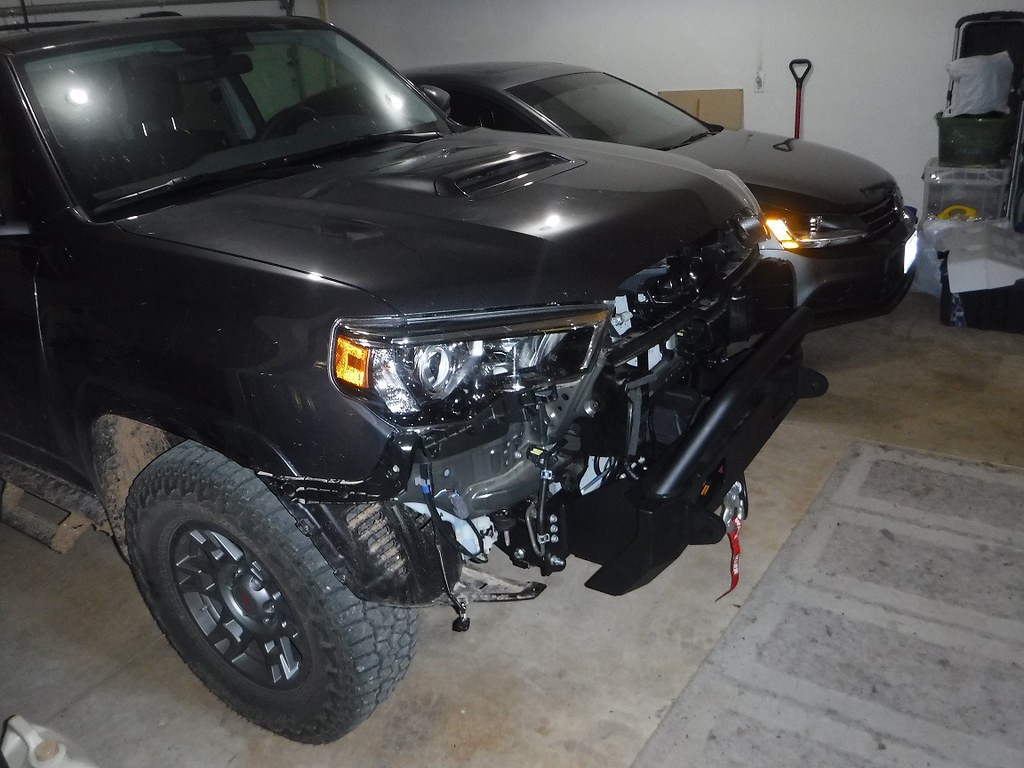

Pic from day one - home from the dealer.

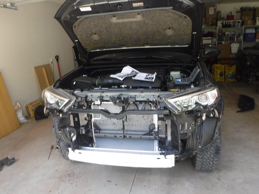

The front end fell off...
Need to wire the winch (Warn VR10) to truck, torque everything down, cut and re-install the front end today.
I need some air or electric tools.

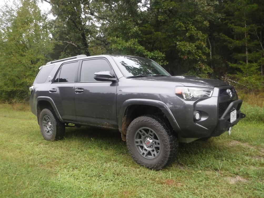

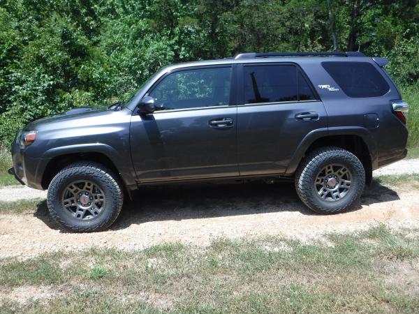

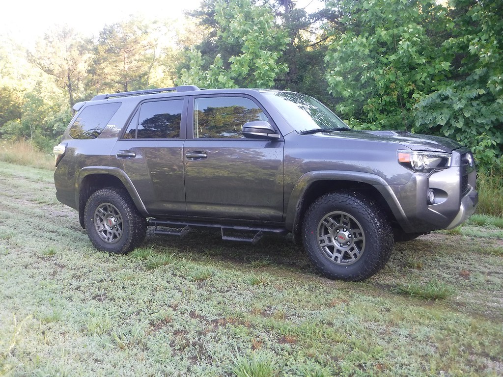

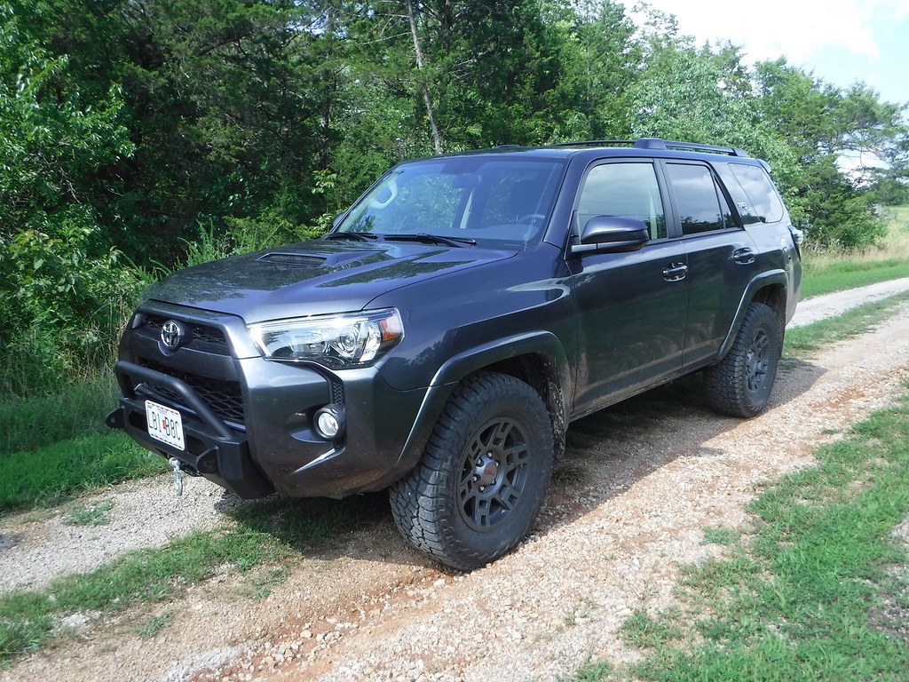

July 25th, 2019 - had an Eibach Pro Truck lift installed. Bought the kit from Tire Rack and had it shipped (free shipping) to my house:
https://www.tirerack.com/suspension/suspension.jsp?make=Eibach&model=Pro-Truck+Lift+System
Had a shop that specializes in vehicle lifts in Springfield, MO install the lift for $475.
BKS Built Trucks, LLC
This cured the sagging front end plus greatly enhanced the overall on / off road handling of the vehicle. Nose dive on braking is gone + it's tight through the curves. The awful body roll of the non-kdss 4Runner is gone.

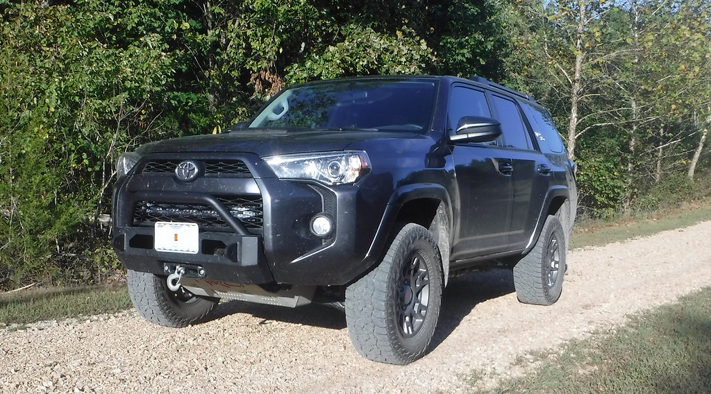

Begining of October 2019, I installed a Caliraised light bar in the grill. I live off a dark, mile long, private road and use the light bar almost every evening.
Mid October 2019, I installed Shrockworks Rock Sliders. They are a pita to install with those stick nuts. Found that buying longer bolts from the local hardware store made the process 10X easier.
5th Gen Toyota 4Runner Rock Sliders, 2010-2020
Only complaint on the sliders is, they stick out past the wheels and cause a bit of a wind drag on the road. Noticing that my MPG has gone down from 18/20 with lift to 18 with the sliders added. Like the nerf bars, they make it a pain to get in and out of the vehicle.

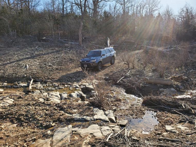

The sliders did save me from having body damage while off roading in the Ozark National Forest in Arkansas at the end of October.
Here's a video of trail we were on taken by a Jeeper going the other direction:
YouTube
Plus a crappy little video of me doing one of the many water crossings.
YouTube

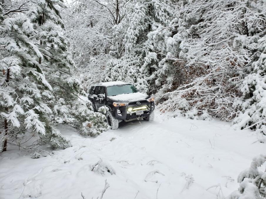

Visited my family in Michigan over thanksgiving. Found some snow to play in off road:

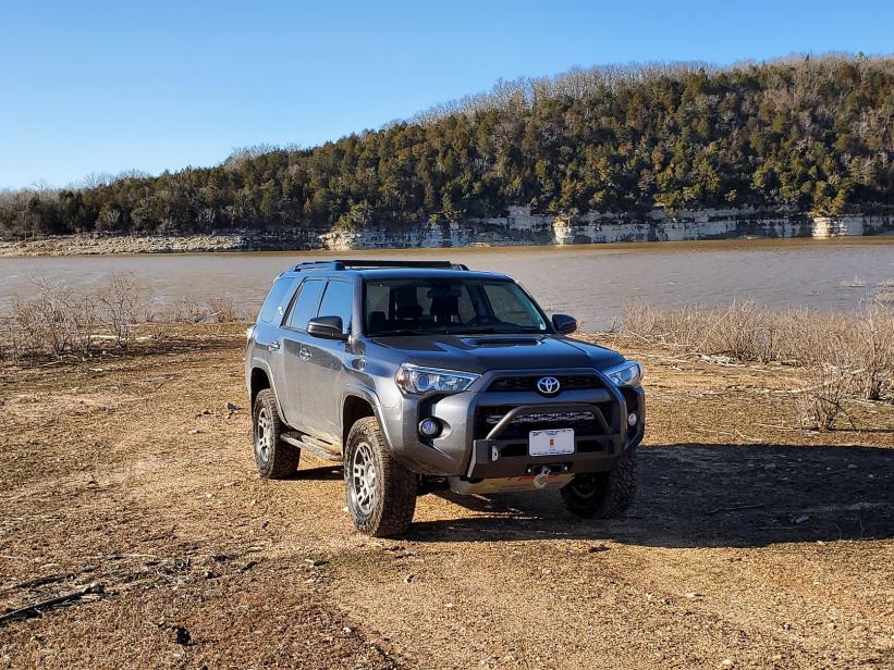

How the truck currently sits:

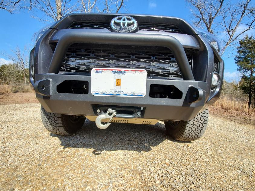

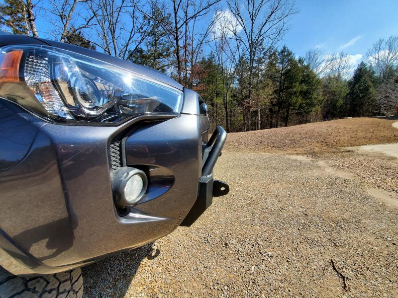

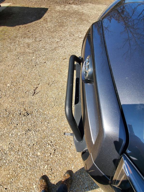

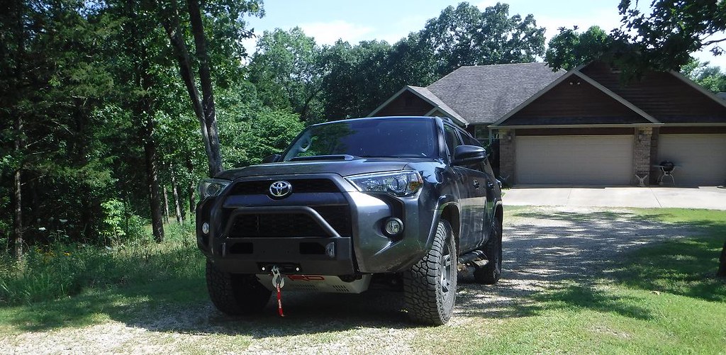

Do you have side profile shot of the WARN winch mount? Trying to decide between this and Victory 4x4
I can snap one for you - front or side? Feel free to post a Victory pic you want to compare the Warn to.
Things I like about the Warn:
1. Readily available on the shelf everywhere - no long lead times.
2. Already powder coated black. No additional expense / hassle of finding a local powder coating shop.
3. Holes already drilled for easy mounting of a front license plate.
4. Heavy duty plus easy to reach controls.
5. Non-angled fairlead.
One of both if possible. I like all of your points and the non angled fairlead. The Victory appears to be the most tucked in by far. However the price/power coating seems to be a winner to.
Here you go.

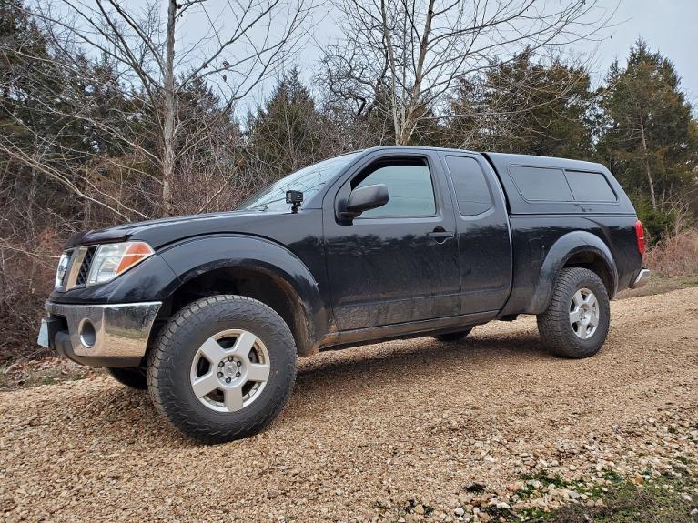

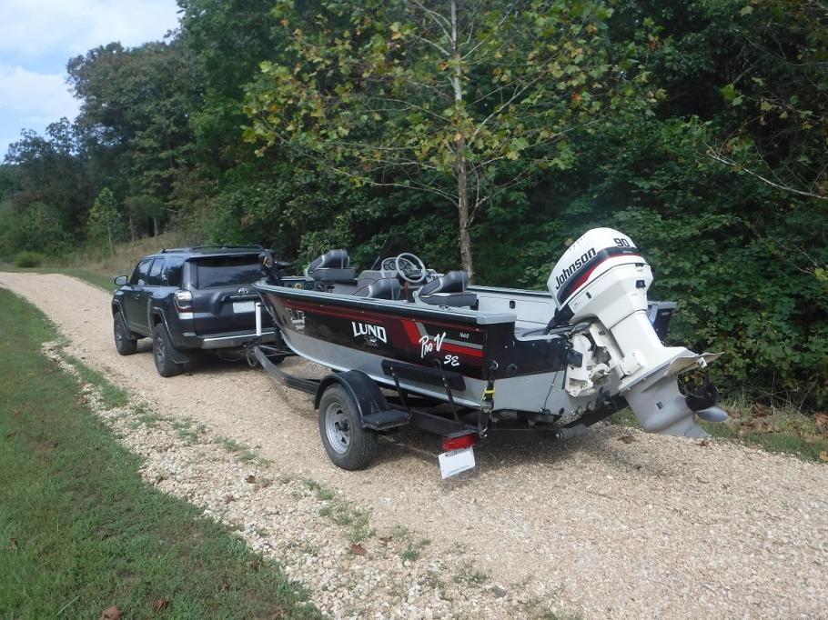

Few weeks ago I brought them my 2006 Nissan Frontier and had them install a set of 4 Bilstein shocks plus a PRG spacer lift. Had the lift sitting in my garage for the past 3 years.
I bought the shocks from them and couldn't beat their price anywhere online. Install was $500 including alignment. Bilsteins were $100 each.
The $475 (labor) quoted to me on the Eibach lift included an alignment done by a shop across the street from them.
Still loving my Eibach Pro Truck lift. Only negative, which I believe applies to all lifts... I had a good bit of rear end sag pulling a boat, that my brother in-law gave us, home to Missouri from Minnesota. Unhitching the boat resulted in everything going back to normal.
Cure for that rear end sag while towing long distance is a set of inflatable Firestone Airbags. Towing short distances - house to Bull Shoals Lake, 5 miles away, is fine - no sag.
Boat / Nissan:
