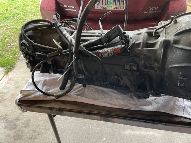

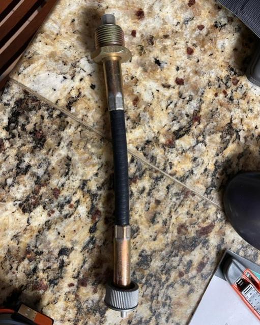

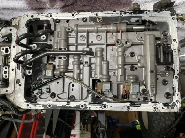

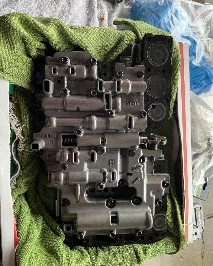

Finally had some time(aka: got off my ass) with a week left of my sabbatical to take a look at the donor transmission. Took about a billion pictures and took my time to document it.
Someone had been in it once before just looking at the slight dents in the 3 pressure tubes. Nice thing is that the valve body came off the main housing of the transmission with the gasket intact. Having the gasket stick to the original transmission is what screwed up the other valveBody and necessitated having to split the original valveBody to get a new gasket in there, possible the old valveBody didn’t get put back together correctly or was just plain fubar.
Either way I have new solenoids and a filter to go back in.
Plan is to slap this one back in the 94 and hopefully that will cure this thing having no reverse and going forward while it’s in reverse. Stupid duals being the auto debacle started just about 3 years ago. This has been motivated to get the #4runner back in the road.

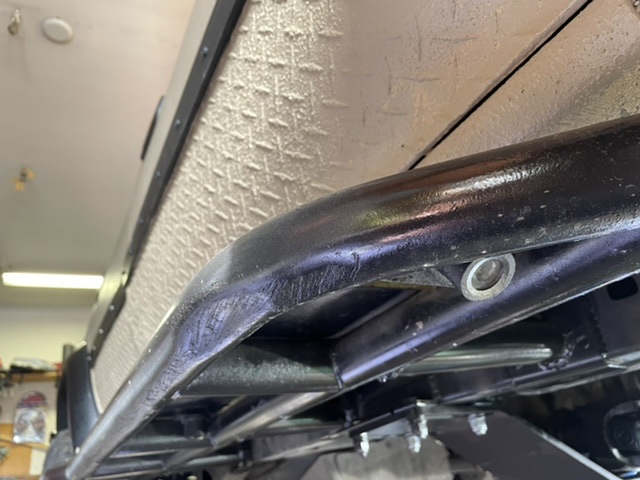

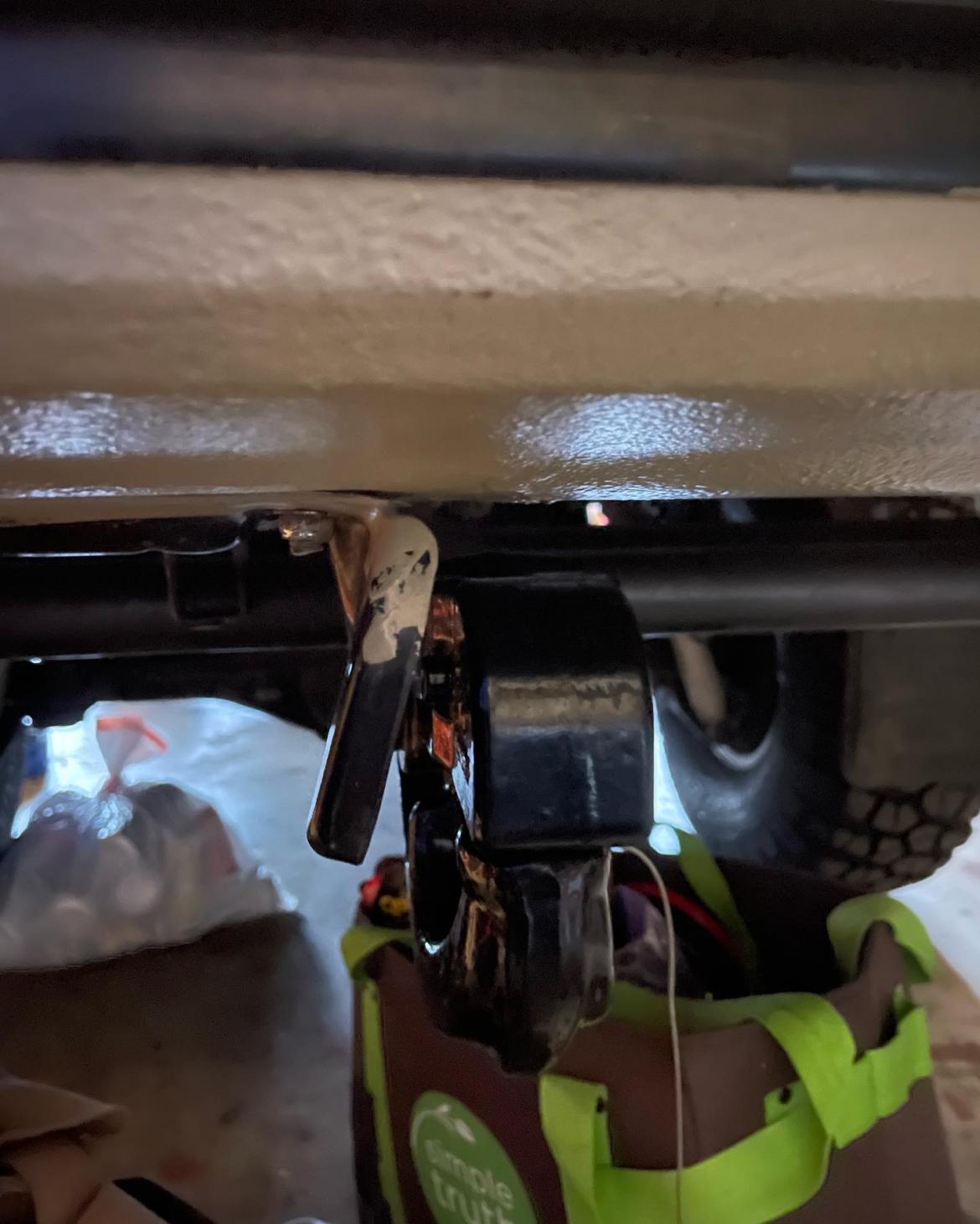

Oh and the last pic I found that the tailgate brace for the rear tire mount hit the pintle hitch so tweaked the brace slightly to the left, clears the hitch just fine now and still supports the swing out tire mount as it should

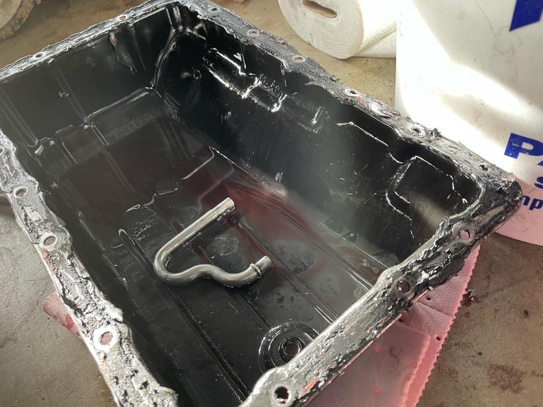

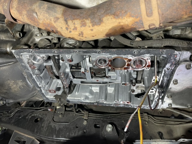

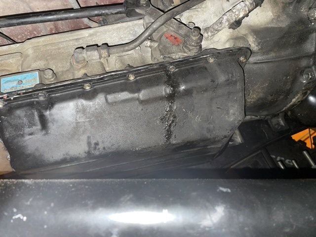

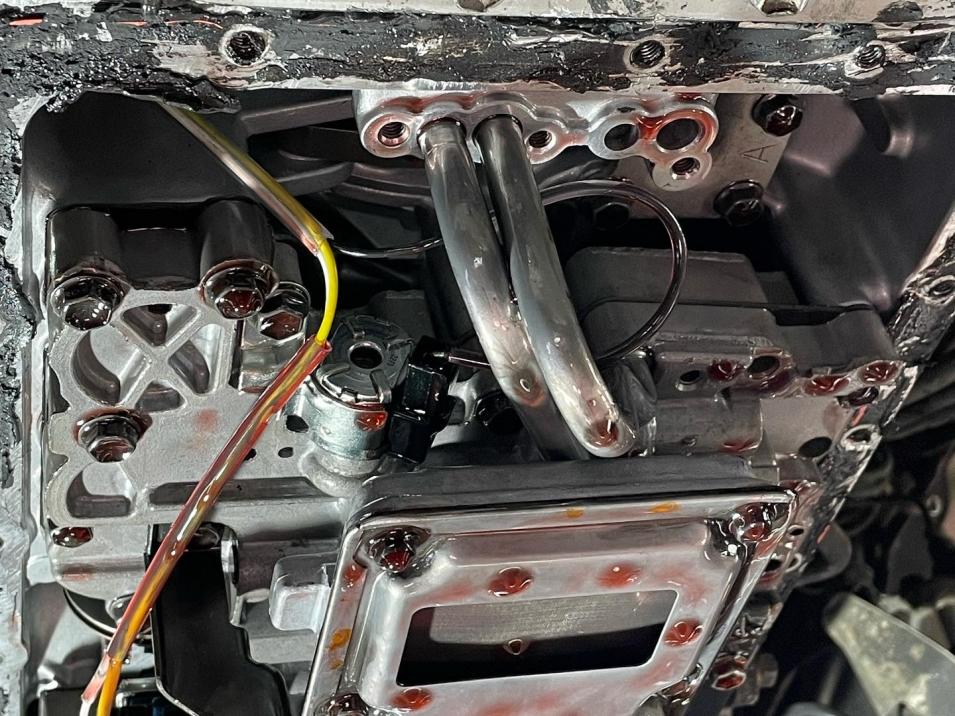

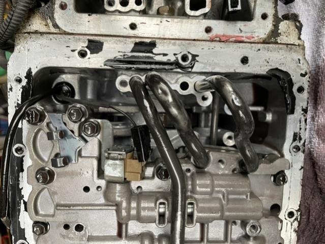

So I finally dropped the transmission pan today. One of the 3 return/pressure tubes was loose and dropped when I lowered the pan.
not sure if I found the proverbial smoking gun on my transmission issues but I am gonna go ahead and swap the valve bodies since I have a strong distaste for ATF and would rather just do it all at once instead of pulling the pan and waiting for the ATF to stop dripping again.
Such a pain in the butt

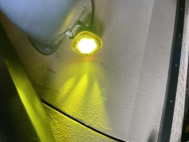

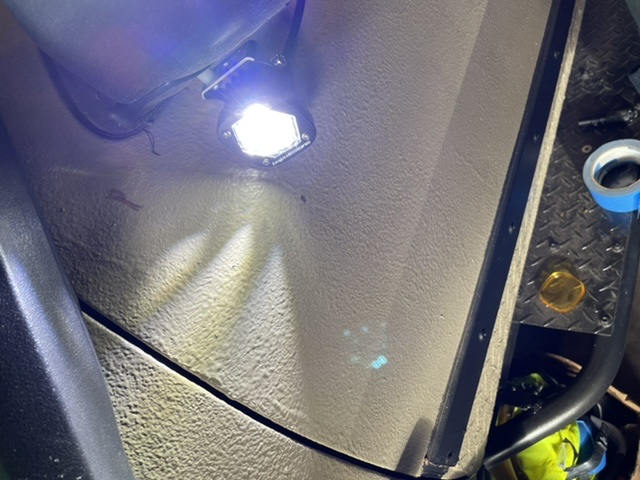

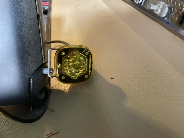

Also found out that Baja Designs now makes Amber light covers for the S1’s I have as mirror mounted ditch lights. Nice use of a Christmas gift card and not a bad deal for $10 per cover to make them dual purpose

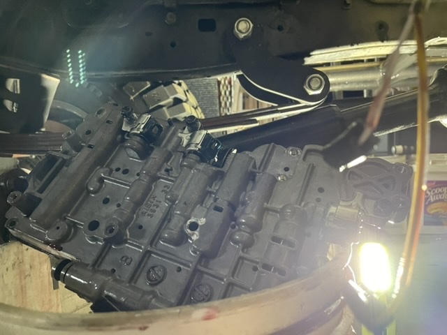

Got a late start to pulling the old valve body out this afternoon.
Things were going great till I got sprayed in the face with a bunch of ATF that was trapped somewhere. Amazing how much fluid gets stuck in these things after letting drain/drip forever.
Needless to say ATF is not my preferred stuff to drink.
Hopefully most of the residual will drip out overnight

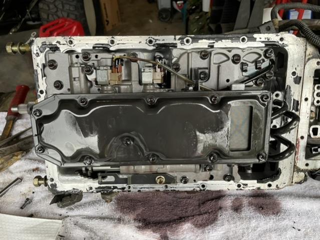

The missus was nice enough to help me to get the donor valve body installed this morning. Was having trouble get it in place, her helping hands kept some springs in place so I could get it mounted.
So the valve body is in place with new solenoids and filter.
I have a munched sensor to figure out where it was mounted.
I will get the pan in place tomorrow and fill it with ATF. Hopefully this thing will have reverse finally.

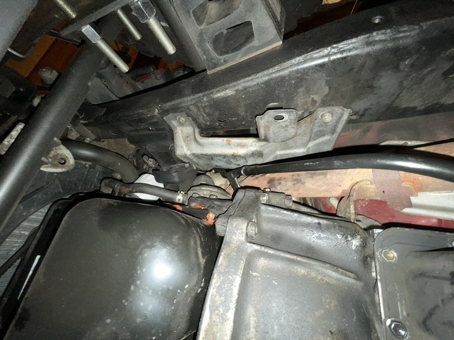

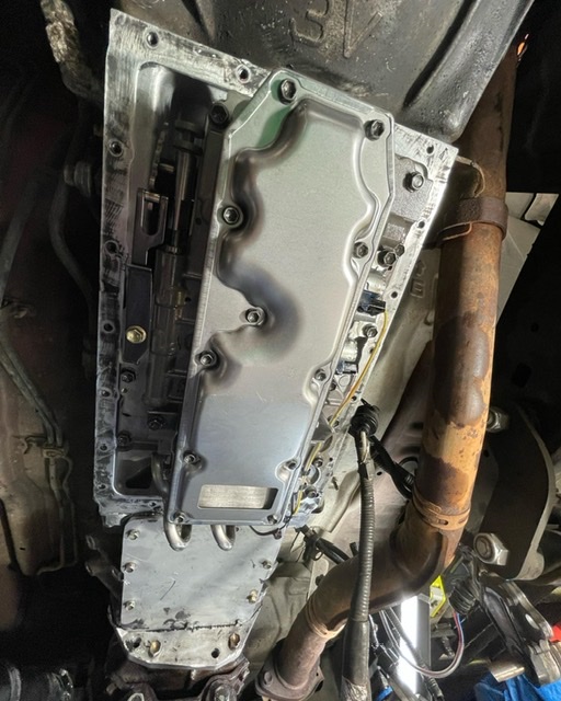

Transmission pan is mounted- high temp RTV needs to cure for a day before I can add ATF
I am not sure how long I fought to get the bolt in for the transmission fill tube brace. What a pain in the butt

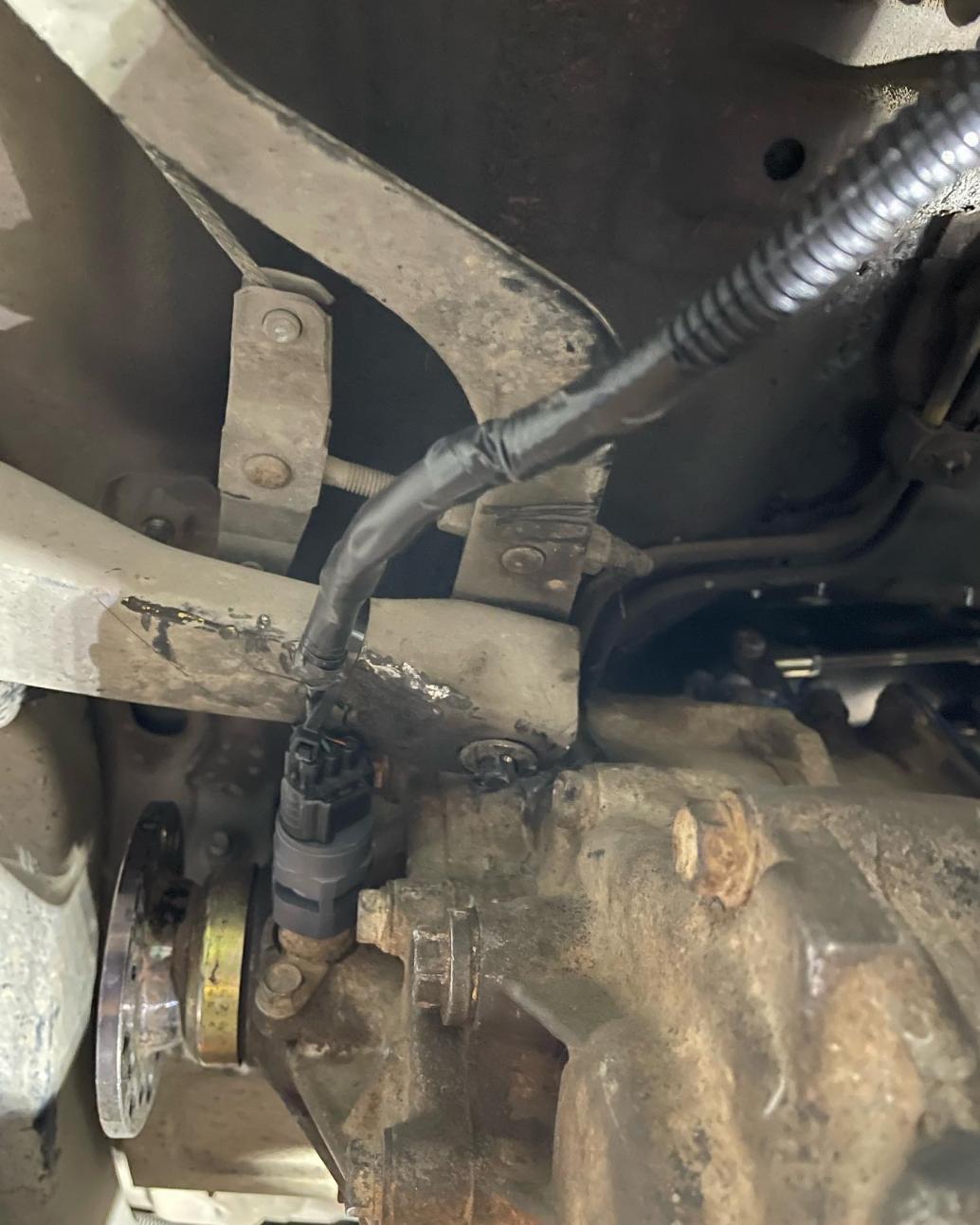

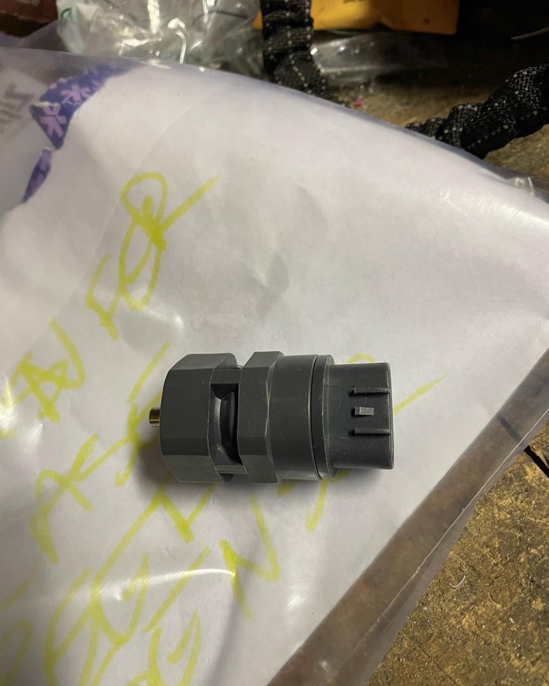

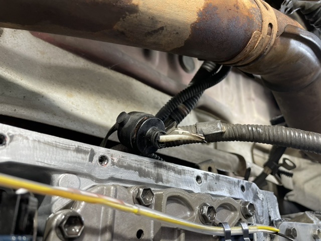

it took me awhile to find the Marlin Crawler electronic to mechanical speedometer adapter I bought 4 years ago when I started ordered parts for this thing
I thought about using the cable extension but figured it would be smart to have the adapter fixed to the rear transfer case
It’s a tight fit with the adapter & plug and the pivot point on the frame for the parking brake. I ended up extending the wiring harness about 24”

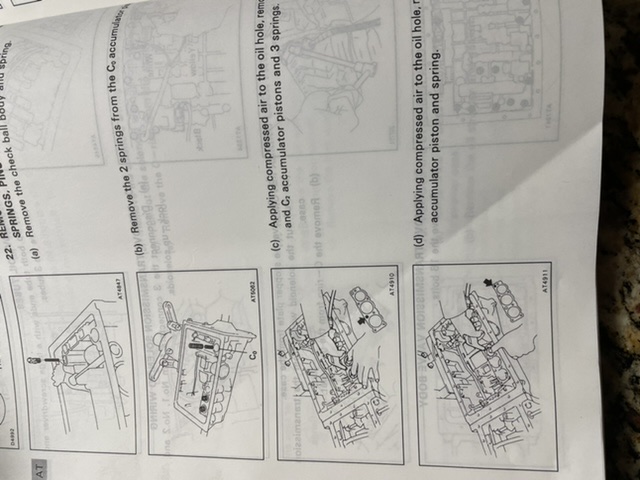

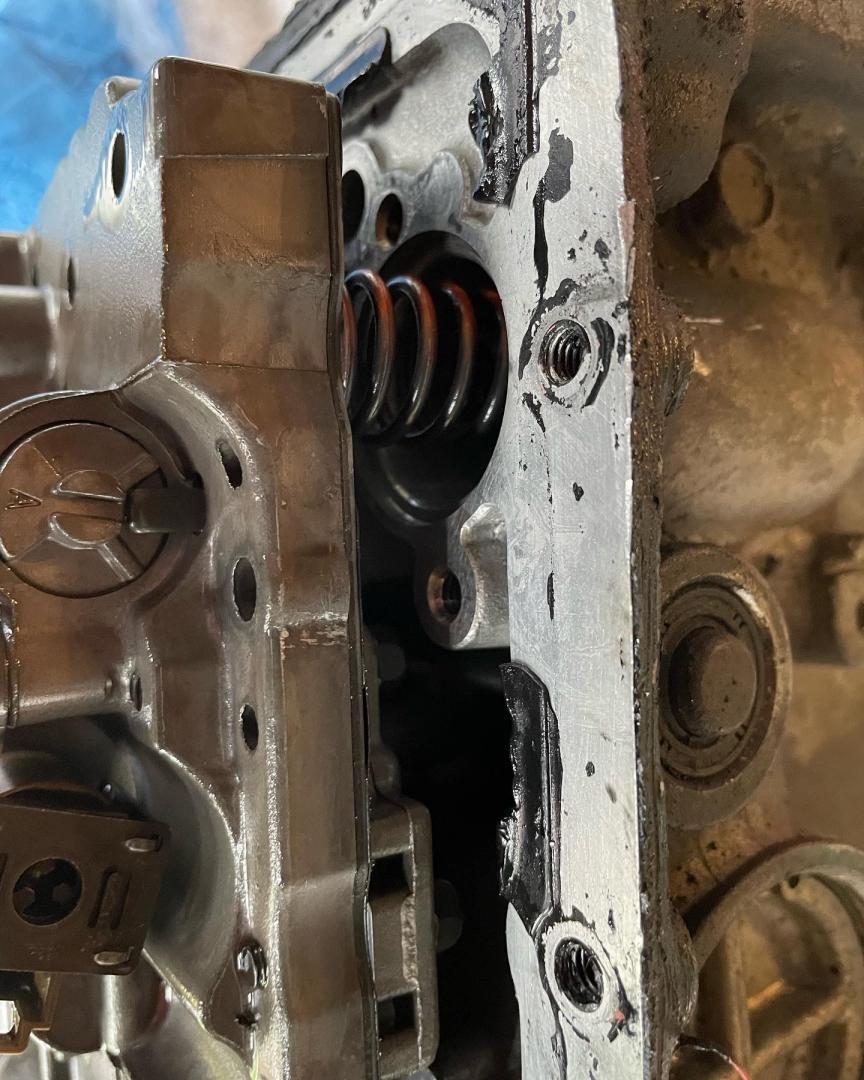

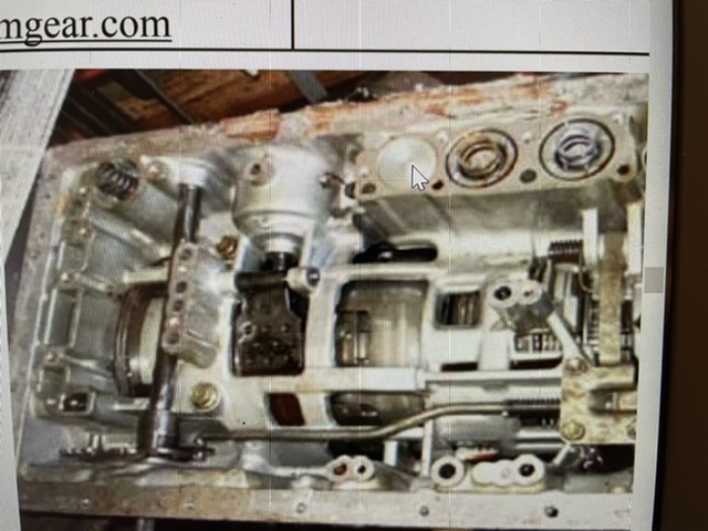

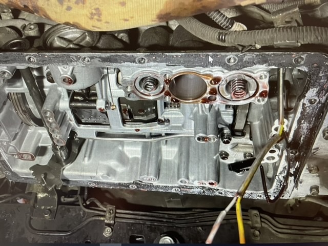

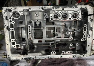

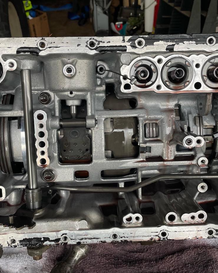

OK so i may have found something - dunno until tear it apart, again but something didn't look right when i was going back over the Inchworm Gear instructions on Low Range Off Road's website
I noticed the forward of the 3 pistons was inverted compared to the other two
when i pulled the valve body from my transmission all 3 pistons were inserted with springs down
all three pistons had springs down on my donor transmission were this same way so i figured it was accurate.
i forgot i had the Factory transmission manual. on page AT-24 is shows what would be the Bo piston being inserted with the springs up
so i go back to work tomorrow, i will pull this thing apart on sunday and see what happens.
I honestly have no clue why both transmissions would have the Bo piston inserted the wrong way
anyway the saga continues

Turning accumulator pistons or leaving the springs out or so is known to firm up shifts or activate manual gearshifts if the valvebody is also moded for it. Do you remember if the tranny shift firm up or down?

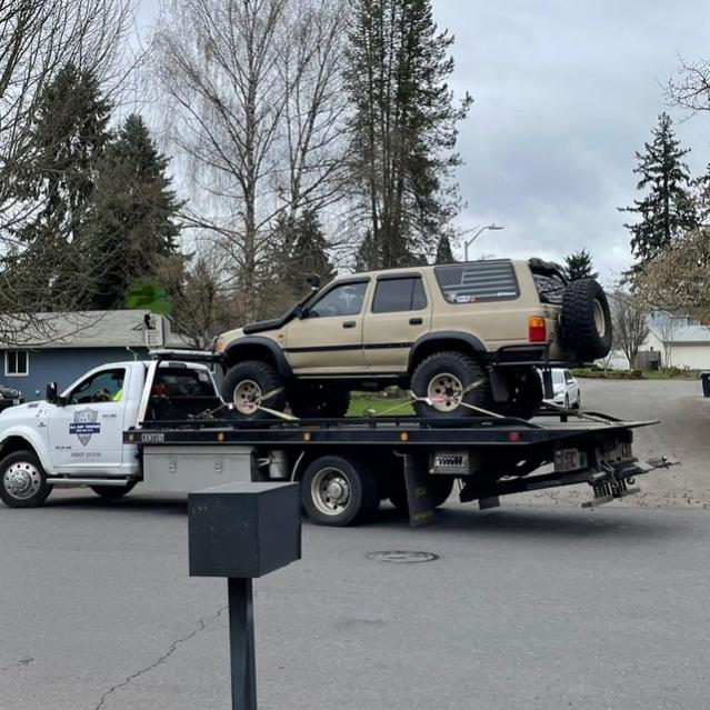

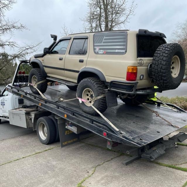

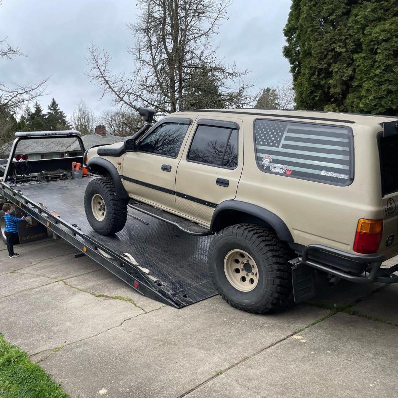

Today was bitter sweet. Had a lot of time and probably too much $$$ but quit keeping track a few years ago.
It was fun but the 4Runner went off to its new home this morning.
It is now sitting in my friends shop next to his 5th Gen 4Runner
