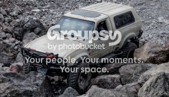

I haven't been really active on this forum since my long term project has been an 81 Toyota Trekker:
The truck is highly capable: 5.29's, dual cases, full caged.
It has been fun for the last 8 years but it is just getting beat to death. Frame is about shot. I am kind of tired of the whole beat the truck in the rocks phase.

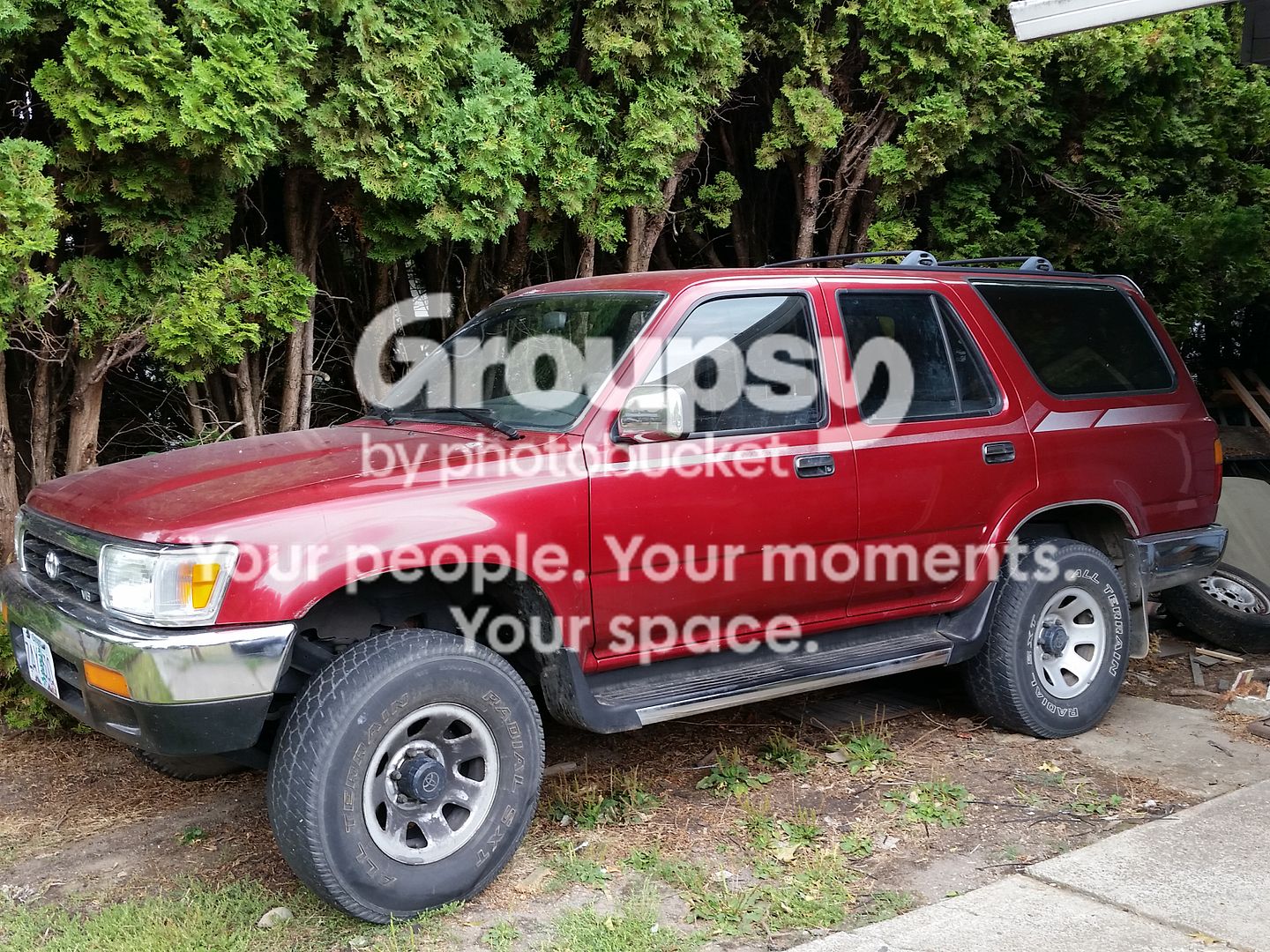

So a few days ago look what the Dodge dragged home
80-20150831_131056_1_8fcf6fbaf4746fb5acb1ace91cca9ac9589f49ec.jpg~original
Picked up my neice's 1994 4runner with 195k on it.
Recent rebuild on the 3.turd so it actually runs decents, dog slow with the Auto.

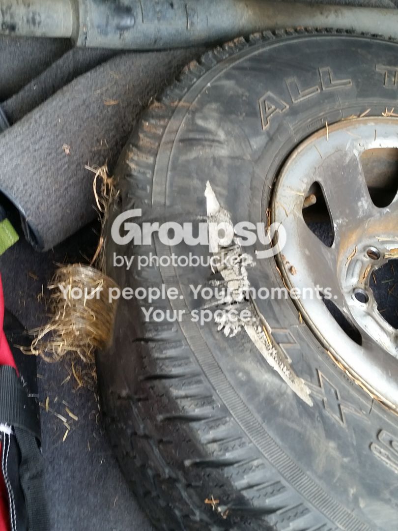

I got it dirt cheap, low 3 digit numbers due to a failed bearing/CV on the right front wheel that lead to this
80-20150831_132716_c872aa77b2e313d0c95692e61881367044dbe4ea.jpg~original
Totally froze on her and freaked her out. Her mom said come get it.
It is kind of dirty but should clean up nicely

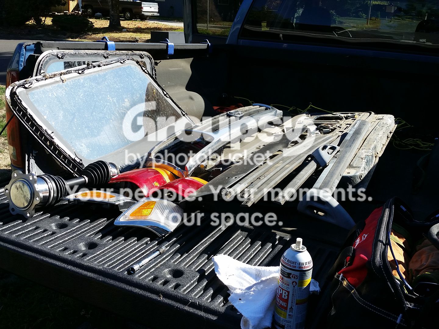

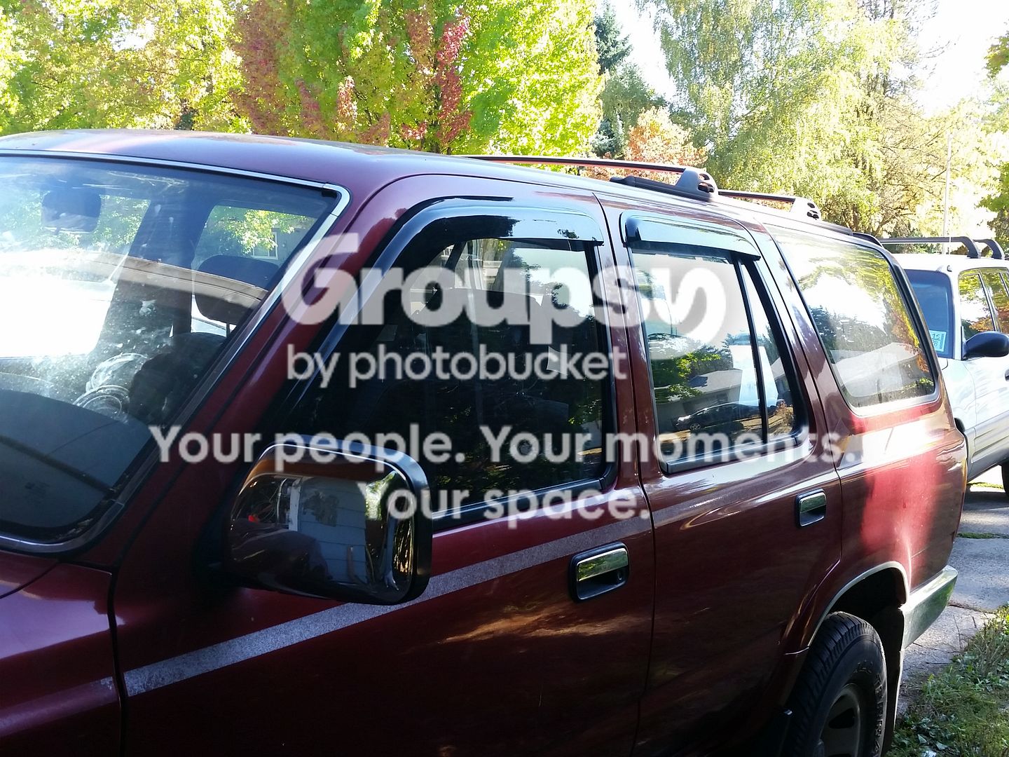

Installed my $5 pick N pull vent visors I scored at the Labor Day sale
And scored a bunch of parts I need now and some for just in case since the price was to good to pass up, most of it compliments of the Great Him, thanks Isaac

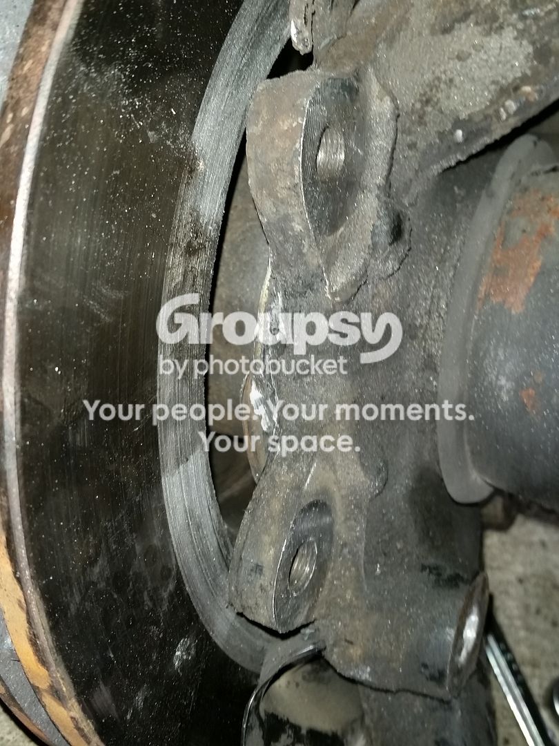

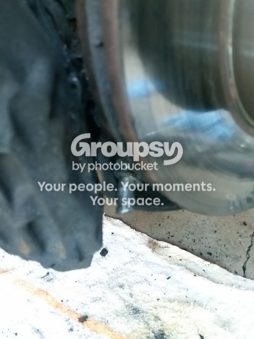

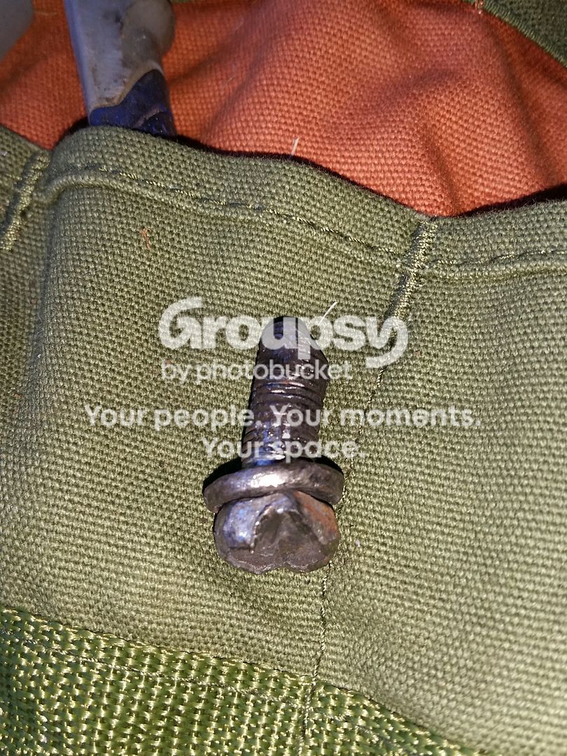

Pretty confident I found the root cause for the right front wheel seizing
When pulling the axle out I found this little gem

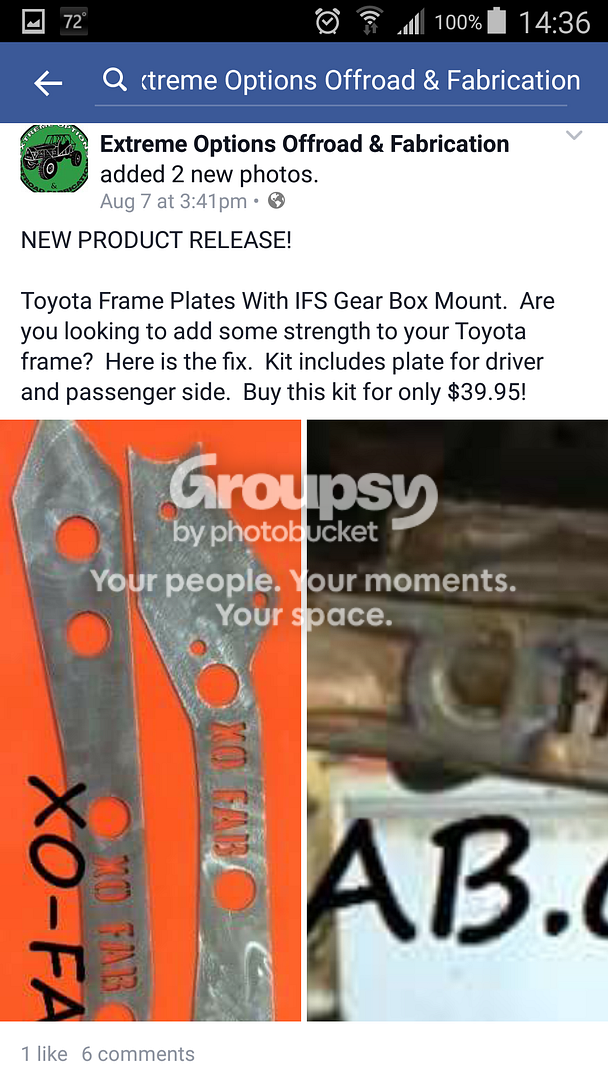

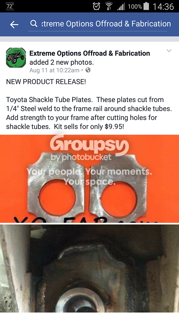

Found some cool front frame plates that I will probably go with from
https://www.facebook.com/Xofab?fref=ts
Extreme Options Offroad & Fabrication 4x4 Enumclaw WA | Fabrication Enumclaw | Welding Services Enumclaw
They have a frame plate with an IFS box mount built in:
priced cheap around $50
80-frame_plate_ddfaf3596a94e9fc1d41a458d553d3e45c33d03b.jpg~original
and a frame support for where the frame is drilled for the rear spring shackle:
80-frame_plate_4147c16f6828544acc72b3ff387763cb0f1fda14.jpg~original

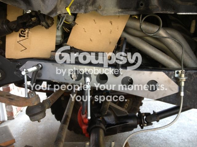

I would recommend using those front frame rail enforcement plates, $39.99 is a great deal too, think I paid $80.
By the time you hang a front bumper and wench off the front end, and with turning big tire related stress,
you are really asking your stock frame to do a lot.

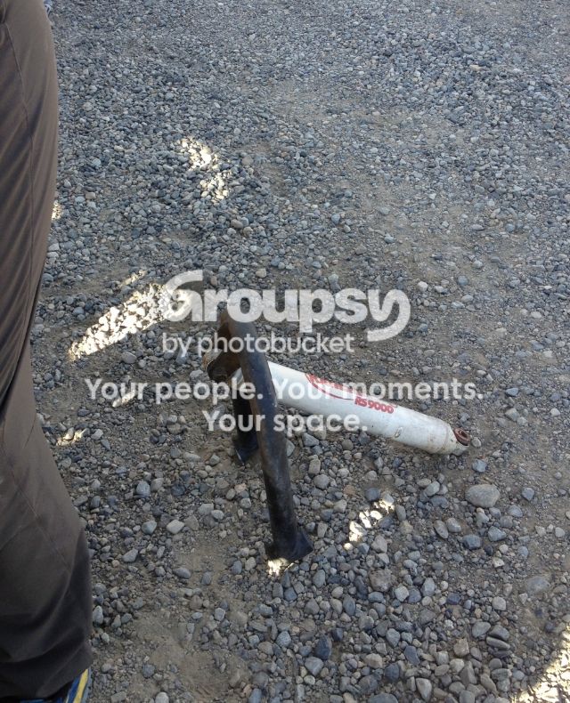

Also , gusset and reinforce the heck out of your front shock hangers if you go hoops, ask me how I found out...
before...

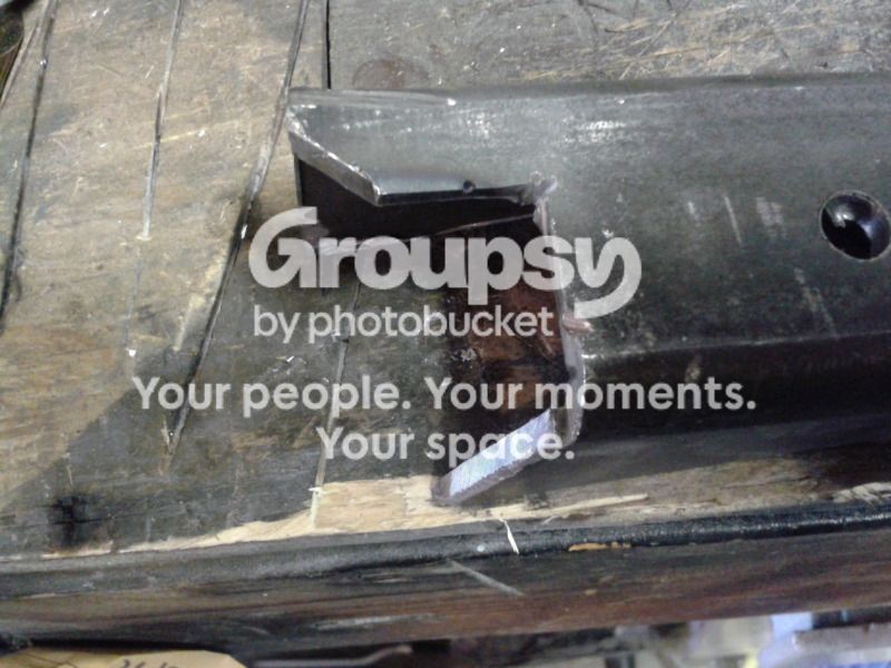

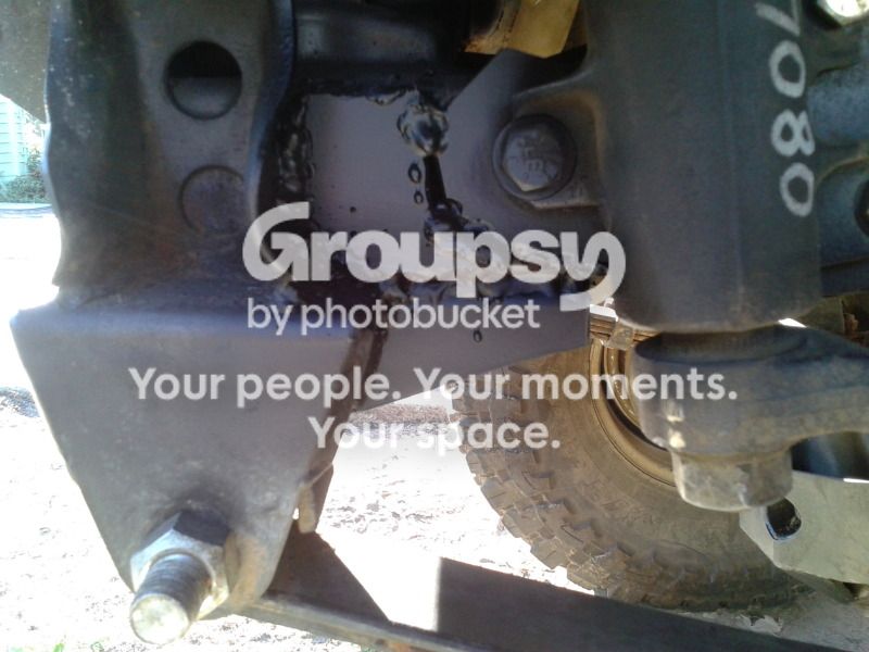

I ran into an issue on my 81 where the frame was slightly cracked due to the front spring hanger placing stress on the end of the frame,

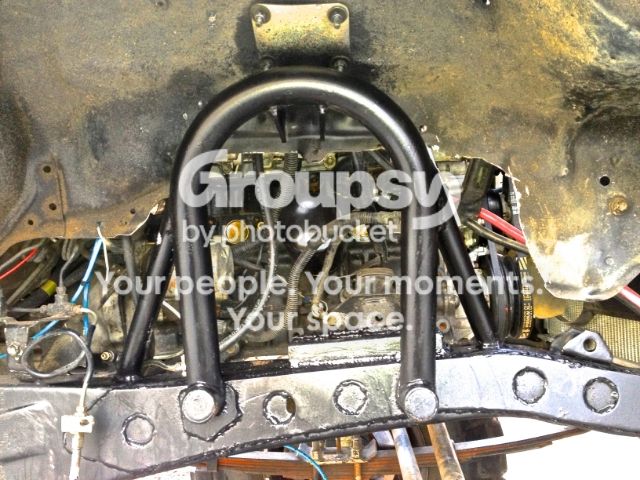

I made some brackets like this
ugly welds, but have held well.
I will add something similar to the 4Runner

I also really like how the Extreme Off Road Options frame plate has the Steering box mount integrated, that should help reduce stress too.

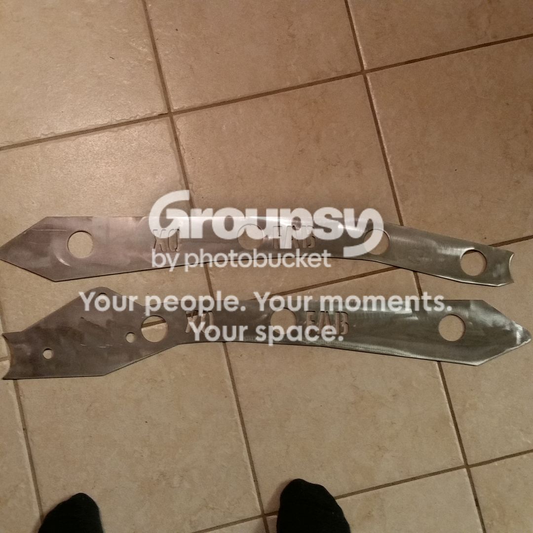

started ordering parts yesterday for the SAS.
Ordered this from Extreme Options Fab Thursday morning, had it Friday afternoon. I will be ordering stuff from them again
the integrated steering box mount is a nice touch
