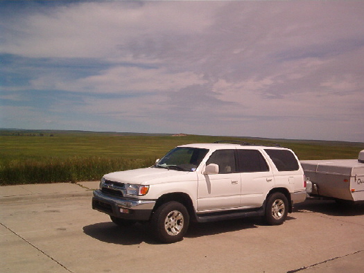

Are you kidding me, what about the chrome bumpers. When was the last time you saw a car with chrome bumpers? I think the last car I had with chrome bumpers was my 1968 VW bug. The third generation does seem to have a interesting mix, ABS brakes, brake assist and drum brakes. Go figure.:confused:
This morning - my Cougar's got them :D
The most important part of your statement was CAR!! and thats exactly what the 4runner is not... remember its truck based, and since reading your statement ive been looking around and most trucks and real suvs have chrome bumpers....
