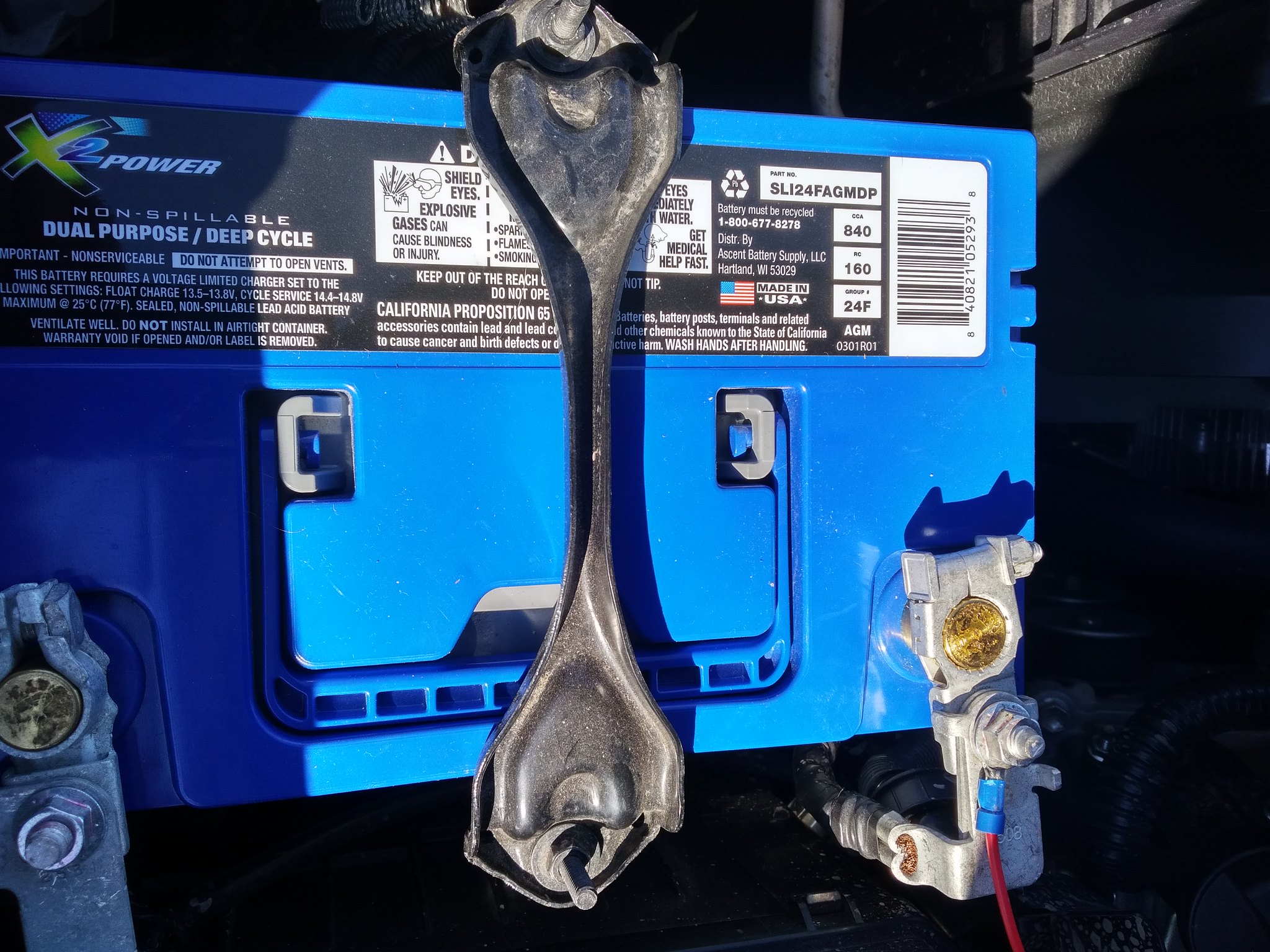

You DO need a dual purpose / deep cell battery, a good one like this.
Pick one up @ batteriesplus
I'm on my 4th year with mine. Cells tested 3 weeks ago and are still good. Been through -0F degree +100F weather, no issues. Plus it sat for a little while too. I run ARB Fridge 24hrs while camping for a few days, Winch, lights, hids, etc.
