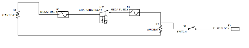

Here is the diagram. I did it quickly so if there is an issue with it feel free to call me on it. Also apologize to any electricians or EE's out there for using resistors to show the batteries, the editor i was using didn't have proper battery symbol.

Your diagram is confusing me, are you showing a common ground then the auxiliary battery is ALWAYS connected to the vehicle and the main battery is activated by a switch or ignition power? A switch appears to be on the positive side of the aux battery, what is that for? And if you switch the relay using the main battery, how does that work if it's disconnected until the relay is activated?

I agree it is expensive lol that just means you need to get creative. Like I said before I sourced all my stuff from places that were at least half of retail. I will get ya a list up here tomorrow hopefully. I think I paid like $64 for my ACR, CDS or what ever we want to call it :cheers: I just had to search and search and search some more lol. And it has start isolation built in which I really liked, plus low voltage isolation for either side. It is pretty neat lol.

Now that I look at this diagram again it sucks.... lol like I said I did it in less than 2 minutes over lunch :redbrick: I will give it another shot tomorrow haha yeah what you described was not at all what I was going for or how it is :shocked:
I did this on digi key's web site. They have this neat online app for it.
