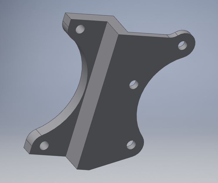

Haven't made a bracket yet. I think it will need a large step in it so a welded bracket might be the cheapest vs billet. This is the latest drawing I had on my PC.

Any update on this? I would for sure be interested in a group buy to eliminate the factory junk. I hate having a shitty e-brake, just bugs me.
Seeing that you have modeling software I'm assuming you have machining capabilities as well? If not I work at a machine shop and could get that bracket made up very easily. Plenty of "government" work going on in the shop, especially right now lmao.

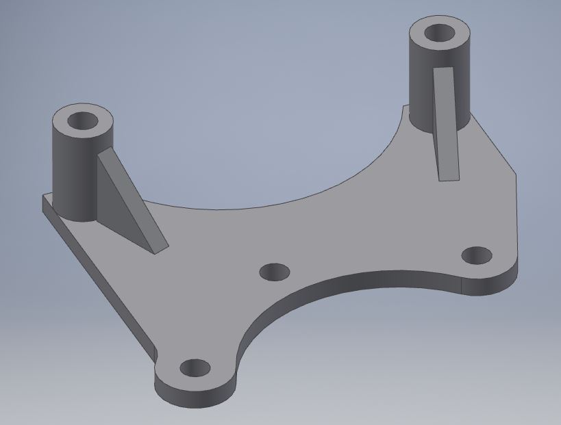

Actually, this is the latest drawing on my PC. I think I decided not to machine it from a 1.5" thick piece of steel and instead do a weldment with standoffs. At least for prototyping, it'll be cheaper.

At my old job the engineers (me) could use the two bridgeports with digital readouts whenever they wanted, even for personal projects. My new job it would need to be CNC'd, and I doubt they would touch it. But my brother and I have had stuff made at another fab shop before.
What would be handy would be a 3d printer...
