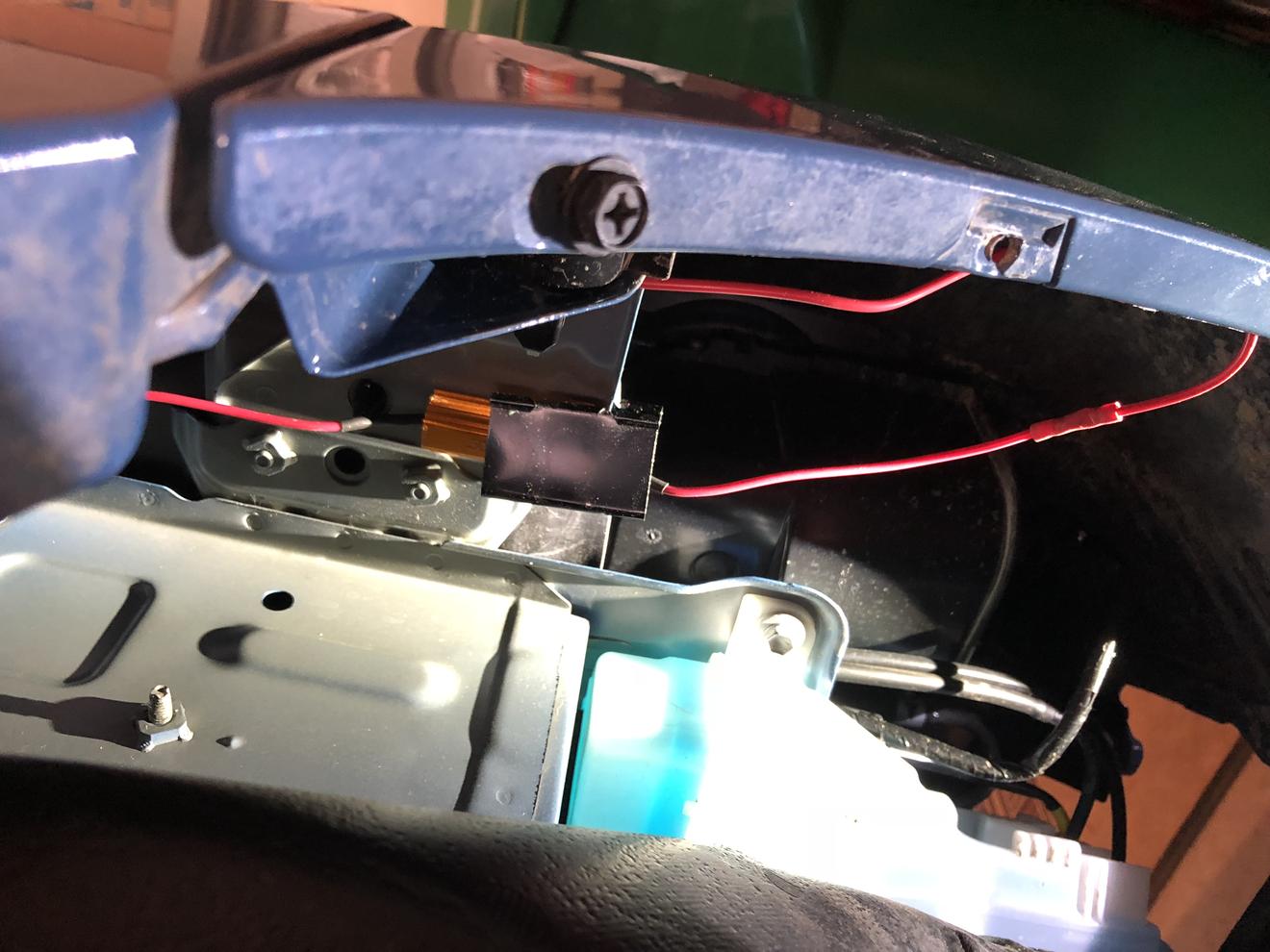

I used Alla lighting from amazon. Switch back 7443 bulbs. It was $26.99 plus $5.39 for pair of resistors. They have all orange bulbs for much cheaper. I installed resistors using big binder clips because I didn’t want to drill in to my inner fender. Clips hold tight and secure. Cleaned up rest of my wires with zip ties not touching any part of the resistors since they get very hot under use.

....... I installed resistors using big binder clips because I didn’t want to drill in to my inner fender. Clips hold tight and secure. Cleaned up rest of my wires with zip ties not touching any part of the resistors since they get very hot under use.
Thats a very smart idea....:cheers:
