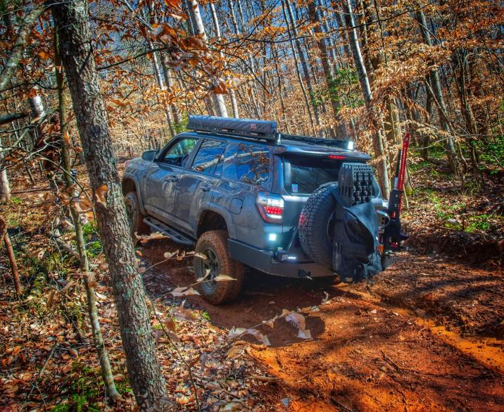

LFD Off-Road should be on your list as well
LFD Dual Swing Rear Bumper
It works with the Gobi ladder, is ridiculously stout, and easily carries the hi-lift, fuel/water containers of your choice, a table, etc,
Additionally, for your weight savings, you can pop either of the swing arms (or both) off and run it as just a bare bumper. It literally takes minutes to pop either of the arms off.

For what it's worth, mine carries the tire, hi-lift, and jerry can holder (no jerry cans) on a daily basis. It also has my WeBoost antenna, rear camera relocation, and a set of 4 tri colored LED lights (Brake/Turn, Dust, Reverse) that shine through the LFD logos in each swing arm.
The ride height changed slightly (I had Dobinsons C59-327 springs before the bumper, I've since upped that to 329s) but I don't think the driving characteristics change that significantly with the additional weight.
