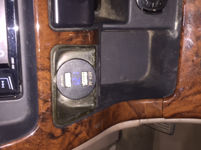

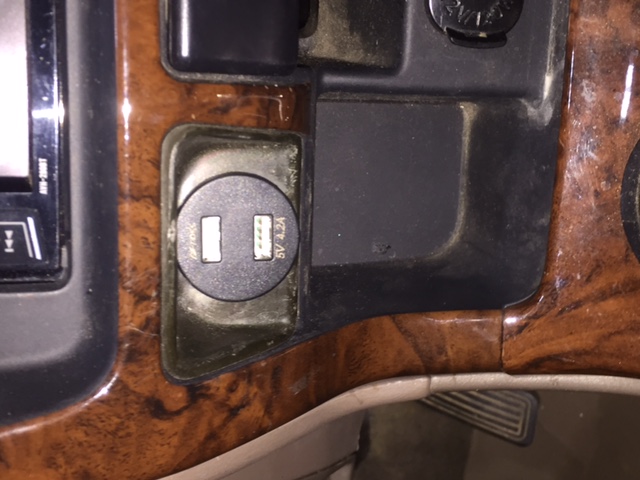

I just did this mod. And the dual USB charger has a battery gauge.
I did NOT have to wire a switch to turn it off and on. When I turn the car off it no longer has power to it.
I did NOT have to widen the hole that the cigarette lighter was in. It was a tight fit getting it in, but this allowed me to secure the outlet so it does not budge once I put the locking nut behind it.
Here is the link to what I bought:
https://www.amazon.com/gp/aw/d/B01FVQTWBK/ref=yo_ii_img?ie=UTF8&psc=1
