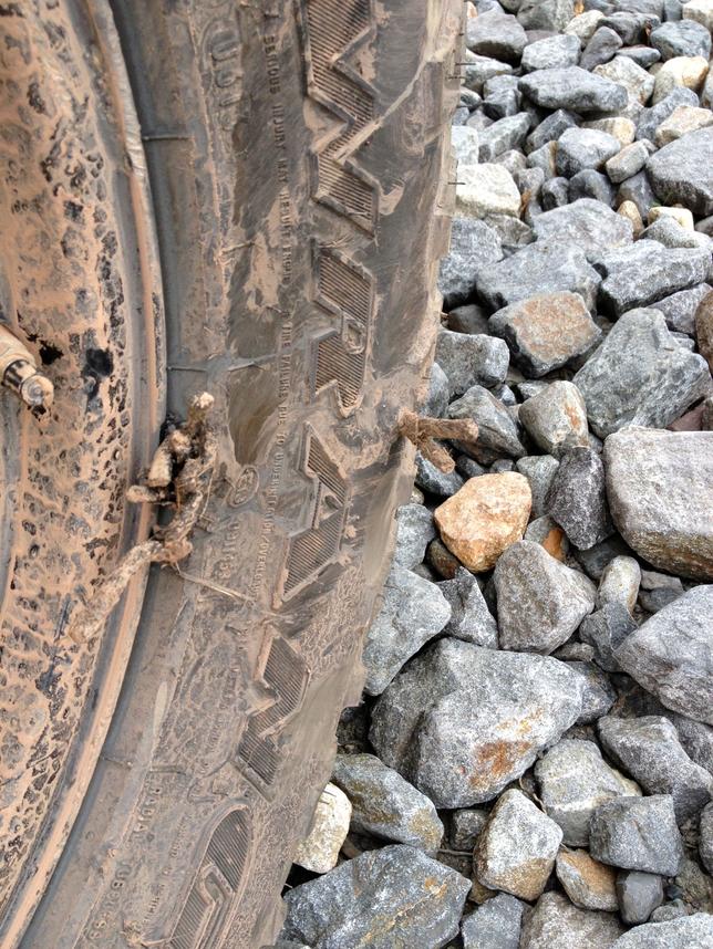

This was the beginning of day 2 of 3 straight days of wheeling. Punctured the side wall in two places. Plugged the punctures with 6 plugs and wheeled on it the rest of day 2 and all of day 3. The side walls are definitely thin. I really like these tires and am on my second set. Just wish the side walls were much thicker.

Um...is that a stick through the sidewall? I friggin stick?! Haha. I just got Duratracs, and love them. Noticeable hum, but not nearly as bad as MT's but little noisier than AT's.

Um, no, that's one of the PLUGS he mentioned. If you're NOT carrying plugs in your off-road box, WE will be the folks laughing at you when you get a flat and wish that you did have them.

Having it cut that close to the rim... I'm guessing the rim took at least some cosmetic damage also.
Looks like you were wheeling it pretty hard, or perhaps the wider track got your wheel where you were not expecting it...
I've been pretty happy with my duratracks and the abuse they have taken, but I'm now running MTRs (for those harder core side wall ripping situations...) Still have the duratracks for daily driving and moderate trail use.

Actually, that rim was fine. I do have a deep dent/gouge on the lip of the driver side front wheel that if it went any deeper, the rim would have been useless by not holding air. The cuts were from a rock in a deeper muddier section that we couldn't see. Jared [MENTION=79132]Nyc-Runner[/MENTION] was behind me and had the same thing happen to his tire as well. We were running Blues and Blacks for 3 straight days. So yeah, you could say we were doing some serious wheeling lol. An awesome time for sure.
