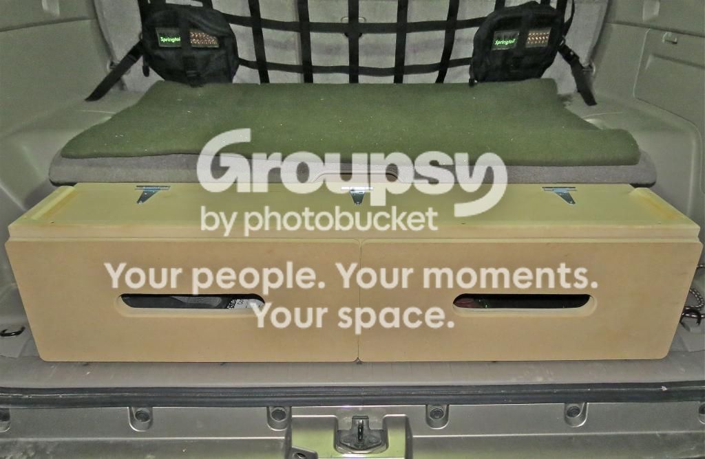

I'm happy to take extra pics of the cargo net, just let me know what you're looking for. I already have a couple rear view pics in my build thread cause someone else was asking if it created blind spots. I can get a couple attachment pics over the next few days if that helps. Just let me know what you're looking for.
Mostly looking at how you secured the net, it looks pretty solid. My concern is that it's not as sturdy as it appears, I never really stressed the handles out but I am not sure they are that loadbearing. They're anchored into the roof with plastic expansion anchors if I remember right, only reason I bring it up is because I figure you're using the net to arrest cargo in the event of a sudden stop and/or accident.
The net is secured to the handles. Which are not load bearing. However, in my opinion, it is very secure and I'm not worried about it failing in a worst case scenario.
Keep in mind that the net is fluid, not rigid like the metal grates. So, if something does hit it, it will give a little and catch the object instead of just rejecting it like a ball hitting a wall if that makes sense.
I actually got the net because we have an infant in a rear facing car seat and the fire department recommended getting a barrier or tying everything done that goes in and out of the cargo area. Anyone that has young kids knows that time is a premium and it isn't always practical to take the time to tie everything down. So, I figured the barrier was the way to go. I hope we never have to put it to the test, but for the price I figured we were better safe than sorry

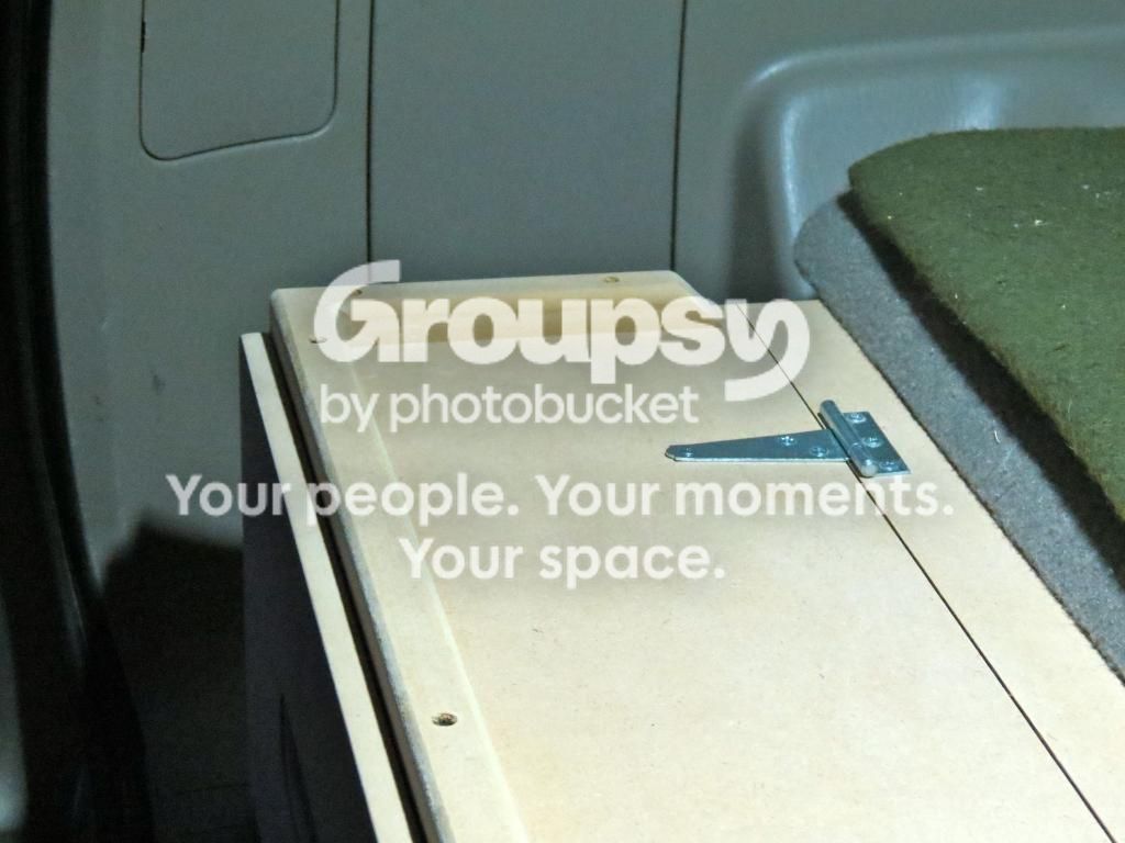

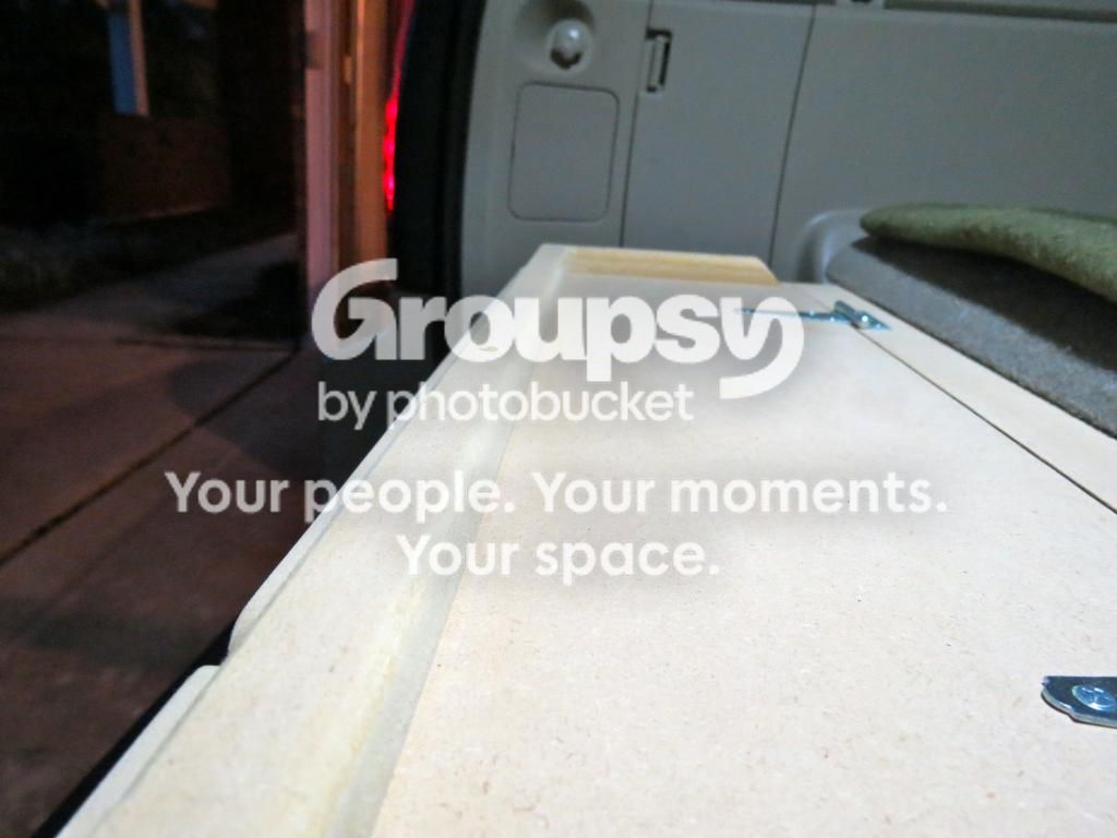

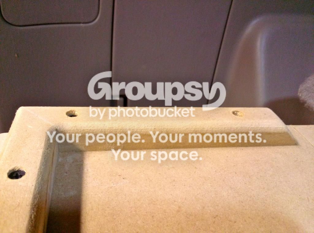

Did a little more work on the drawers today. My old box had a ledge around the edge of the lid which came in really hand keeping things (especially 12 pks) in place between the store and home. So, I added one to this box as well. The pics aren't the best because thy were taken at night, but you get the general idea thanks to my PFran LED swap.

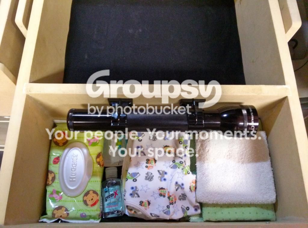

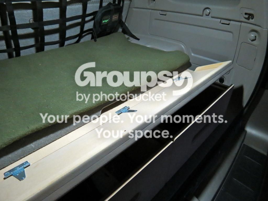

Got a couple better pics of the rail system as well as mounted the maglight today and installed some survival gear

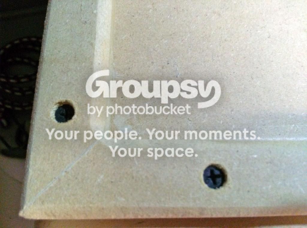

Corner joint
Maglight
Survival Gear
