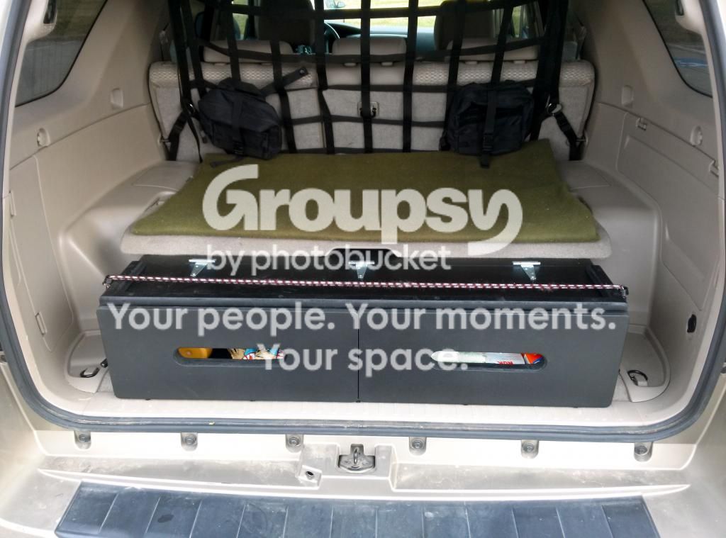

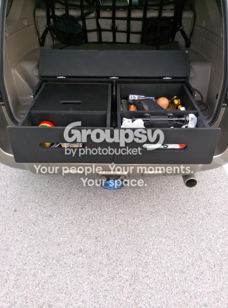

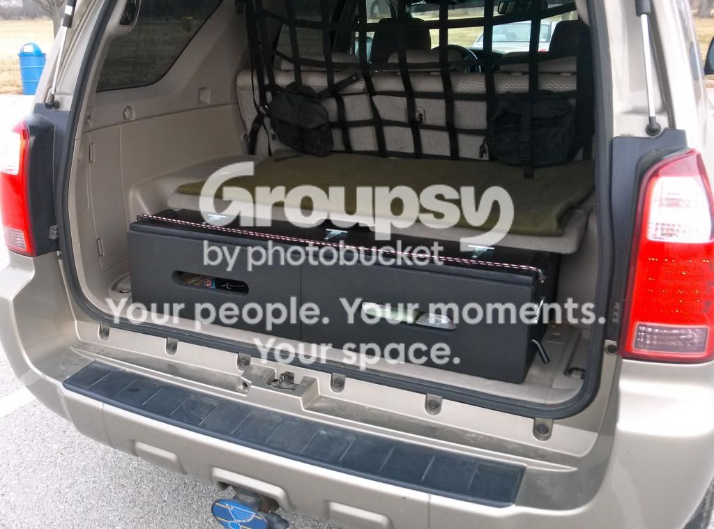

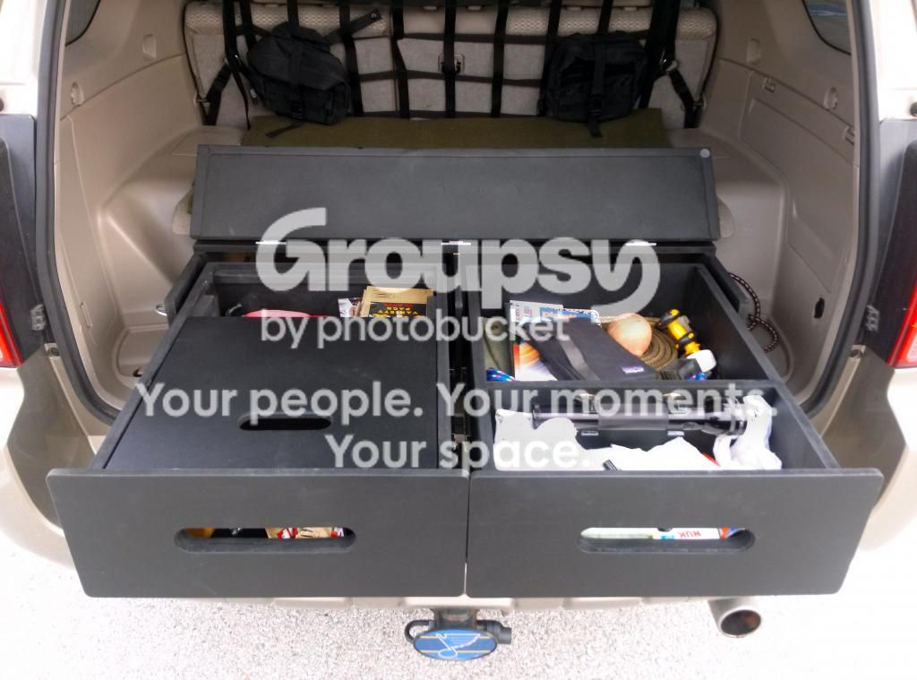

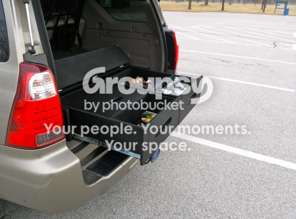

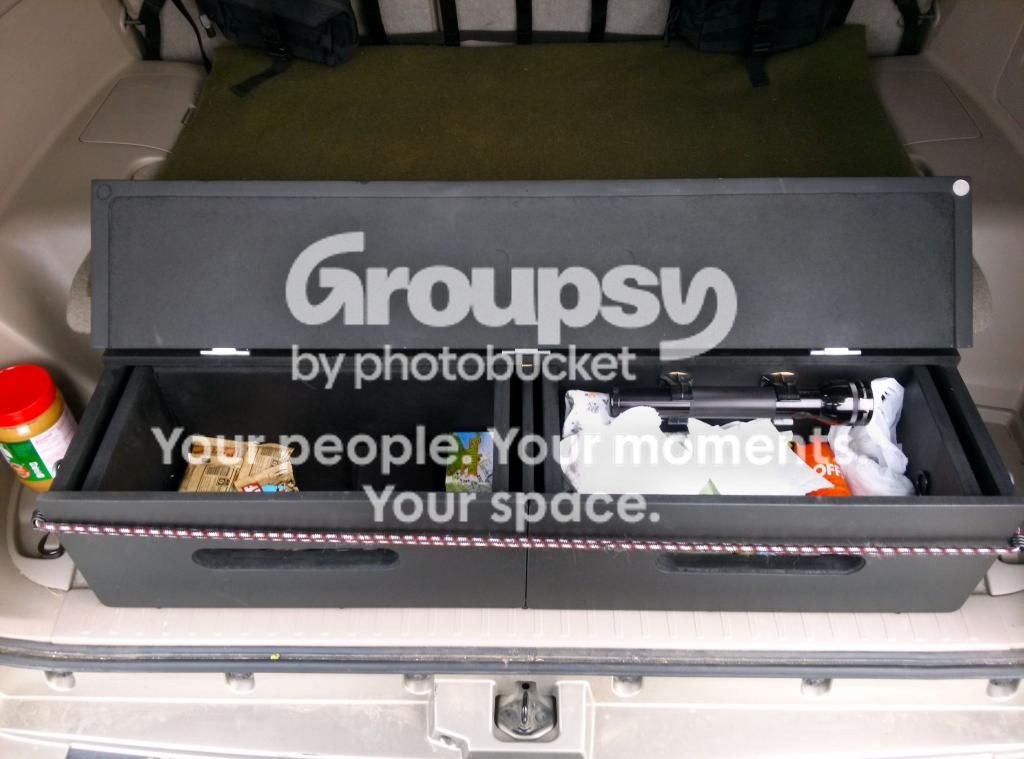

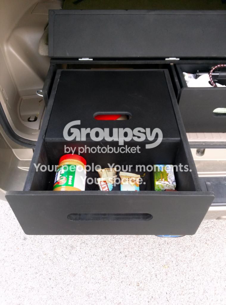

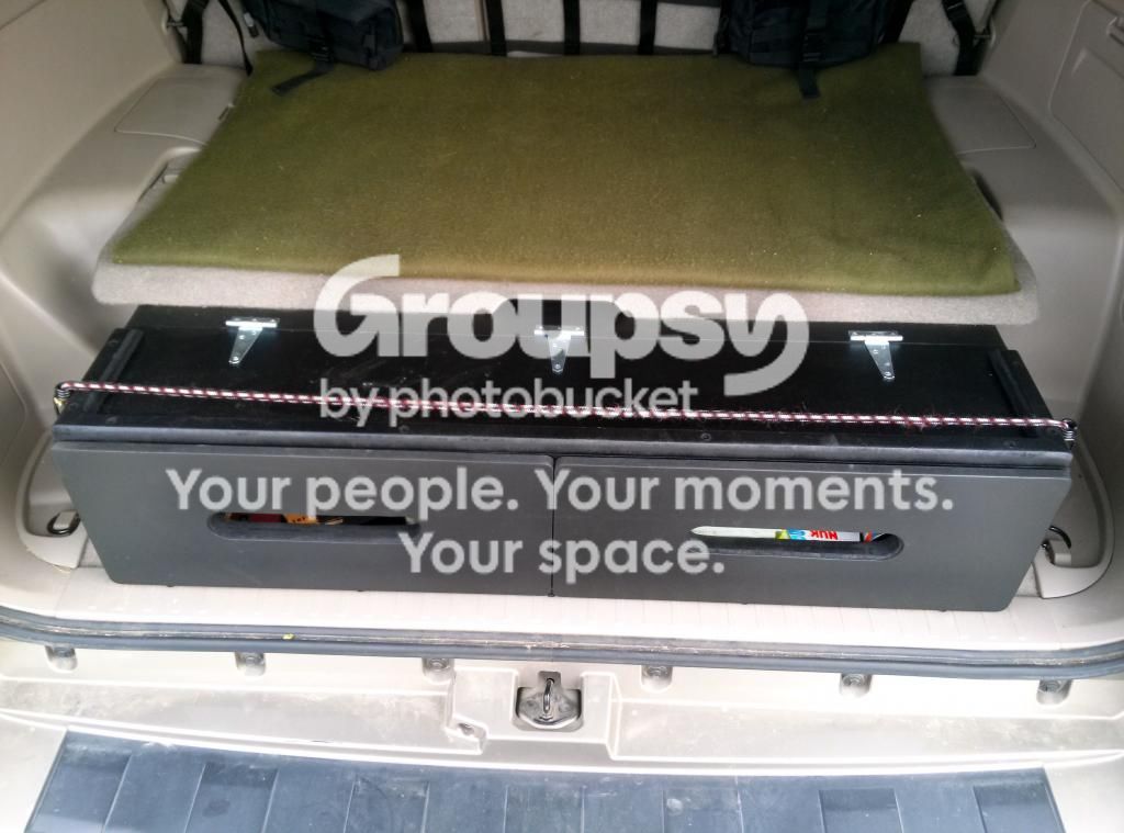

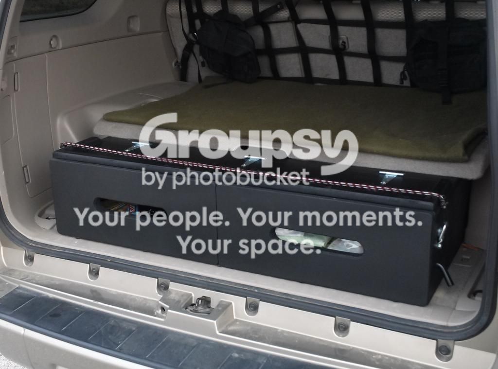

Ok, without further adieu, here are the pictures of the "finished" product. I chose to use flat rattle can black on most of the areas but chose to over-coat the front of the drawers, flip up lid and sliding lid with the spray-on bed liner. I think it turned out really well. One note, I had some black semi-gloss spray paint left over from another project, which I also tried, and it looked like crap, so I painted over that with the flat black.
Here are the pictures...
As you can see, I've already been putting this thing to work and getting it dirty. Luckily, the spray-on bed liner created a harder coating and any dirt just wipes right off with a wet cloth. You'll also notice that I lost one of the little rubber feet for the flip up lid. I guess the sticky back didn't adhere too well to the painted MDF, so I put a dab of hot glue in there and pressed the pad in there. I think its pretty secure now, and not going anywhere.
Thanks for looking, let me know if you have any questions,
Jeff

The spray-on bed liner is available at any hardware store. I bought the can I used at Home Depot for around $8/can. That said, the application is textured, so you may be able to lay a few coats of that down, then cover it with your desired color, but don't quote me on that
Well, after looking at this thing painted for a couple weeks, I love the way it came out. At first, I was concerned that spray paint & bed liner wouldn't do it justice, but I really like the way it ended up looking. Every time I open the hatch, it brings a little smile to my face
