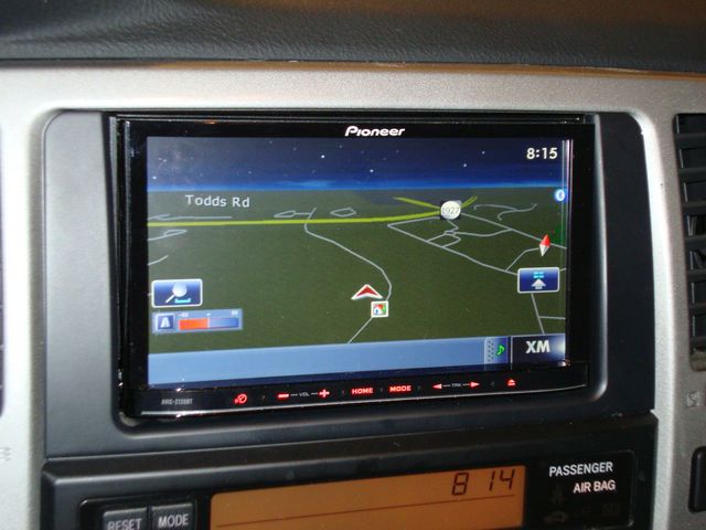

This is my Pioneer H/U with the Urban Runner trim ring.
The full frame kit, listed to fit the limited, did not fit mine at all. It is too wide for the dash opening. I had to use the one with just the side peices. My buddies sport with jbl used the full frame kit. I had thought that models equippped with the oem cd changer had the wider dash, but another member here without jbl or the changer had to use the wider kit. I have no clue, I would like measurements of thr ur trim ring, that's the only way to know which kit it equates to.
Its definitely the center dash piece and probably the radio bracket that make the difference. I sure hate the way the two "ears" from the 95-8202 kit look on mine.
The 8210 will take care of that, or the equivalent full frame kit from other manufacturers.
It would..but it doesn't fit. I bought one today. What I need now is an '03-'07 limited (with RDS) center dash insert :)
I like the way the 8210 looks better than the Urban Runner surround.
