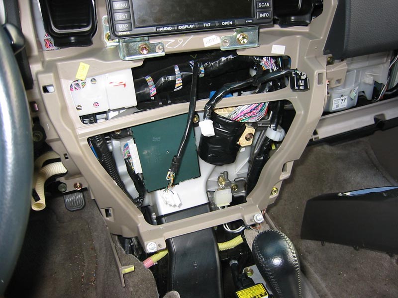

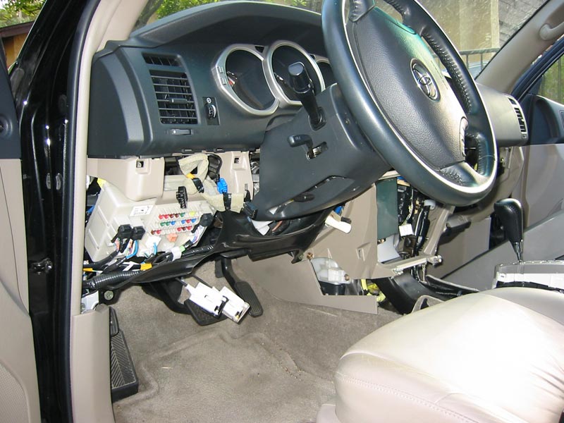

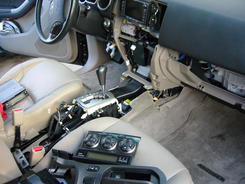

Took apart the dash, here's my findings:
The ac ducts for the back seats do indeed run behind the bin. The ABS compter sits on top of the ducts taking up more space. There's simply no room to mount anything horizontally.

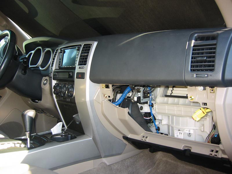

Behind the "inner" glove box is the ac vent. There's a little bit of room to mount something here. I was hoping to mount the dvd player completely inside the inner glove box. Once again, not enough room.

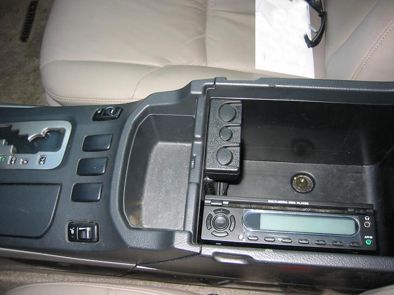

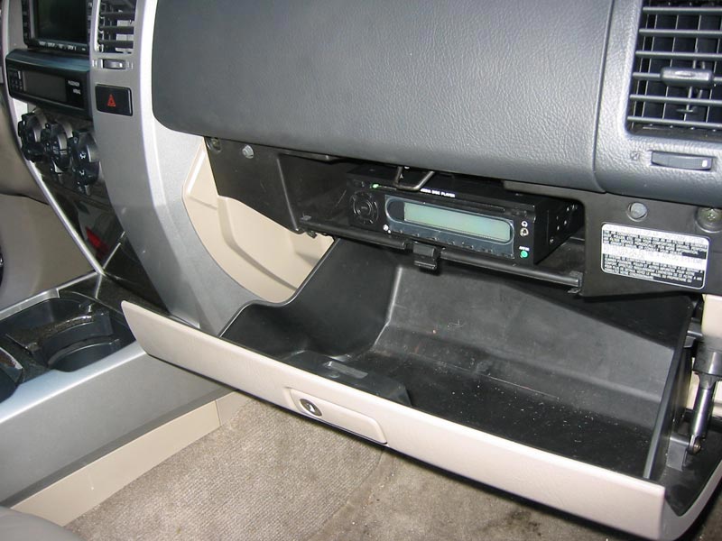

Looks like I'm down to two options:
mount the dvd further outside of in the inner glove box,
Wow your right there is really no room to mount that. I would think wither place looks good but how well will the DVD function mounted in the console upright? I myself like the glovebox mount
I'm definitely going with the console mount it this point. I have a video ipod and the dvd plaver has an A/V line in right in front. I'll be able connect it easier than if it were in the glove box. If I didn't have the ipod, I'd go with the glove box for sure. I'm definitly glad I got a slot loading model, which will work perfect vertically. Plus, the unit came with a remote sensor for the remote control. I'll run that under the console and hide the sensor in one of the vents next to the nav. This way, me or anyone else in the car can use the remote by just pointing towards the dash.
