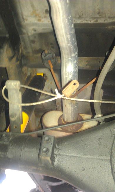

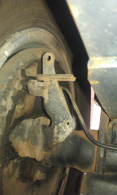

Mine is disconnected, the cable is zip tied over on itself on the drivers side of the rear axle. I dont know where, or how it goes or works but I imagine its a pretty simple mechanism. I would really like having the parking/e-brake....... fla is mostly flat but my driveway has a nice lil tilt to it. Luckily the garage is on flat ground :-D. Either way, who know what about something with this mechanism.
Snap a pic of your setup, and we can tell you what your missing.
Ill try to get a pic of mine so you can compare.
had to kinda take the pics 'looking up' so i could get the flash to work, otherwise mo fuggin FLA sun is tooooooo bright, I LOVE IT!
So, any advice on my ebrake situation would be appreciated.
Thanks
ray

The U shaped piece in the first pic connects to the top of the backwards L shaped piece in the second pic. Line up the 3 holes and slip a bolt thru. Put a locknut on it, not a regular nut, as you don't tighten it down all the way, it needs to pivot.
Could be some part of the system is inoperative. The L part can sieze up, the cable to the front could be broken, etc.When you hook both sides up see what happens.
