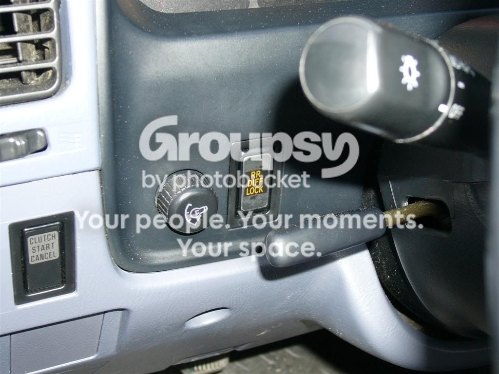

is it suppossed to be like two H's with an x in the middle, or does it say rear lock
i have found a pic... is this it
well i know its the pic of the interior, but there is a button next to the dimming control. Sorry if i was not specific. :biggrin2:
however i called the dealer and was told if you look at it, it looks like an H with a cross.:dammit:
i cannot tell from the pics very well, but thanks for that picture that was posted. now i really know what to look for. :hungry:

Rear locker was available from 1996-2000, and the center "lock" was on 2001 and 2002 models.

OP if it is two H's with an X that is the Center Lock button if it has the factory E-locker then the button has RR Diff. E-locker is not available on 01-02 models.
