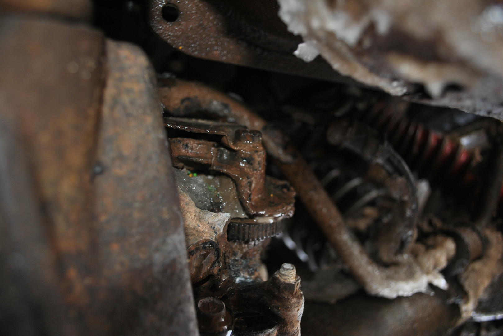

When the button is pushed the lamp flashes on the dash, When I bought the truck and had the local garage do some work on it they said the e-locker was toast. I have looked at it and the whole thing is very rusted. There is a gear wheel exposed that I think should be covered !

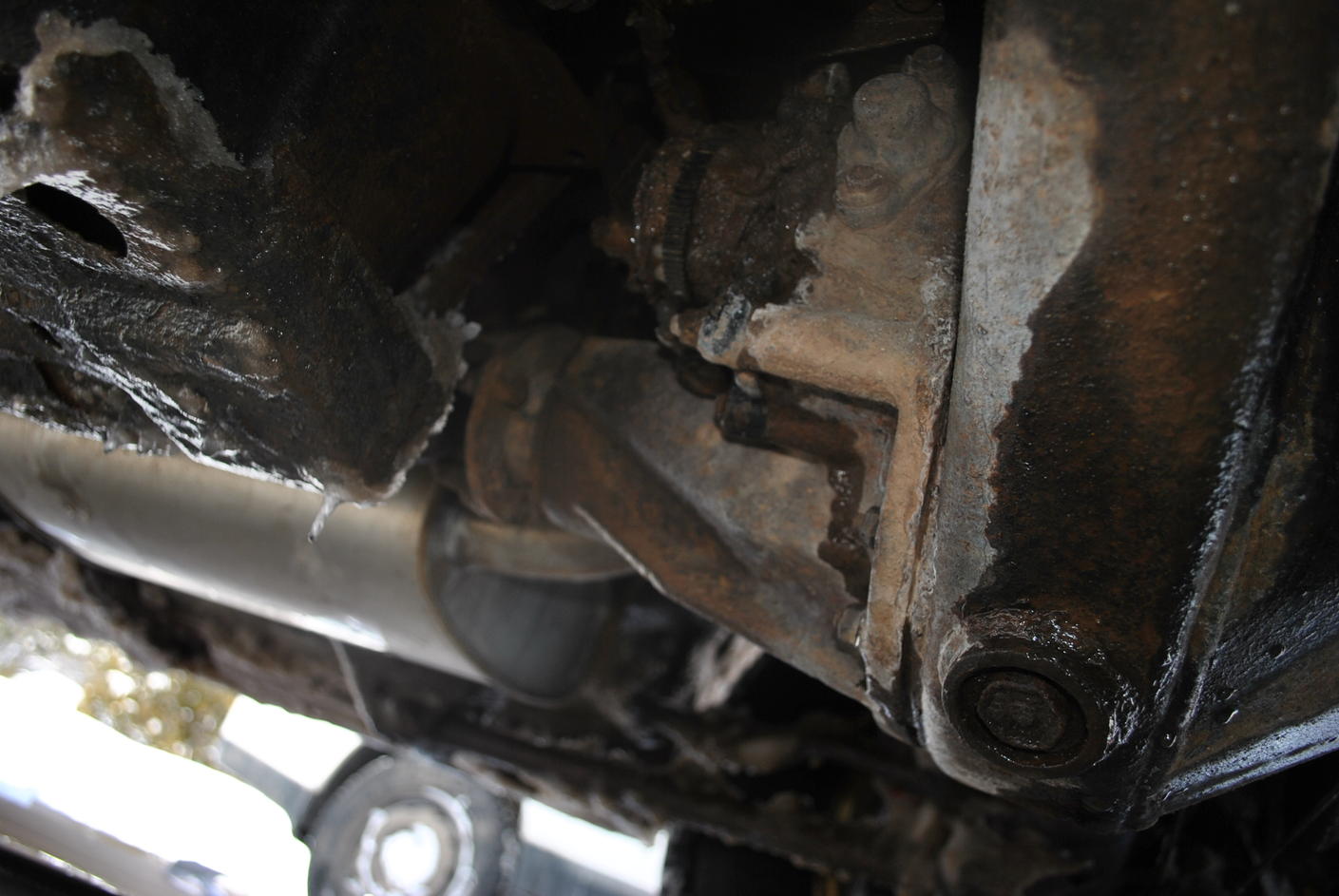

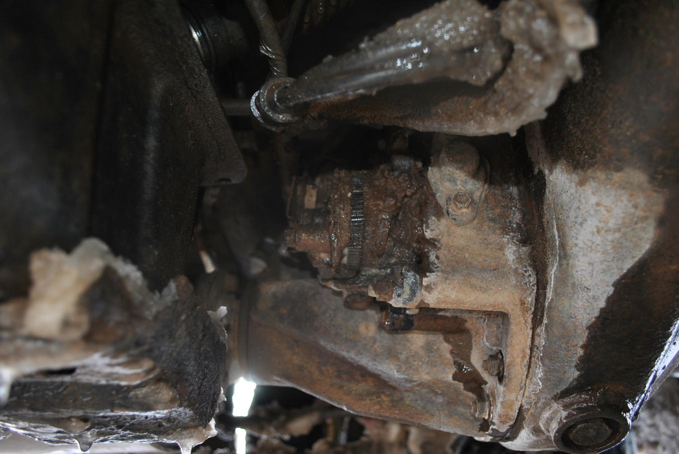

This is what I am looking at. It's wet with snow and road salt deposits on it too. You are not seeing any oil leaks !

Holy crap, your acutator cover cracked & fell off! That gear shouldn't be exposed!
