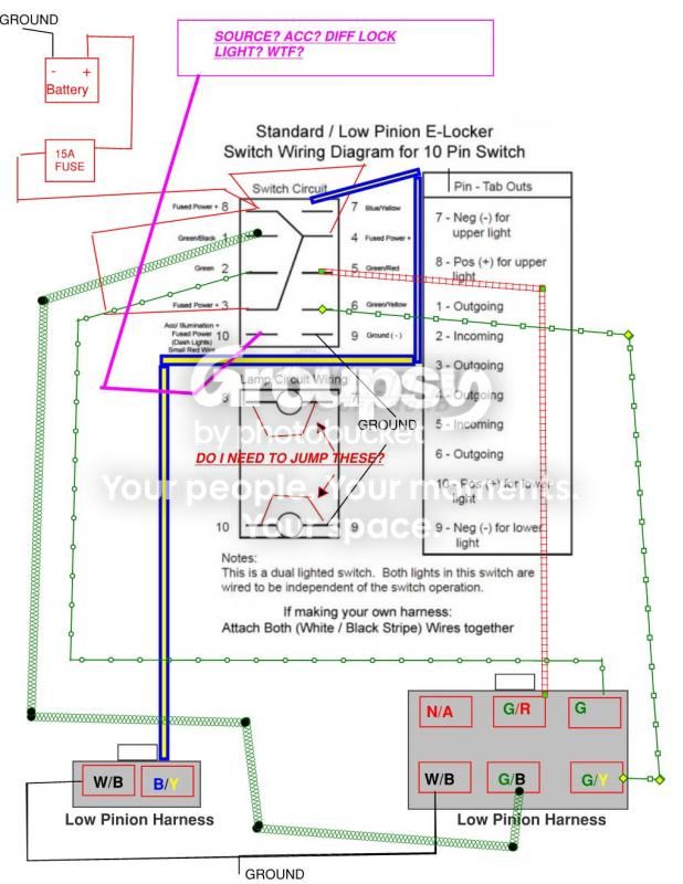

I have searched the interweb and have found nothing. I recently purchased a lowrange offroad e-locker switch for my e-locker retrofit. (Might as well turn it on right?) My intent is to install a stand alon harness as I do not want the factory ECU to be involved here, I have looked everywhere and cannot find a diagram, so I drew one. I have three questions.
1. Where should the number 10 power come from? the key switch?
2. Does the switch make the jump internally 8-7 and 10-9 or do I need to put in physical wire jumpers to make this connection work?
3. I just don't ****ing get the 2 prong harness on the bottom left. It appears to me the positive Blue/Yellow is wiring to the positive. Or am I completing the positive loop to the motor?

OK, near as I can tell, it looks clumsy, this is not the ideal switch for this operation. However, it will probably work.
1. The lights work independent of switch position, so #10 would need to be power from a light circuit, so when your lights are on, the lower light in the switch is on(so you can find the switch in the dark).
2. 8,7 and 9,10 are connected to either side of the two lights in the switch, they are intended to operate independent of each other, DO NOT JUMPER THEM.
3. This one is trickier, not knowing where the harness goes. But, it looks like the Blue and Yellow wire coming from term 7 on the switch is grounded by the white and Black wire, when the locker is engaged. Thus lighting the UPPER light in the switch, only when you turn it on.
OK?

Clumsy is my middle name. Going to try this again tonight and see what happens. I had some broken connections and have since learned to solder, never again. I have the locker wired up and am connecting the switch again this evening. For test purposes I was thinking it would be smart to jack up the rear axle and roll the tires manually while testing the operation. Thoughts?
It works. Here is the accurate wiring diagram for an E-Locker for anyone interested in making their own harness. The correct switch function will go as follows.
Bottom light will light up with key in ignition.
Top toggle engages the locker and light comes on and stays on when locker engaged.
Bottom toggle disengages locker.
I know it may be basic wiring to you, but I felt like I just built an Apache helicopter.
