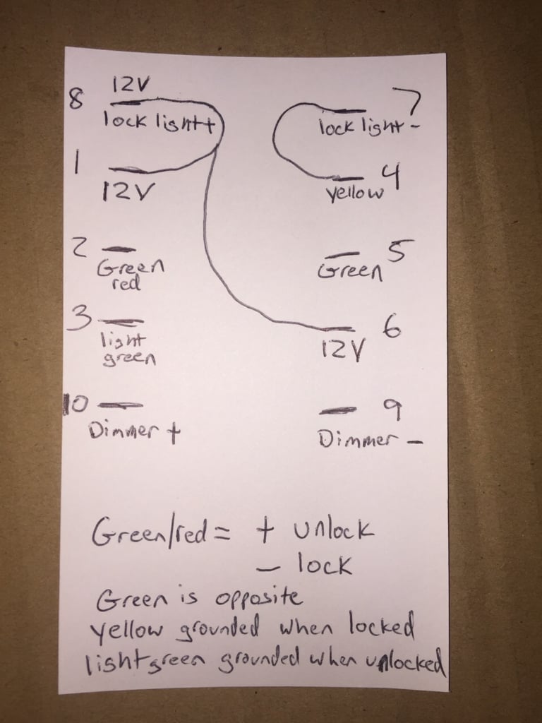

So I picked up a Toyota e locker with the same gear ratio as my T4R. I've been doing tons of research on this conversion and feel confident .

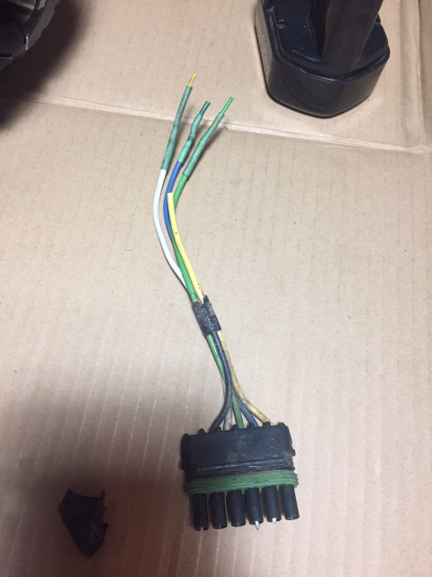

This is an eBay purchase and the guy said it came with the wiring harness but after getting it I see it does not. I'm comfortable with wiring but am not sure what wire is what because some of the wire colors are different from other swaps I've looked at.
From left to right, light green, green/red, yellow, black, green. Anyone have these color wires and know which is which?
Which post is which?
I hope to do the install Friday after my switch, gasket and other stuff come from lowrangeoffroad.com
Thanks in advance[emoji119]

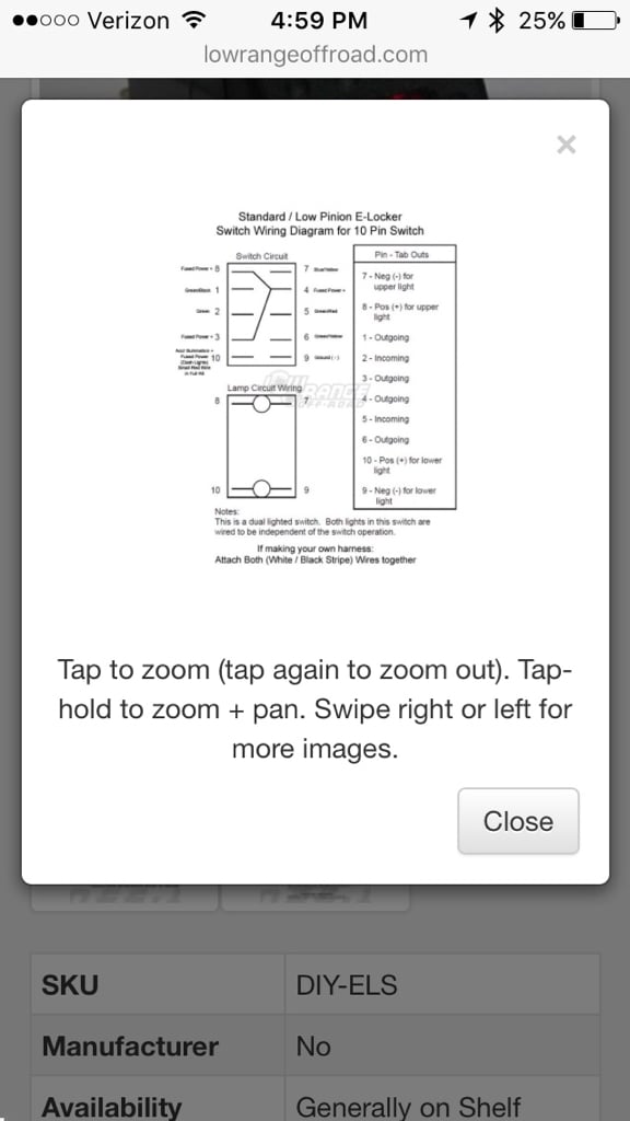

You really only need the 2 motor wires and the 2 "locker engaged" wires on the smaller connector to close a circuit for an indicator light that shows the locker is engaged. The rest are pretty much useless and only apply to the factory ecu.
You will need 2 30A relays and a carling dpdt momentary switch with built in indicator light.
Relays:https://www.amazon.com/Bosch-332209150-Relay/dp/B0010AH6YM
switch: https://rockerswitchpros.com/product/vld1-a60b/

yes, I currently have it working on my truck. It works great. The motor cannot be continuously engaged because a momentary switch is used. You just hold down the switch until the light comes on, showing the engaged state. Hold down the switch the other way until the light goes off, showing disengaged. Its that simple. There is no reason to use the "disengage in progress" or "engage in progress" wires if you are making a manual switch.

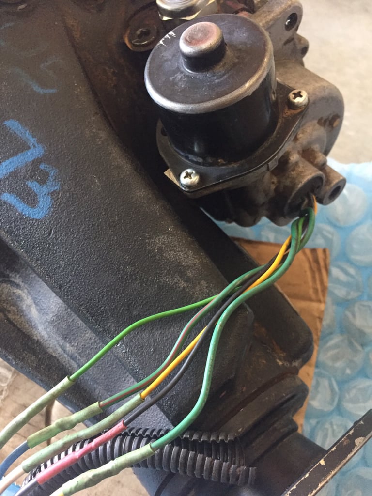

Unfortunately the wires were cut before the harness and they change colors after the harness.

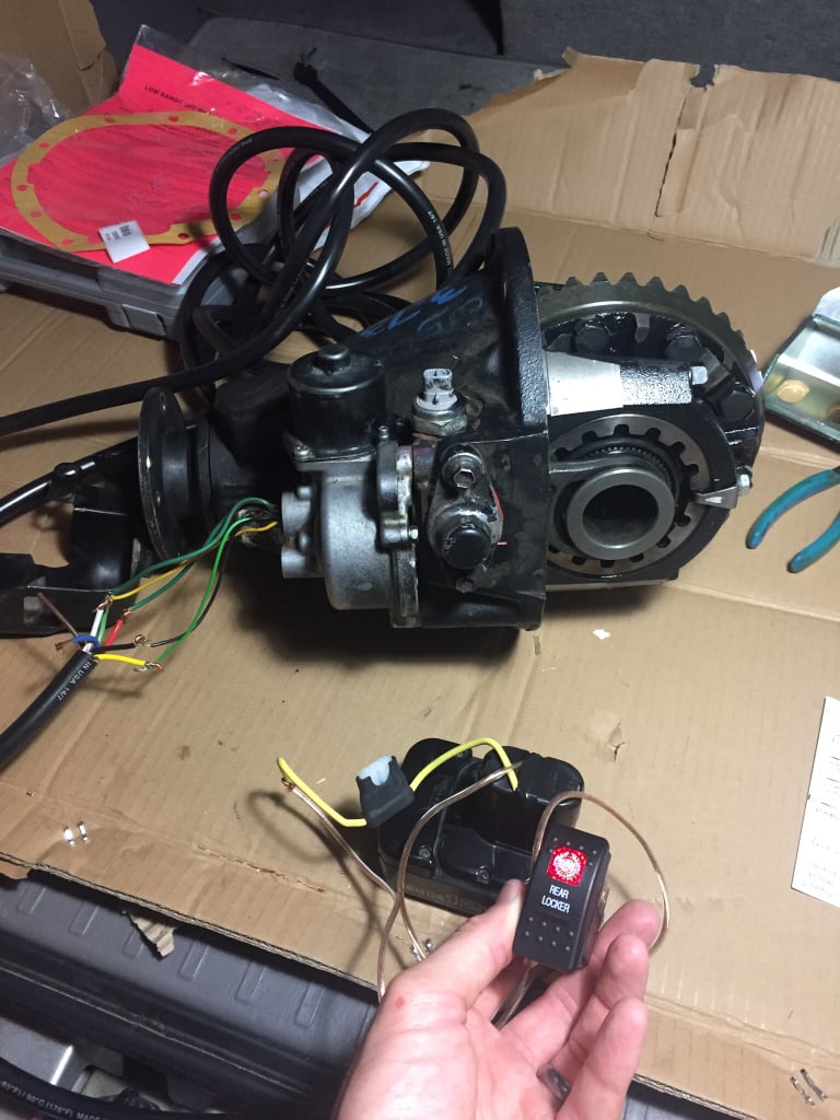

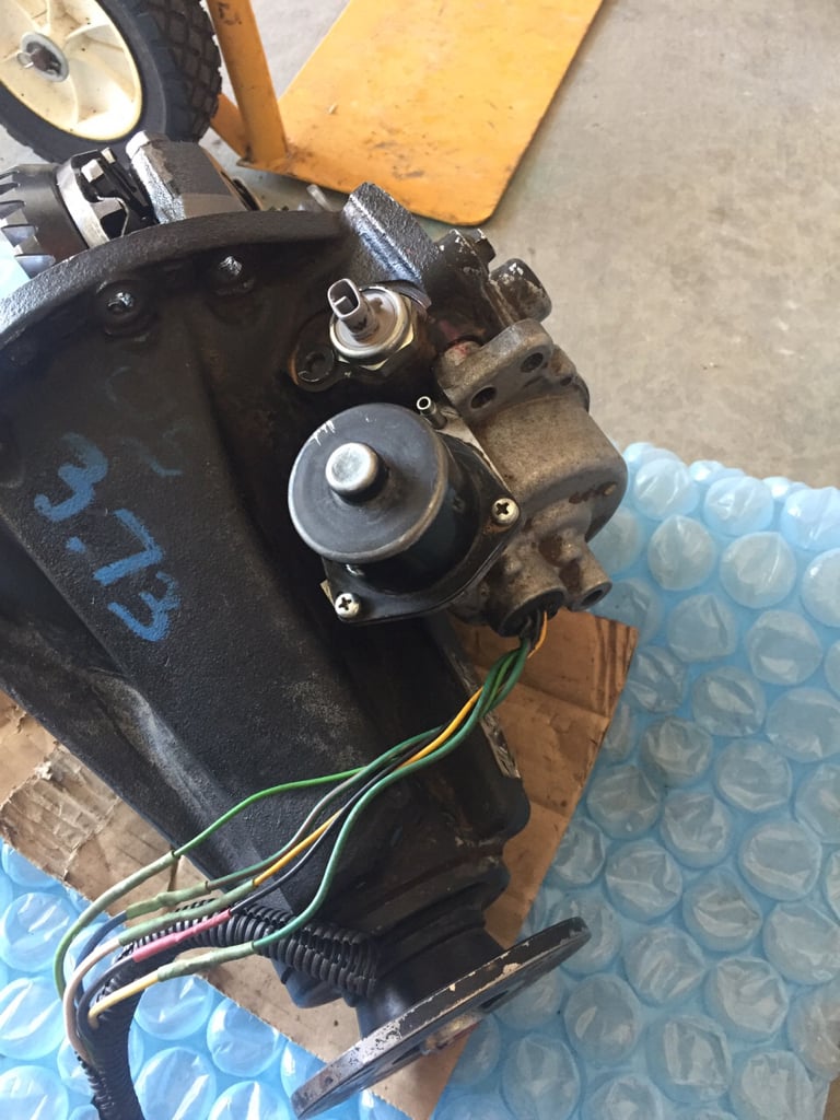

This is what was coming from the 3rd member.
I discovered that the solid green and green with red power the motor. Depending on which wire is positive or negative will lock or unlock the diff. The yellow and light green wire alternate as ground to tell the motor when to stop. When fully locked or unlocked the circuit looses ground stopping the motor. Black wire is always ground.
If the factory harness was still attached this would be super easy.

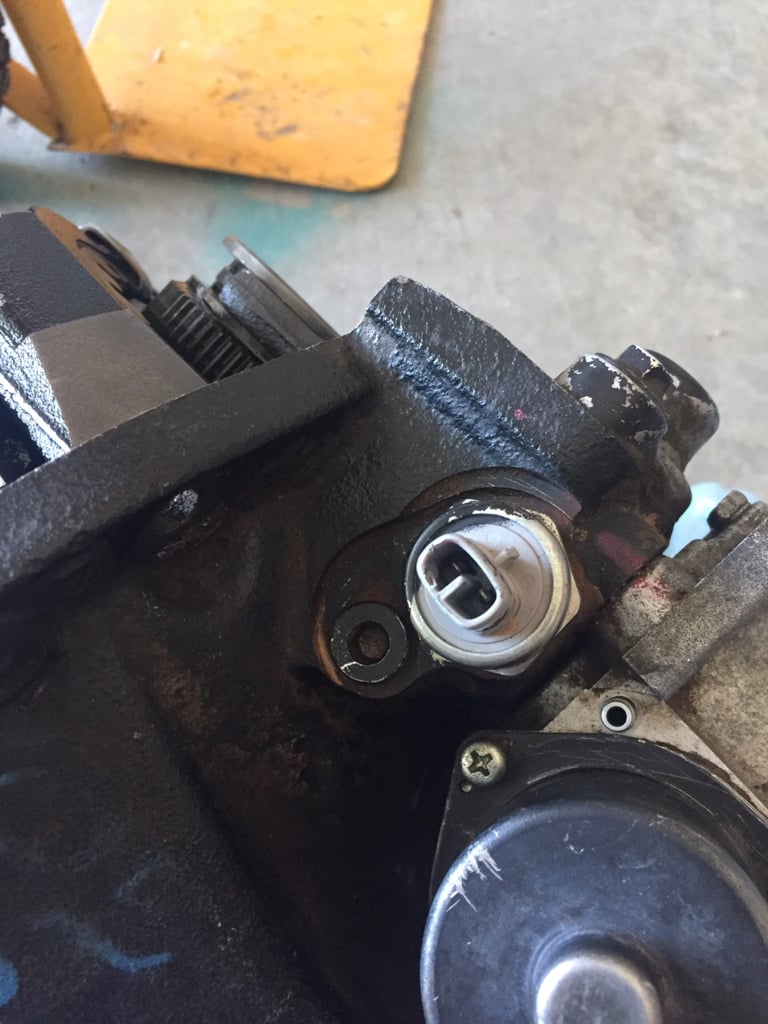

From what I've read the two pin connector I have photoed is to hook up to a led to signal locked position. Still not sure which is +.
The switch and other stuff I ordered should show up today and then I can wire it and test the led.
-I discovered I don't need to use that plug-

Got it figured out.
The colors I wrote are what's coming from the actuator before the harness at the diff. If you get one with the harness then this is much easier because the wire colors match what the instructions say.

Ignore the two wires coming from the top of the 3rd member.

The two wires coming from the top of the 3rd member in the small grey connector are the "locker engaged" indicator. When the locker is engaged all the way, those two wires close a circuit. That is supposed to be connected to your light on the switch to show when the locker is actually engaged or disengaged.
