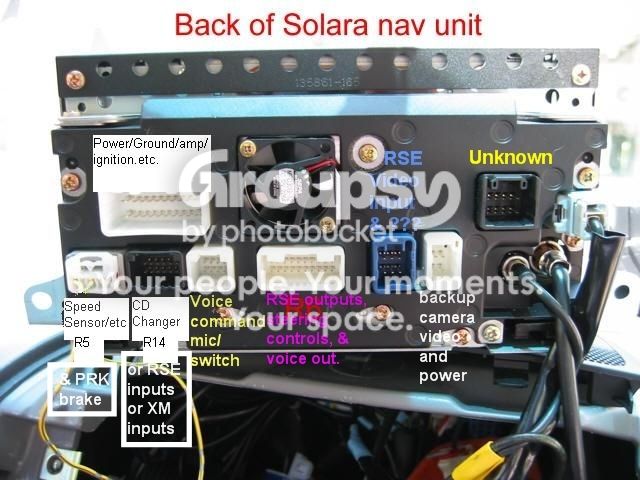

Older NAV: note: it doesn't have the 24 pin plug. Is this the pic you were referencing? If it is, it won't do you much good.
solaranav_zpssfizz78v.jpg~original
Hope this helps!

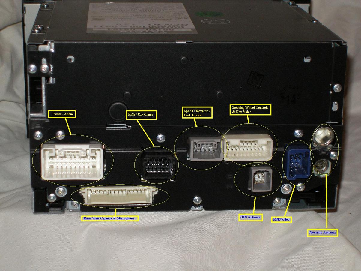

This first picture is of the back of an E7007 nav unit. The E7008 will be the same.

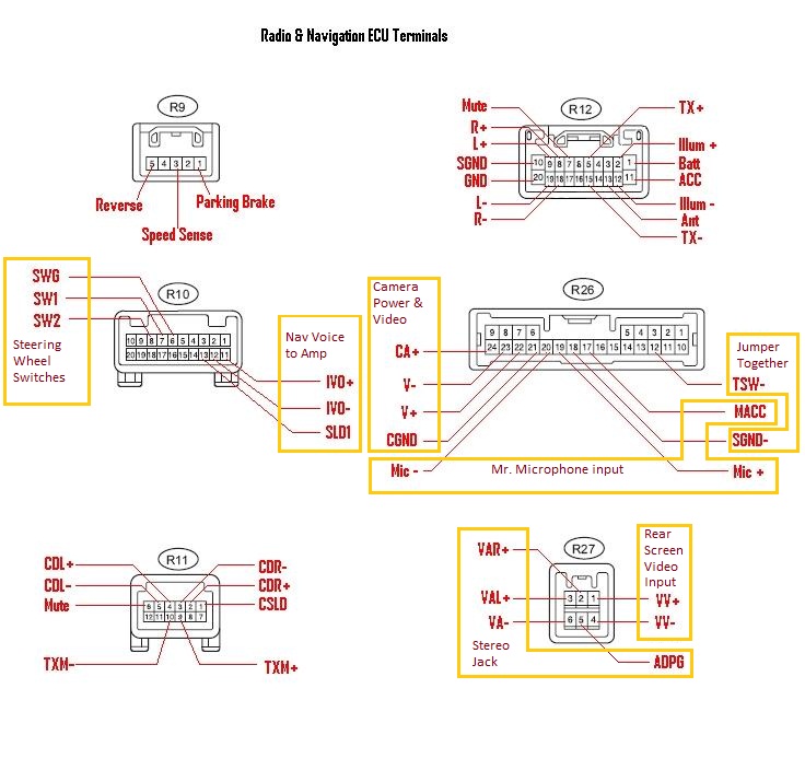

I made this pinout diagram several years ago, and have seen it reposted a few times since. Nice to know it's been useful.

Thanks thats the photo I was looking for. The guy I bought the HU from went to the dealer and thats what they told him. I had never heard of that before with these HUs. He offered to buy it. Frankly, I think that since the HU is stuck on the "no map dvd" screen, I would think that after I get that in there, it will work. But I don't know for sure. $20 and a few days from now when I get it in the mail, I will know. Yes I do plan on replacing the amp. Like you said, the '03 is analog and doesn't have bluetooth either. I wanted to make sure the HU was going to work before the next step, amp, steering wheel controls, XM, etc. If this map dvd doesn't work, I will be returning the HU and going aftermarket.
