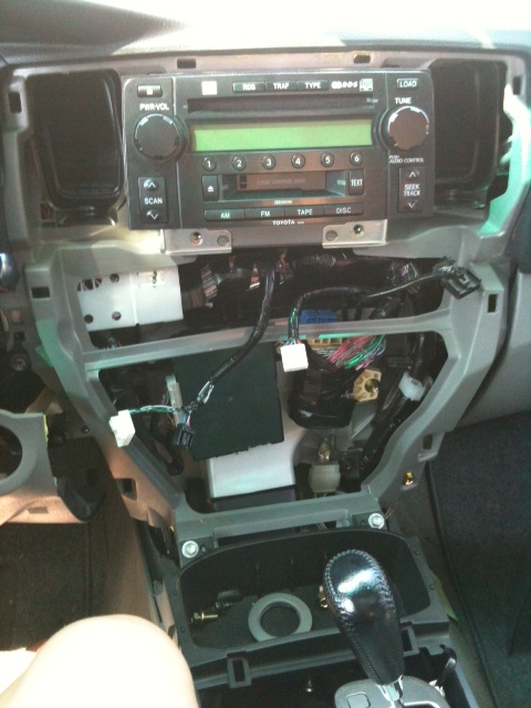

First picture should give you an idea of where the harness is that has the VSS in it. I believe this is the lower one. (I thought it was the upper harness)

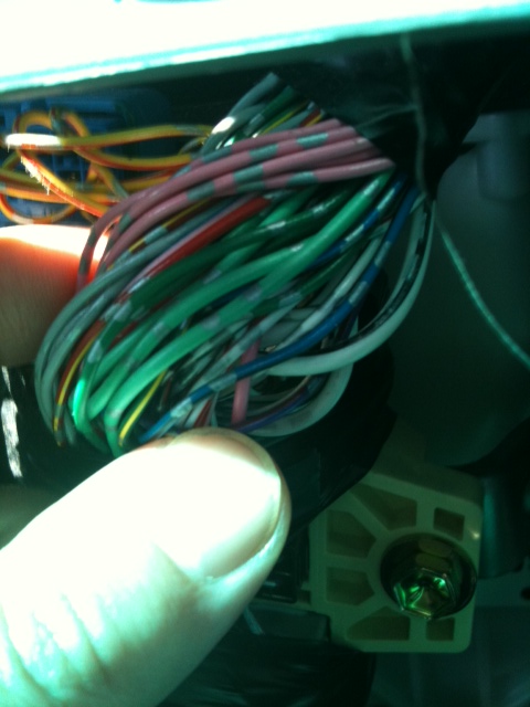

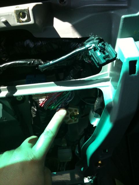

Second picture is a zoom and the third has a close up....... the VSS IS somewhere in there!! (Purple with red stripe)
