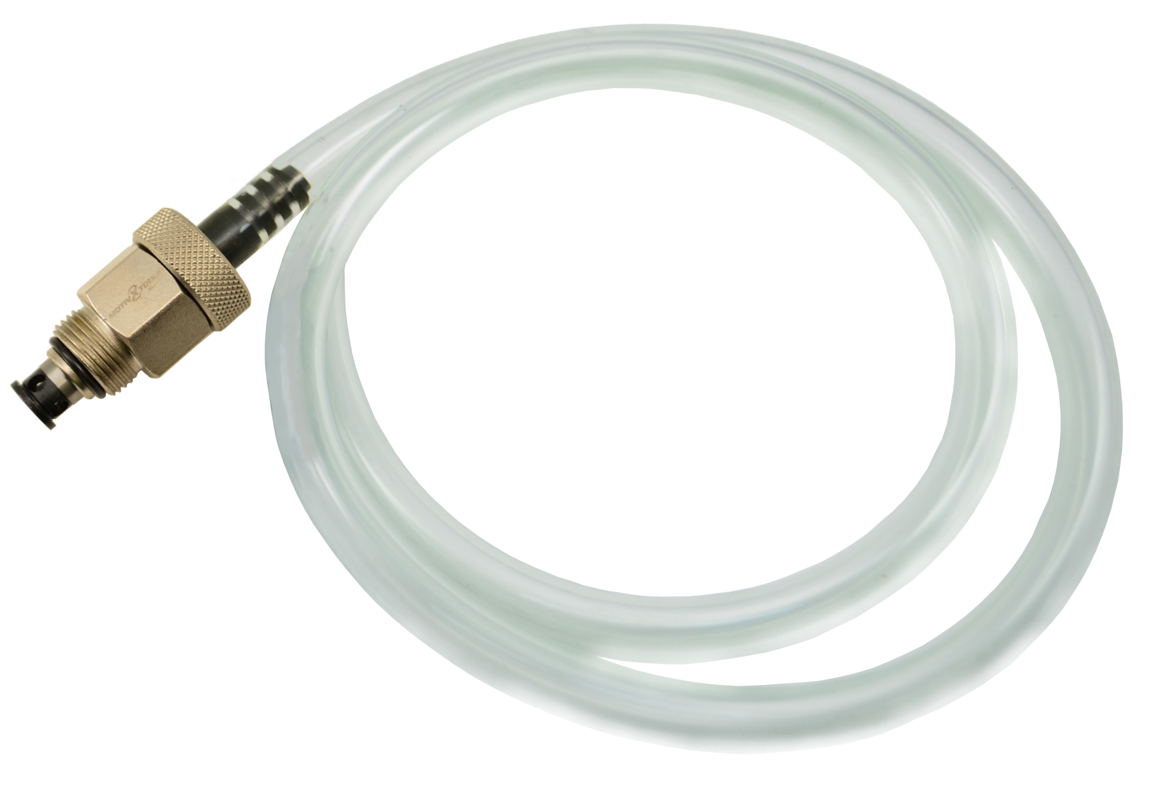

I replaced the oil drain plug with a fuomoto valve. I know use a clear tube hooked to the fuomoto for a splash free oil change.

You can price together a kit for far less cheaper (minus the billet filter housing), and have a spill proof setup. This is what I did:
1. OEM Landcruiser metal filter housing (amazon)
2. Motivx drain kit (20ish dollars amazon), replaces the nub on filter housing.
3. fujimoto valve for oil pan (not sure how much I forgot).
4. cheapo filter wrench (9 dollars amazon)
To be honest, the billet housing is way overkill, considering the oem 4runner oil filter housing is made of plastic, and in a relatively safe location. Anyways, to each and their own.....
IF you do a search on fujimoto oil change/valve, you guys should get some hits.

+1 on the Motivx drain. Instead of the stupid plastic snap in (if you're lucky) drain, it screws into the oil filter housing and has a valve to empty the filter housing.
