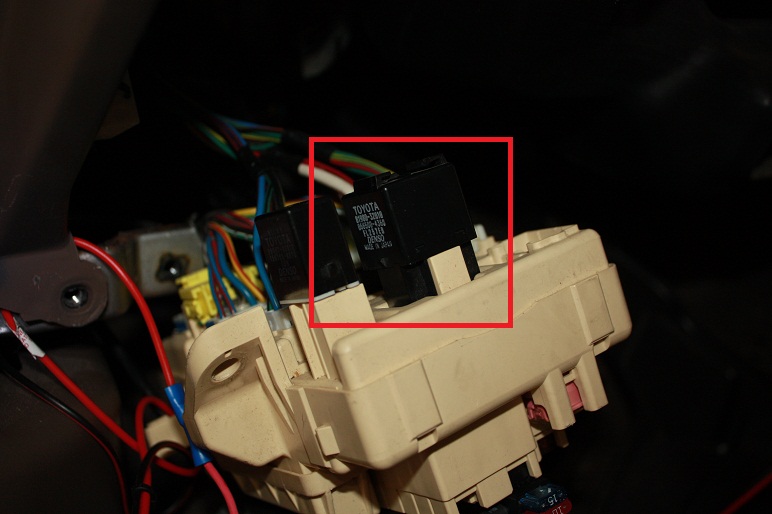

Need a hand here. Just installed my front LED turn signals and as expected having the double time blinkers but the flashers worked fine. Came across this post and pretty much followed it but no luck. any suggestions?
from what i can tell it is the larger of the two relays in this photo. right?

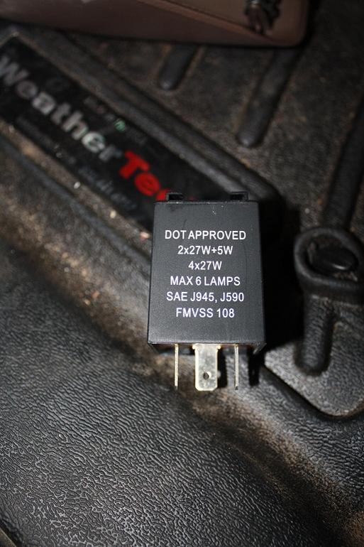

this is what i bought to replace (just so happens the relay is the same wattage?)

hummmm.......so did you change the same relay i had highlighted in my previous post? what year is your runner maybe that makes a differenece???
