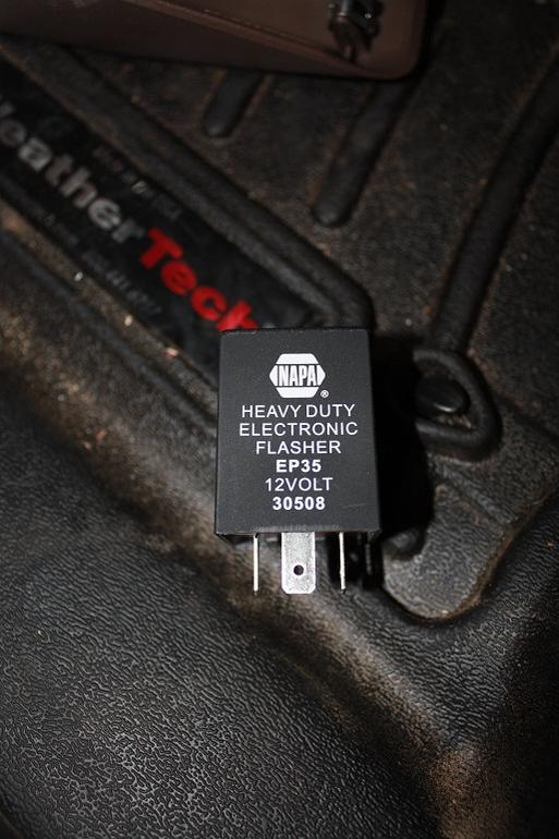

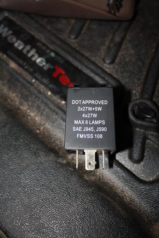

huh....i will give it another try this evening and see what happens. thanks for the post Ripcord.
This is what i got. it says EP35.
Not sure about the 'tridon' though.

Well I am please to note that i have solved the problem.
The EP-35 from Napa is worthless. Dont buy it.
Went to vato zone and picked up the Tridon EP-35 and it worked like a charm.
the blinker click is a little louder but speed is good. no more double time.
