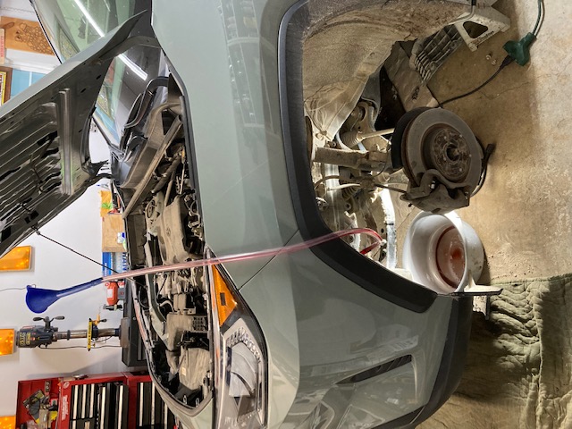

Its so much easier and faster to fill using the transmission fill hole. Get some 1/2” ID clear hose at the hardware store and run it down to the the tranny avoiding the exhaust pipe and hook the funnel up to the hood. Whereas pouring ATF into the radiator port which is only 3/8” nipple and an even smaller opening. Now this is important also for when you go to set the level later on. If you get to the correct temp and open the level plug on the trans pan and no ATF comes out, you need to move quick to add more fluid before the tranny temp gets too hot.
What I do is try to overfill by 1/2 Qt. When the temp gets to 100* I open the level plug. If no fluid comes out, I simply dump in more ATF until it pours out. Then wait for 110* and cap the drain off at a trickle. Using the radiator will make you stop everything, add fluid then restart the process.
This pic is of my kids rav4 getting the ATF exchange. Same process, different vehicle. The 1/2” hose is a snug fit in the fill hole. Push it in only as far as the threads are deep so you dont touch any moving internal parts.
