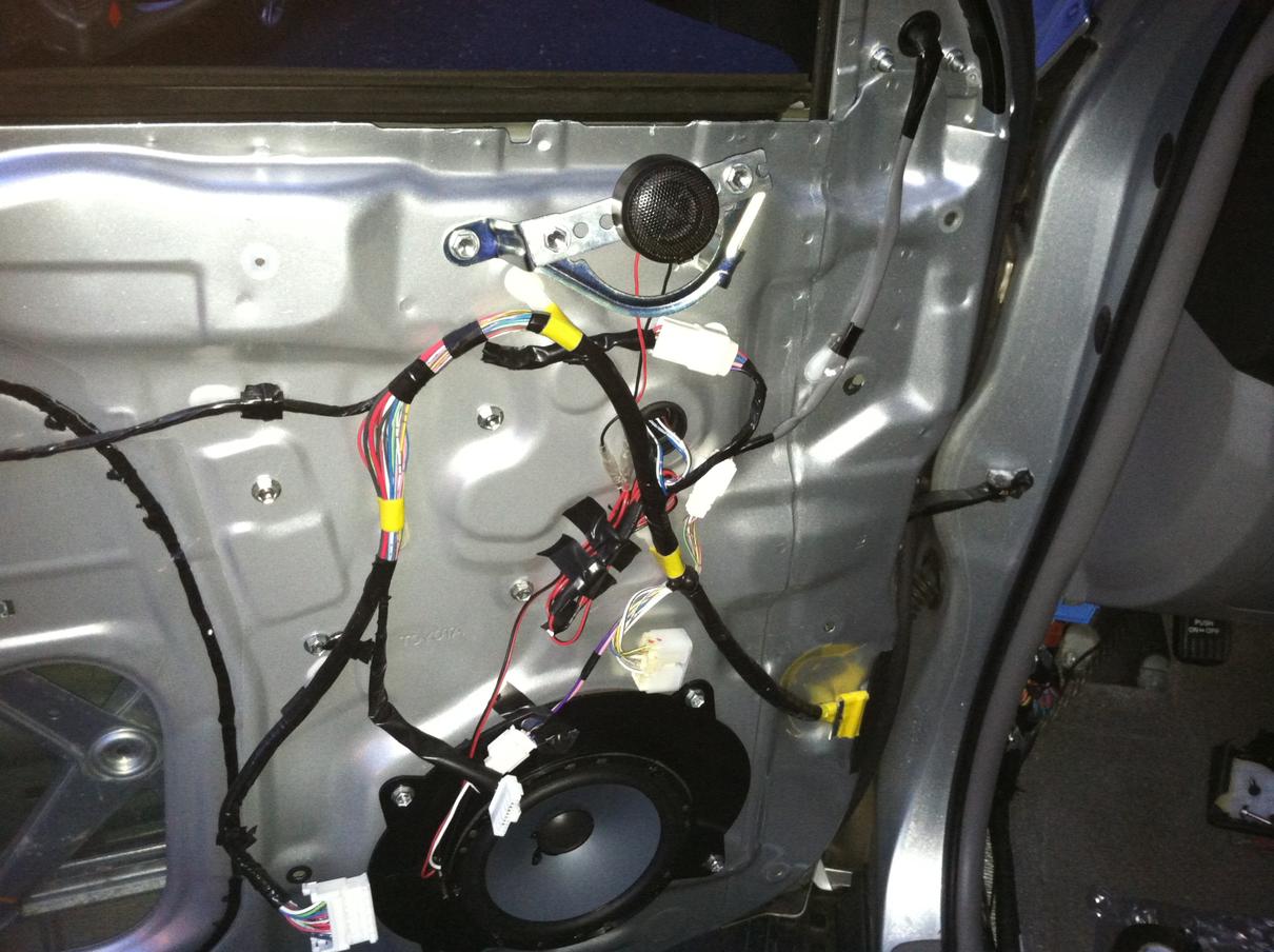

Under way on changing out the stock non JBL stereo system in my 3 week old new to me 08' SR5. Just finished up swapping out the stock speakers in all 4 doors. I insalled JL Audio TR650-CXi 2-Way 6.5 in the rear doors and
JL Audio TR650-CSi 2-Way 6.5" in the front doors.
I am a novice installer and did not want to tackle the crossovers. A fair amount of modifiaction to the Toyota aftermarket speakers mounts that I found on EBay to get the speakers to sit flush in the mounts. The mounts lined up perfectly with the factory speaker mounting holes. I used closed cell foam tape to seat the speakers on the mount and a thicker closed cell foam tape between the mount and door skin as an inexpensive dampener. Didn't want to mess with Dynamat type products.

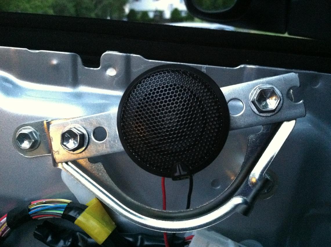

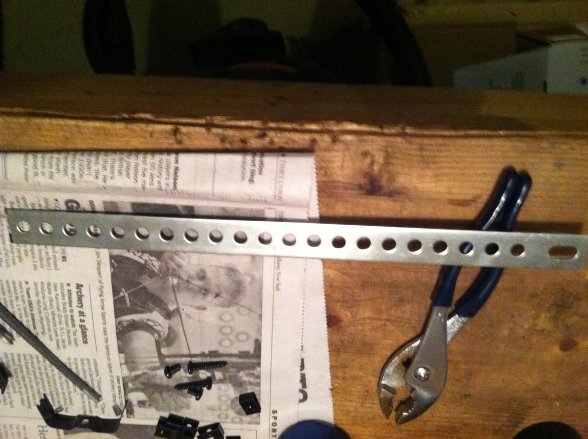

Tweeter mounting was a concern, but i found an inexpensive and easy way to mount the new tweeters in the factory mounts. I cut a piece of backstrap to length, the holes in the back strap lined up with the factory tweeter mounting holes. I had to make some small notches to pass the speaker wire through the tweeter mounts. But with cutting, filing down the edges, and mounting the tweeters, it was honestly about a 20 minute job for eah tweeter. Cheap and easy. Hope this helps out a bit with future installs and this forum has been invaluable to me.

No, the tweeter mounts have 2 holes in the back of the housing. I ran two screws through the housing and attached to the back strap with the clips that came with the speaker hardware. Just make sure your tweeter top depth gives you enough clearance to place the door panel back on without hitting the tweeter. I had to modify slightly to overcome this. I used a bench vise to bend a u shape in the middle of the backstrap the same width as the tweeter. Set the tweeter in the U and attach to the back strap. 2nd pic in the post was before I made the mod to the shape of the backstrap. Still a cheap and easy install.
