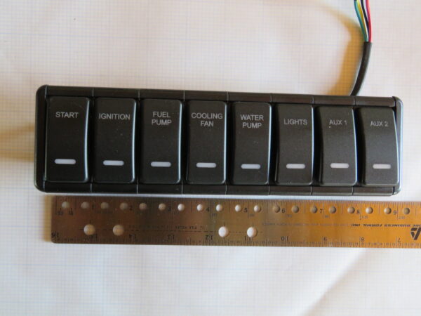

However... in my searching, I happened to find a couple of the Eaton/Bussmann 31m systems on eBay that had never been put into vehicular use. One of the listings also came with a CAN bus switch panel, a USB to CAN adapter, and various plugs and connectors. So cost of entry into trying this 31m approach for a one-off installation was reduced. Famous last words: "This trail doesn't look too bad at the turn-off."

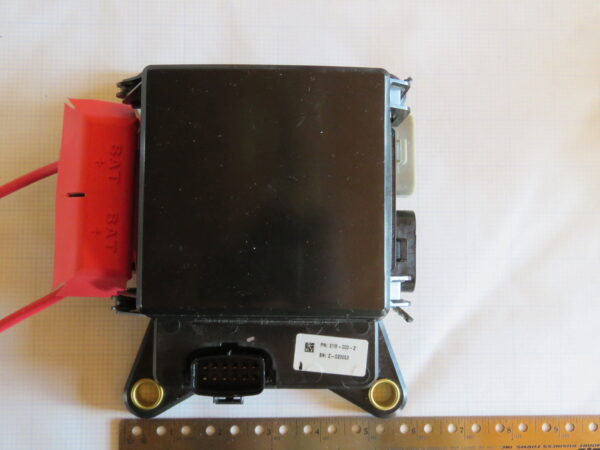

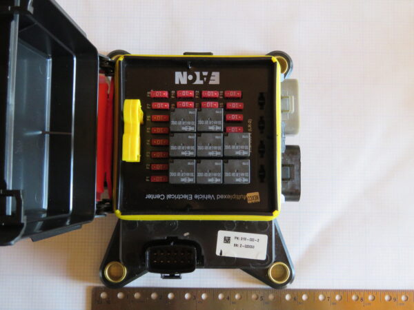

  • Ordered and received a 31m-000 with the HMIsystems switch panel (482CRM-8) and various connectors via eBay.

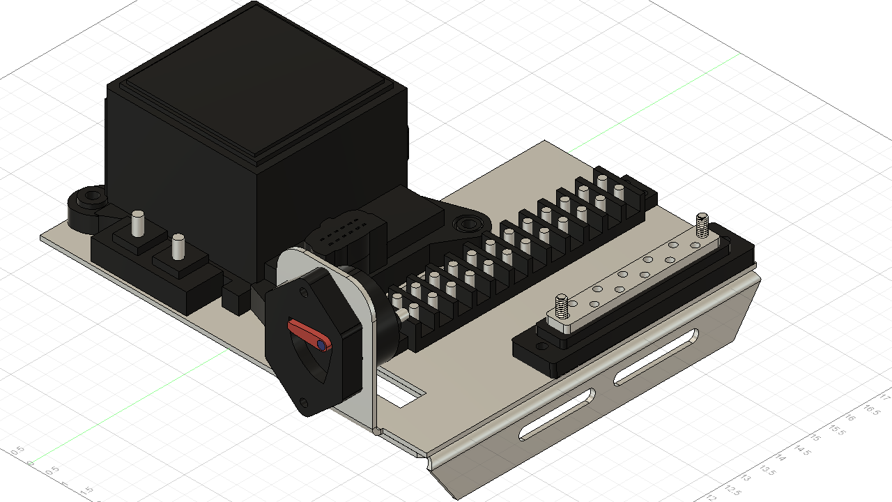

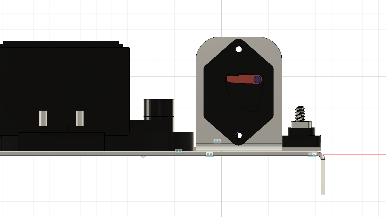

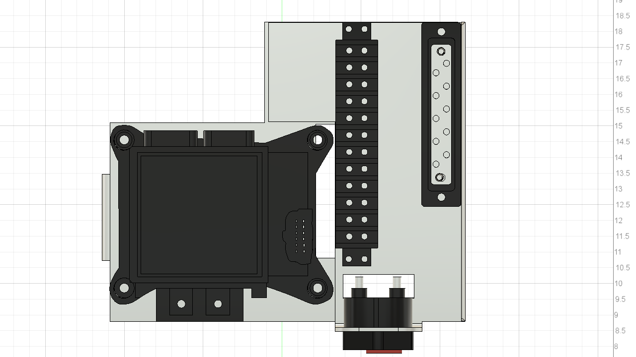

  • Designed a 3D model of all the parts, including a secondary tray to help solve the access to the 2020 secondary fuse-box issue.
The secondary tray approach is worth particular mention. I'm going to cut a hole in the base tray so that the stock secondary fuse box can be reached. That should also make it easier to reach the bolt-holes on the fender side to attach the main tray. The secondary tray will be either directly on top of the main tray, or elevated slightly for clearance purposes. It will be attached with bolts on the perimeter, so it can be easily removed if access is needed to the stock relay box. The secondary tray also will allow me to place a circuit breaker in an upright location.

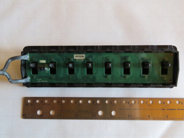

  • Continue to try to reach out to HMI systems to see if my concept for shortening the switch set will work.

I've attached a couple of photos of the 31m unit, the switch panel and some shots of the 3D model (nice to know that everything seems to fit ,with the exception of one bolt-hole that might wind up being a bit wonky). With all this at-home time I started to learn Autodesk Fusion 360 - they have a free license for personal use.
