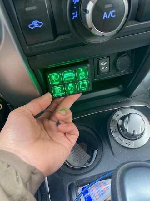

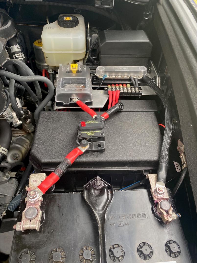

Last year, I ran 4awg off positive to a 100 amp bussmann circuit breaker to the Blue Seas Fuse Panel. Then 4awg off neg. to Negative terminal block. Mounted Auxbeam Switch Panel box on this same aluminum tray in rear( See photo) This relay box is wired into the under hood fuse box with an Add-a Fuse. The control switch in run threw the cabin into middle console area. This has worked great for my outside lights or any future add ons.
