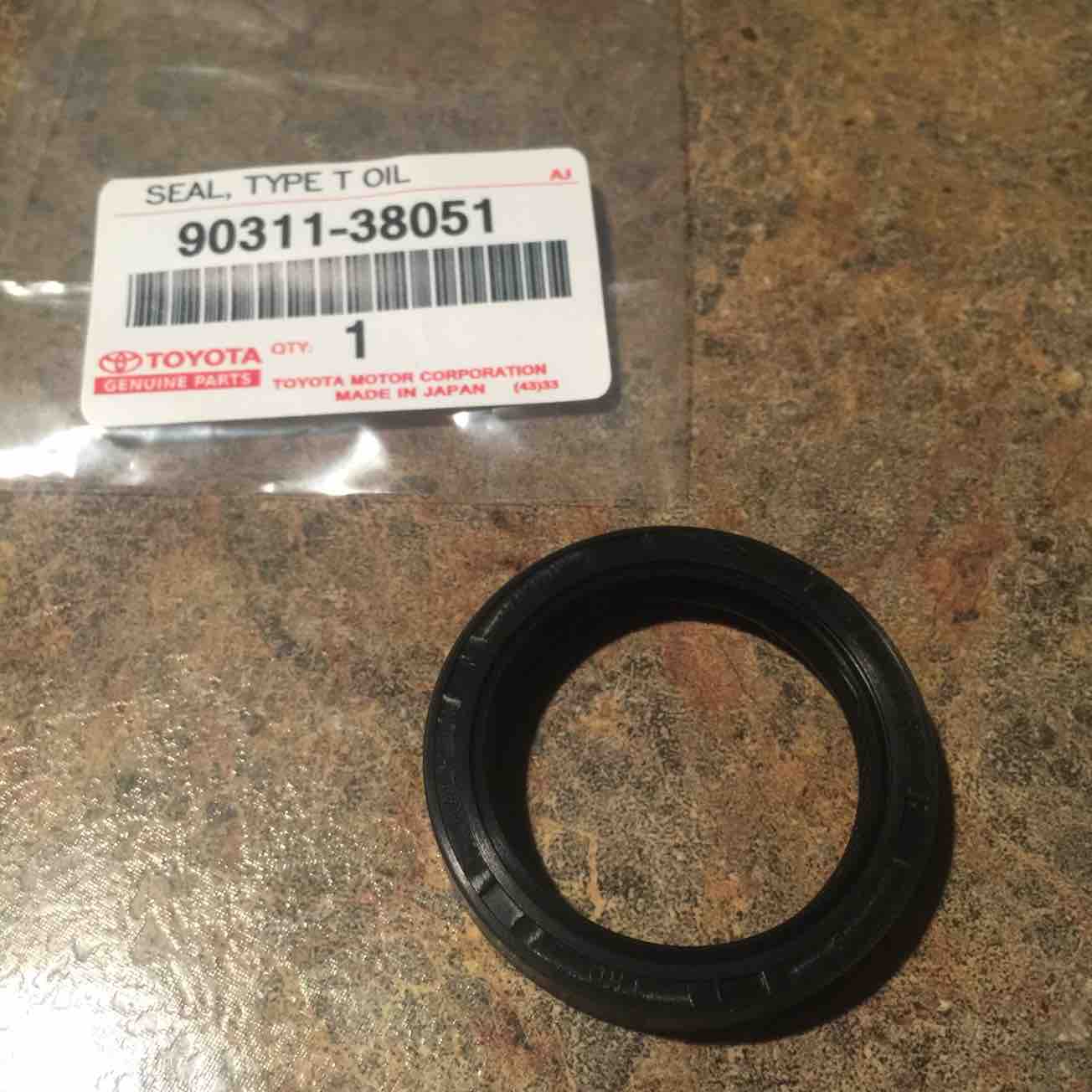

I hope someone can help me. Purchased a kit online and everything is said to be Toyota OEM besides the idler (Koyo) and timing idler (NSK). Further research has me thinking these are not new original Toyota parts.

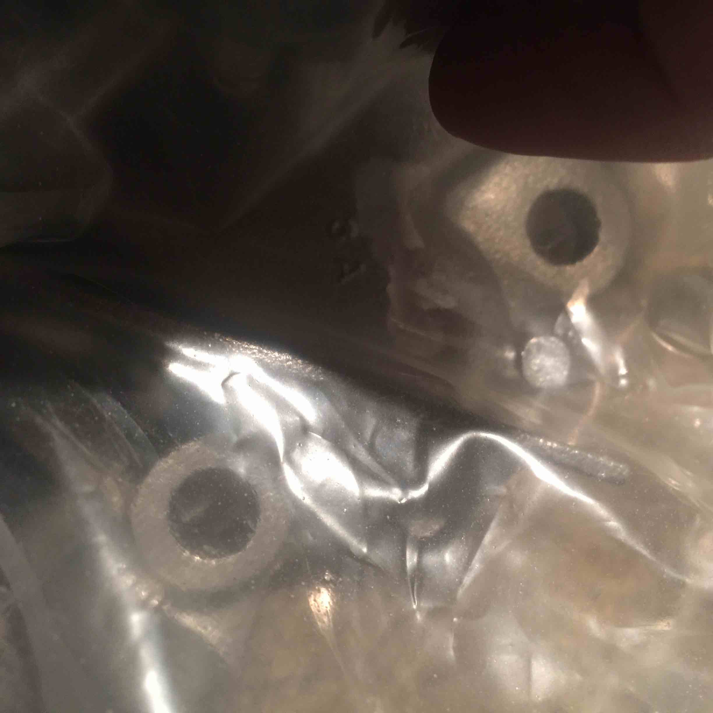

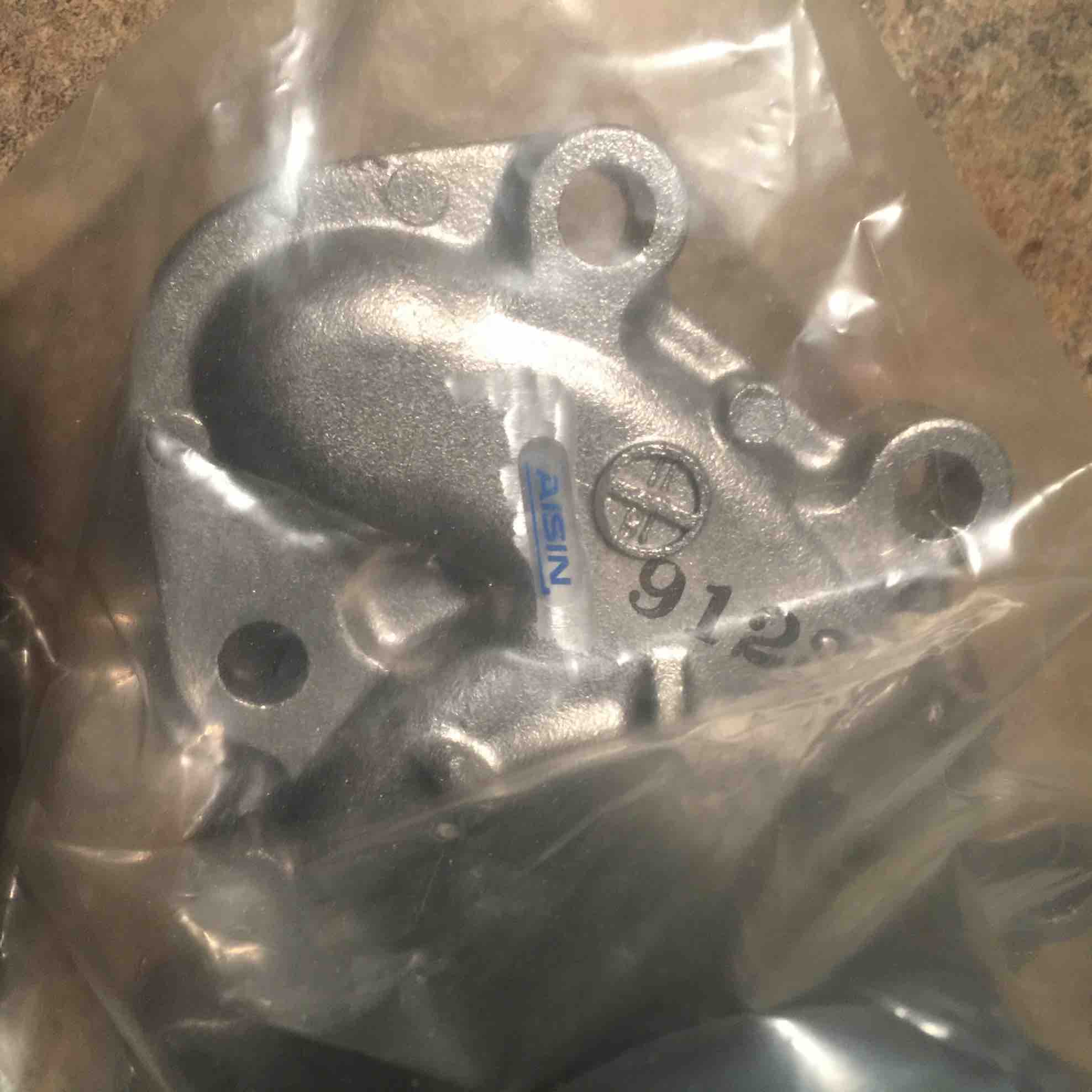

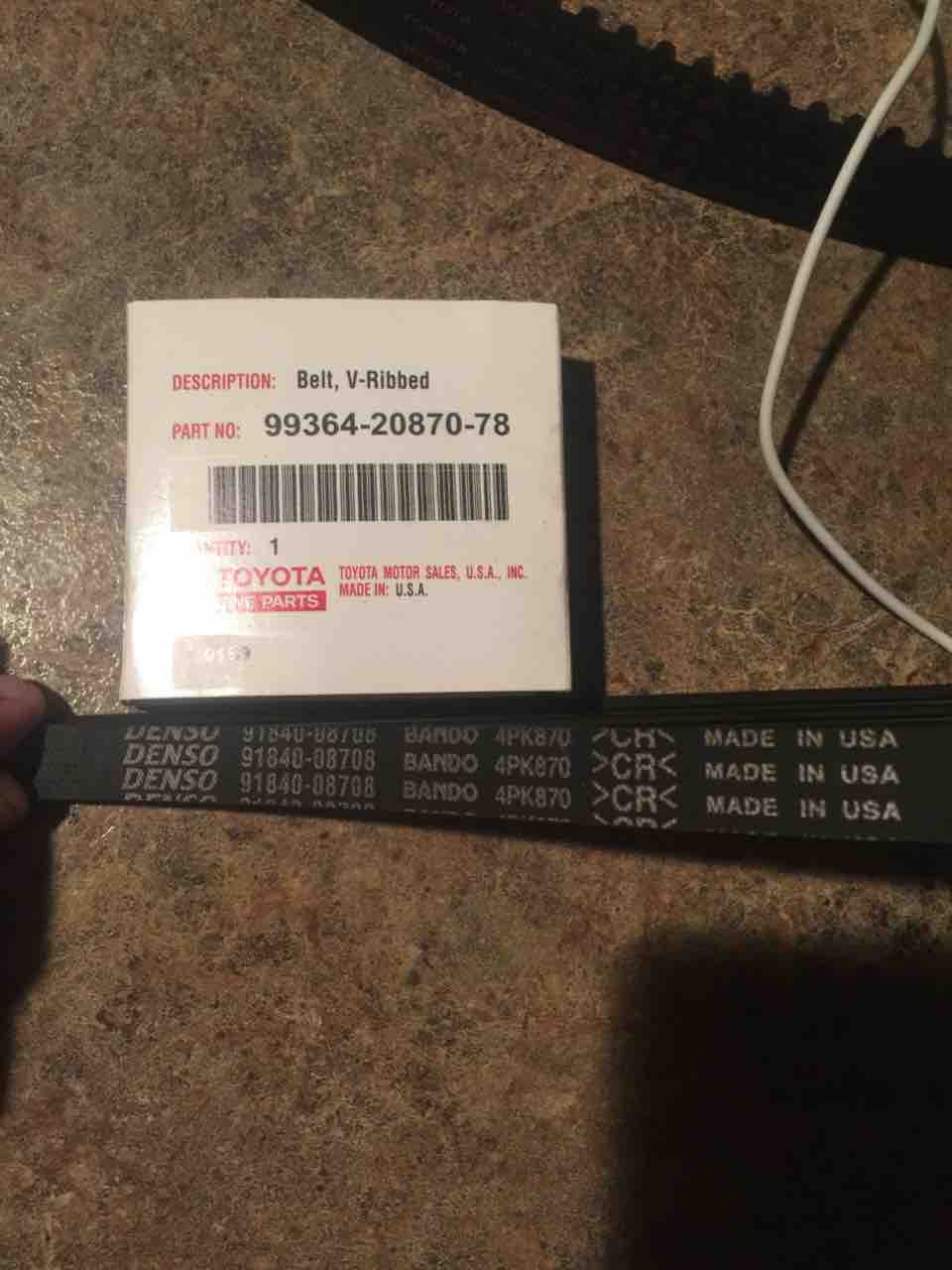

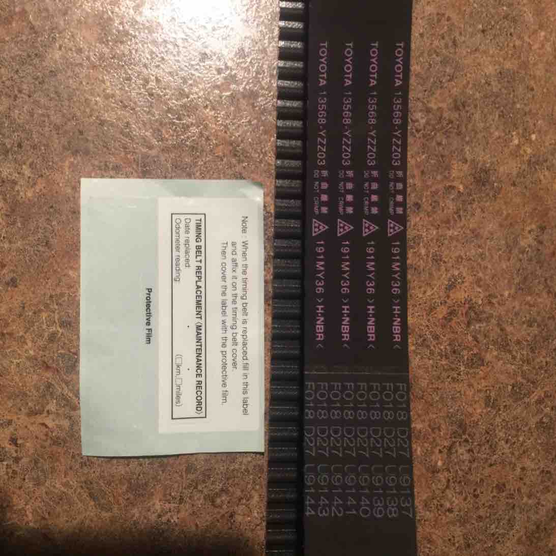

Anyone have any thoughts? Both cam shaft seals are black not brown like the originals. Timing belt has Chinese writing and no where says made in Japan. Water pump looks grounded out where the Toyota and Aisin labels would be but instead there is an Aisin tin sticker. And the Toyota drive belt part number does not match the denso part number.

Well some of it looks legit. The oil seals from the camshafts seals sometimes go through revisions. So they maybe OEM. The Timing belt hard to say. The OEM MFG is Aisin for the water pump but they don't grind the housing and put a sticker on it. they are actually stamped in the housing Aisin where the Toyota is stamped..
I have gotten Toyota Drive belts from the Dealer made in the USA just like that one.
So my thoughts is that some of these parts do not look right. What do other users think?
Its been over a year since I did my last timing belt, and I don't remember it saying Toyota....but it was dealer supplied....could be my memory but thought the brand started with an "M".
The water pump came in an Aisin box but the Toyota & Aisin stamp seem to be grinded off and replaced with a sticker seems weird. The timing kinda weird looking too

I know my asin pump I bought in my kit had the asin stamped I. The housing just like Toyota did on the OEM one I pulled off.
