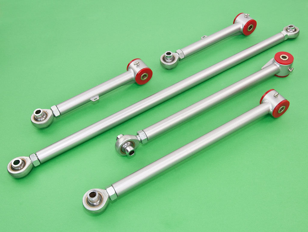

After seeing the popularity and surprisingly good reviews of the EBay UCA's, figured I would start a separate thread for the newly released no-name track bar and rear control arms.
They seem to be from the same manufacturer. Wondering who will be the first brave soul to try these out. I'm not nearly as knowledgeable about the use/need/benefits of upgraded track bars and rear arms as others, so please people, add to the conversation.

vendor 1 "lift.option"
Upper Lower Track Bar Arm for 2 4" Lift Kit 4 Runner FJ Cruiser 03 09 | eBay
vendor 2 "blitz.auto"
2003 2009 4 Runner FJ Cruiser Upper Lower Track Bar Arm for 2 4" Lift Kit | eBay
Both listings are identical.
Their description:
Surface Finish: Heavy Duty 4130 Chromoly Tubular
Product Description
These adjustable control arms are made from carbon steel with polyurethane bushings & solid rod end bearings. Eliminate wheel hop, steering wander, increase traction and wheel alignment with an easy bolt on installation. 100% TIG welded for the ultimate in strength and appearance. These control arms are built with an offset to provide maximum tire clearance. When running larger tires they can rub against the stock control arms at full steering lock, our offset design eliminates this problem. You must to have these when you lift the vehicle 2" or more!
Package Content
Rear Upper Control Arms x2
Rear Lower Control Arms x2
Rear Track Bar x1
Digital Installation Guide x1
Installation time is approximately 1-2 hours
Vehicle Fitment
Toyota 4-Runner 2003-2009 2WD 4WD
I'm tempted since I need to do something about my upper arms anyway. It's going to depend on how long it takes for my tax return to get here. I was already going to buy the uppers from Metal Tech, but if I can get the whole package for a couple hundred more, I might as well.
Be wary of Chinese steel. Try and get the tubing thickness from them and compare them to some made domestically. The material certs on the "same grade" of steel will surprise you when you look at domestic vs China.

the upper control arms from the same manufacturer were advertised as a lift kit too

/\ correct, but, the tensile strength is different even though at same gauge/ thickness.
I'm not sure if this is something one could conclude about an entire countries steel tubing.
Who knows exactly what is used. The front UCAs are apparently made in the USA.

Most Chinese steel is sub par quality. I run a machine shop that builds oilfield tools. Most of our customers will refuse a tool if the material certs show China as the country of origin. I'm not talking just mom and pop companies either. Sometimes we have to use Chinese steel but we have to have the material tested by a US certification company in order to meet the specifications we need for our tools and our customers tools. Most companies that are not held under ISO, API, etc. don't look at material certs before they use material. Who knows who made them and where.
I'm not saying the arms are junk but I would investigate them further before I put them on one of my vehicles. My concerns come from a manufacturing engineering and production background.

You are correct every batch of material varies slightly that is why there is a range on the specs.
The Chinese stuff they are using might be great stuff but how do you know?
