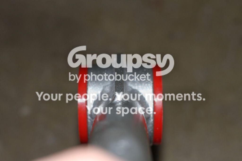

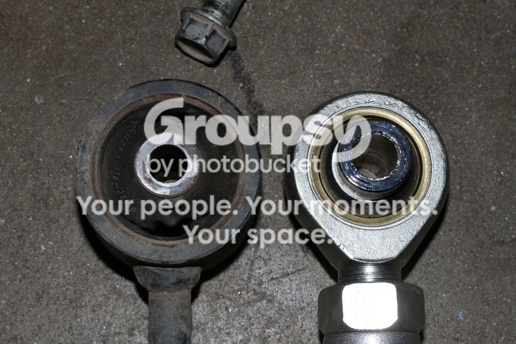

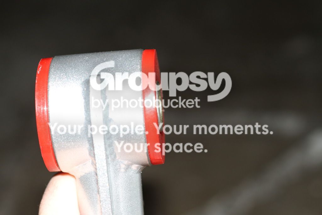

You know, that's another thing to note. While the UCAs have to be assembled, the rear arms did not. Bushings, sleeves, and zerks were already in/attached when I opened the box. The only thing that wasn't put together was the panhard bar, and I'm assuming that was to get it to fit in the box they used. Assuming there's some grease in them, but I'll give everything a pump or two once it's installed.

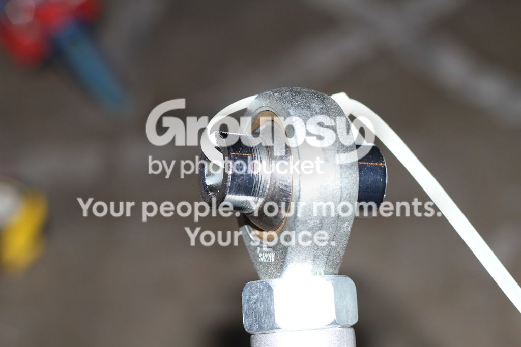

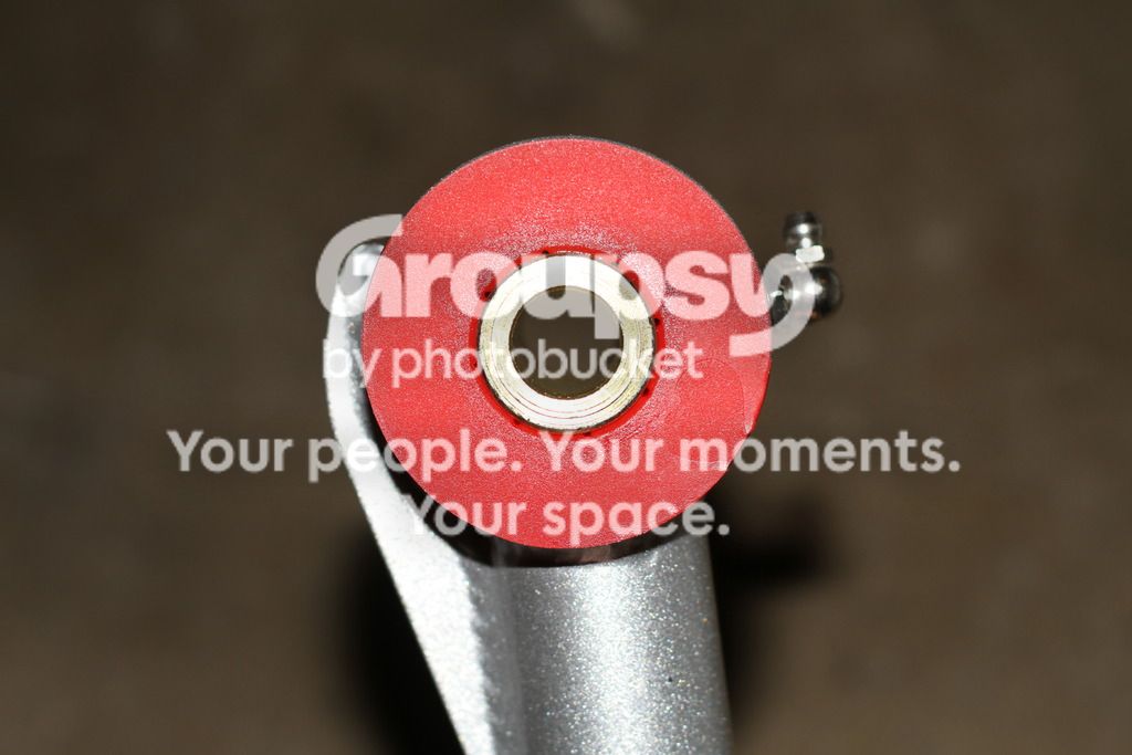

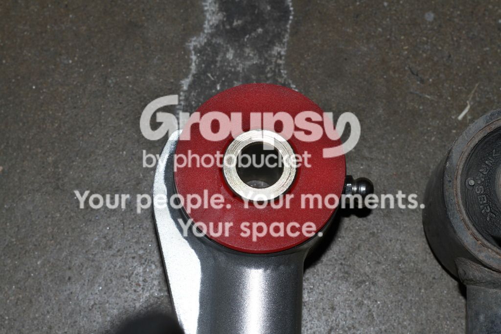

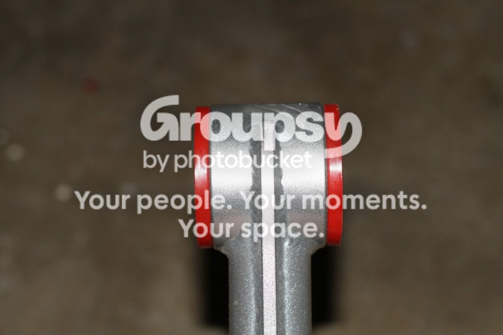

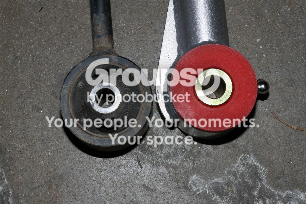

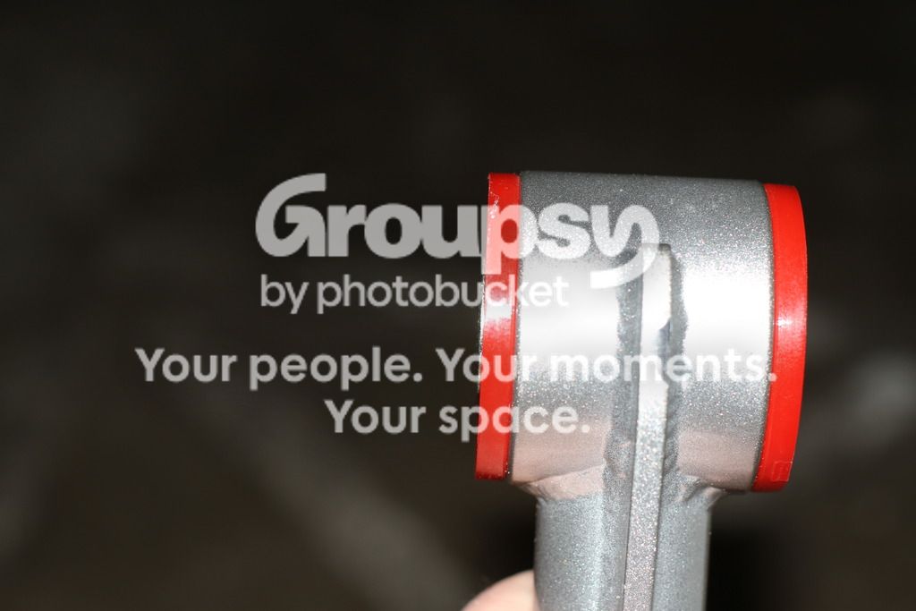

Here we go. Bushing pics. Sleeves are fairly flush.
017.jpg~original
015.jpg~original
018.jpg~original
016.jpg~original
024.jpg~original
025.jpg~original

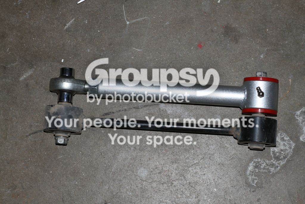

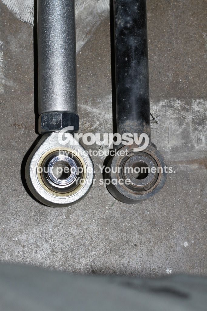

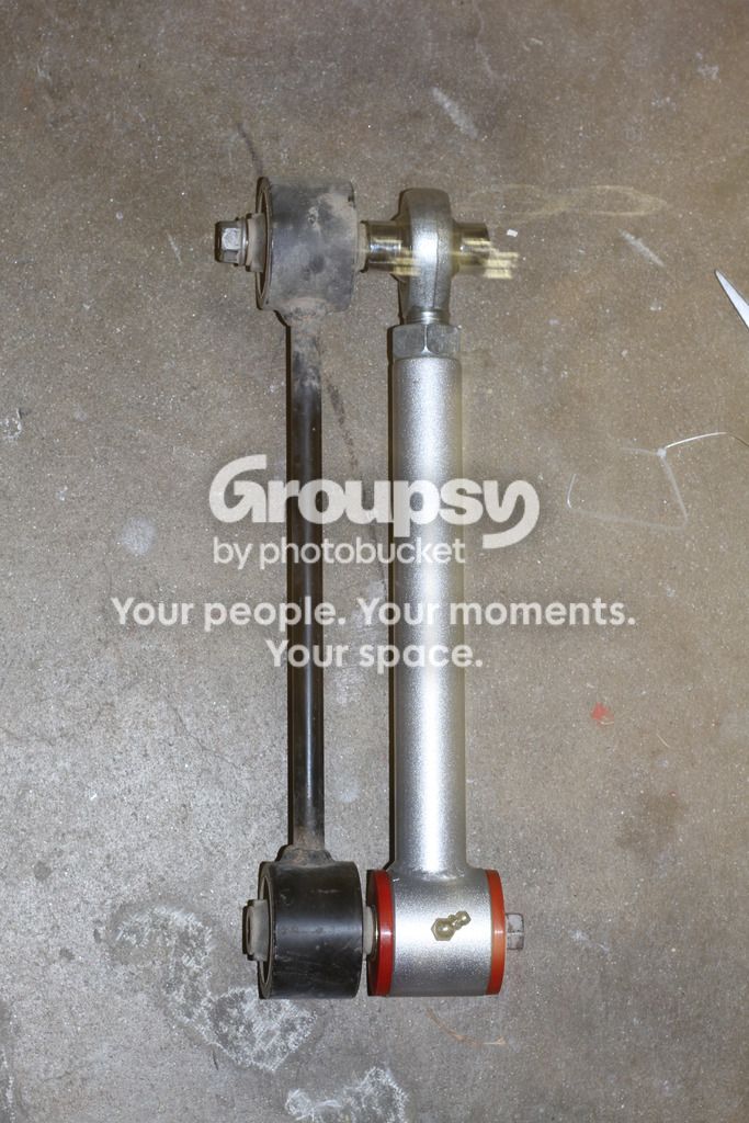

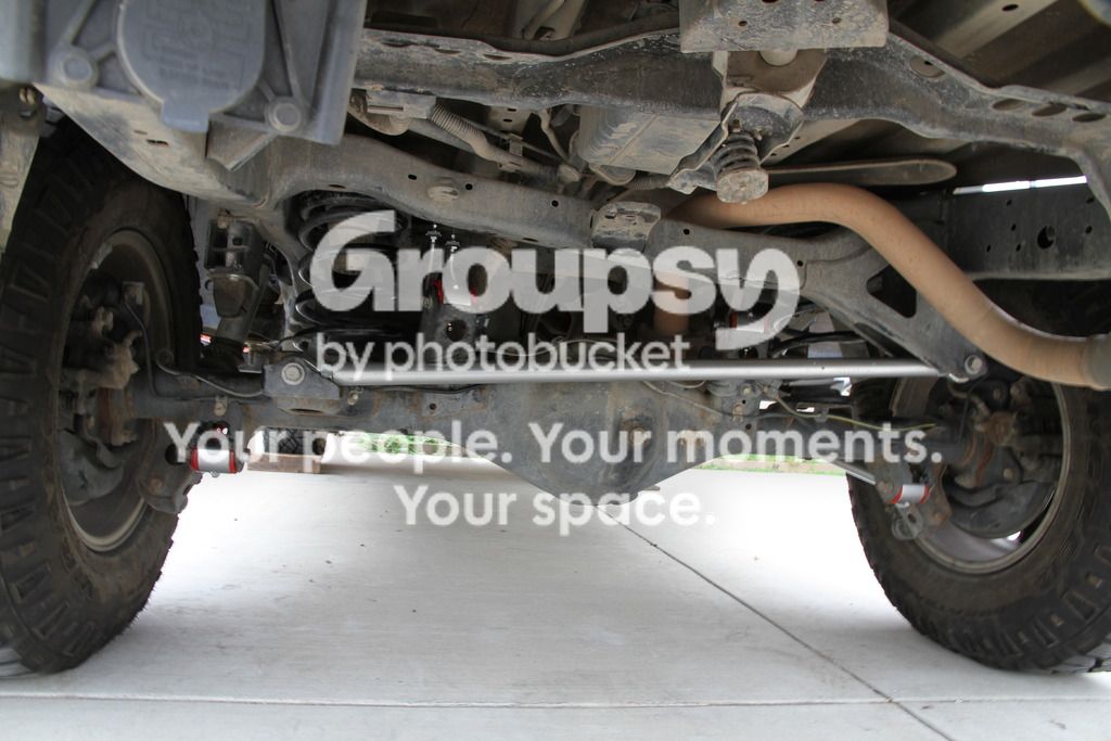

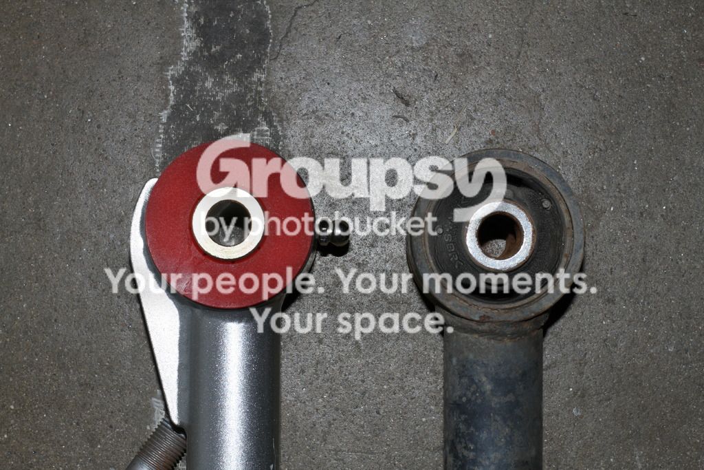

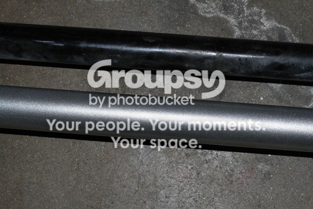

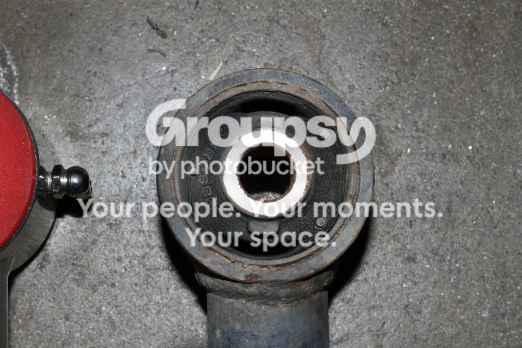

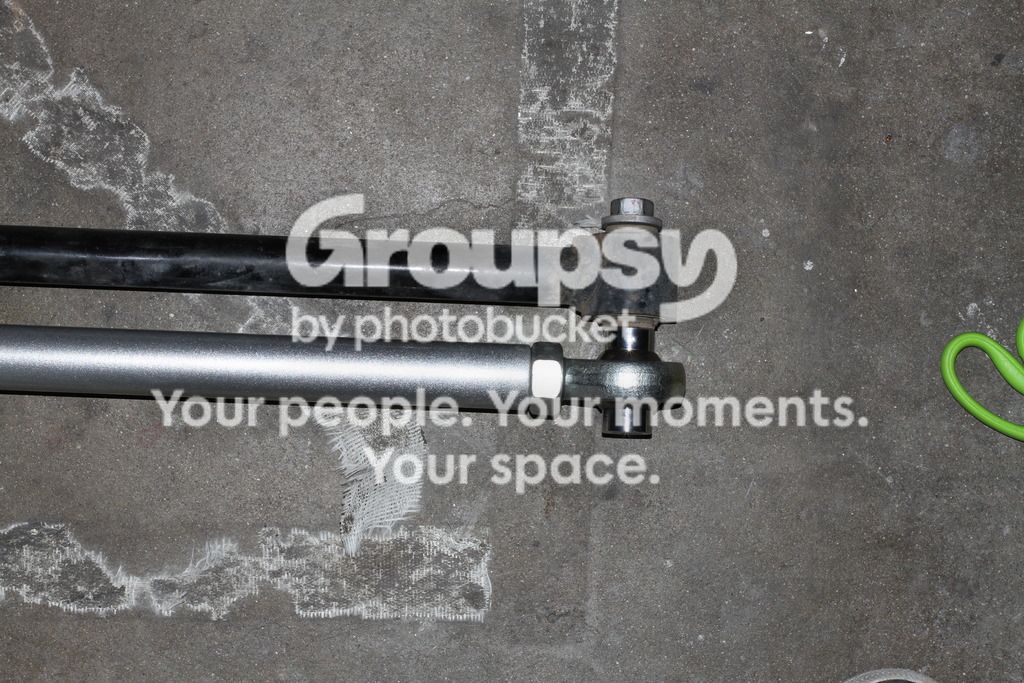

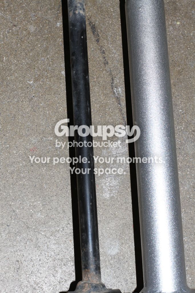

Installed Friday night, buttoned it up Saturday morning. I didn't really take measurements but I think the pictures show the big differences. My only issues were that I busted a zerk fitting on one lower arm and I had to force one of the upper arms into place. It wasn't an issue with the sleeve so much as it was that I didn't have things lined up right on the arm.
Couple things to note. I used the bolts and the original arms to line up the new arms to stock length. I forgot to tighten things down before I installed and had to drop the lateral bar to lock the nuts so make sure everything is tight before you install.
The brake line bracket bolts come out, but the nuts are welded to the stock arms, so you need to have a replacement bolt/nut combo or nut to match the stock bolt.
All bushings had grease in them evidenced by the grease I pumped in and got legit grease coming out. Looks like mobil 1 grease loaded in the bushings based on what came out.
1 zerk broke when I pulled my grease gun out, that sucked and I'll have to replace it eventually.
Otherwise it was a standard install and everything set up correctly and without issue.

Looks good, thanks for posting pics. We're the bolts loosely fitting into the sleeve. Because the eBay uca allowed 2mm of play with their sleeves. Just wanted to to pre price some sleeves.
I'd have to pull one off, but I don't remember any play in the sleeves when I was lining them up next to each other.
[MENTION=123332]Drunner97[/MENTION] looks so good!!! You should get a side shot from next to the rear wheel where that shiny beautiful new bar is running behind [emoji16][emoji16]
Not going to be shiny too much longer, I'm gearing up to go hiking and with the amount of rain we got last night the fire road on the way to the trailhead is going to be a muddy mess. Going to try to find a hill or too and check the flex out while I'm at it.
