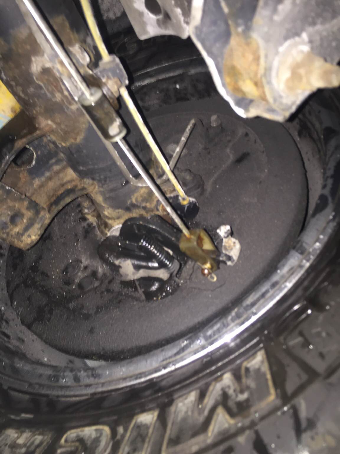

Behind the rear housing just outside the backing plate. You said your brakes were still grabbing so your cable is fine but something is not allowing it to release the tension. Usual culprit is the bell cranks. When you last drove it before it seized did you pull your emergency brake while it sat in 9 degree weather? Probably got wet and froze shut. I just took a picture of mine but its 85 here and I'm in surf shorts.

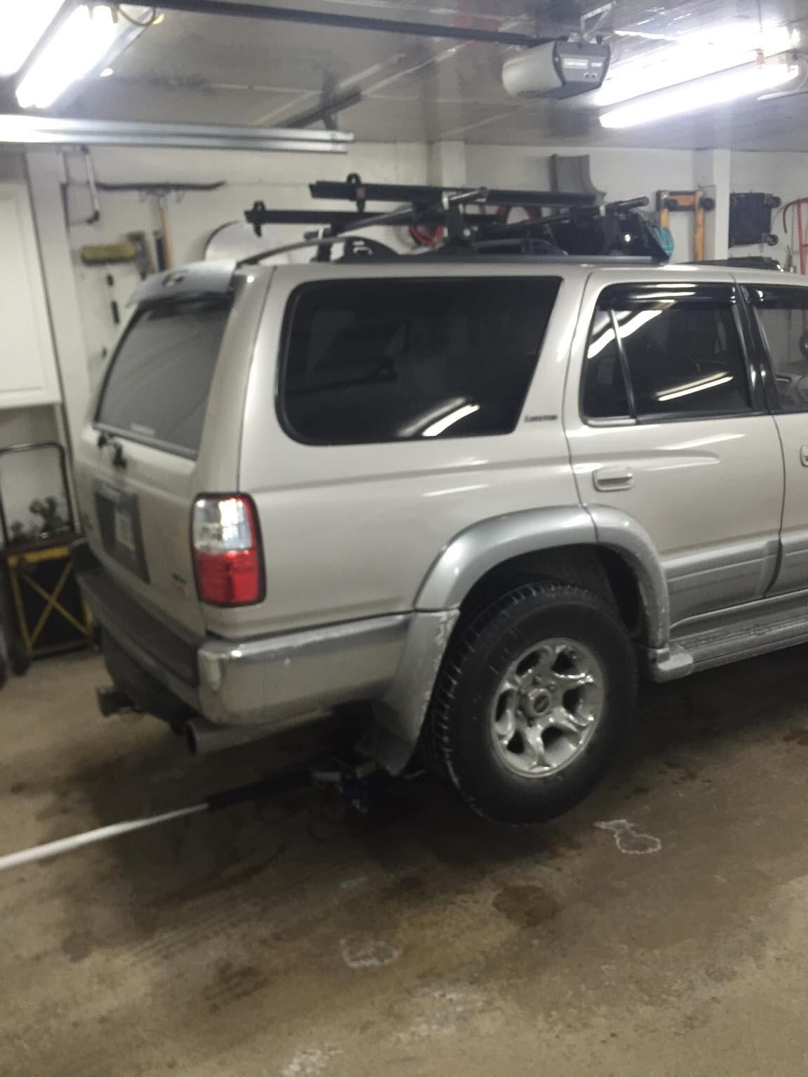

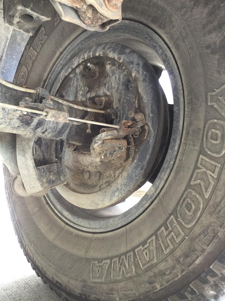

Ok, thanks again for the quick replies. I jacked it up, ran the propane heater to get garage up to 55° then sprayed the bell cranks and everything is back to normal. This truck is always garage kept, but I've learned my lesson to not touch that the e-brake when it's 9° outside sitting.
