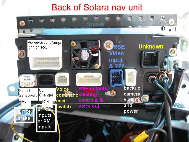

So I recently purchased an Eclipse BEC104 back-up camera for my 04 Solara Nav. I plugged it into the back of the Nav just to test it out before I run the wire to the back of the 4runner. Well, I get no video when I shift the transmission into reverse. Shouldn't I be getting a picture? Any thoughts to why I am not getting a video signal.

It's just a 4-pin plug that plugs into the back of the Nav. There are no separate ground, ++ or RCA wires. I didn't know there was an option for turning the camera on, though. Will have to try that out. thanks.

I added the same camera 2 months ago... i just plugs in. No need to ground, no wiring to do. I am guessing you NAV unit does not have the reverse wire hooked up correctly. Go into the DIAG screens and verify that it detects "reverse" correctly.
Had a bad connection at the tap connector on the reverse sensor wire. I think I will solder it in place instead of re-using the tap connector. Works great now.
