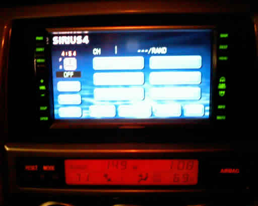

here's a picture of my head unit while in sirius mode for the IPC-106 from my Razr V3c. Not exactly a marketing product for motorola to use. I will try to find something clearer.

Here's the resopnse from Eclipse when I was complaining that it doesn't work right in CD Changer mode. It works much better now in Sirius:
Thank you for contacting Eclipse:
Go ahead and dicoonect the power and Ipod from the IPC-106, change the switches to A and B so you can use it under Sirius mode. Re-connect the power only, turn on the AVN5435 then plug in the ipod at the end.
Sirius 1 = Playlist
Sirius 2 = Artist
Sirius 3 = Album
Sirius 4 = Song
