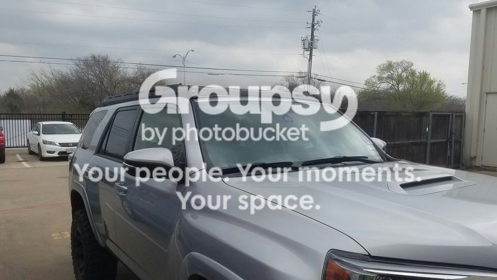

Is the the TFORCE package that was an option for SR5? I saw one at dealer and I liked the look. I have a Curtis basket with extension and it overlaps past the rails by a bit so I can get by without a full rack right now. The TFORCE stays on tho right? My basket gets taken off for mileage and noise concerns

Yep. I found a guy locally that was selling his and going full Gobi. I get some funny looks when I tell people at the dealership that it is a Trail Edition. The response is usually... "...sure..."

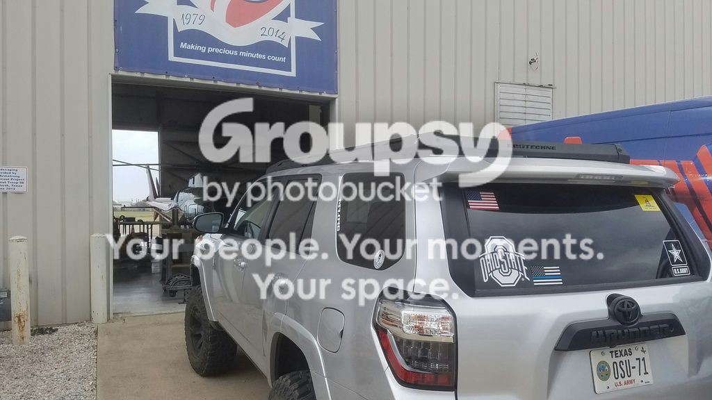

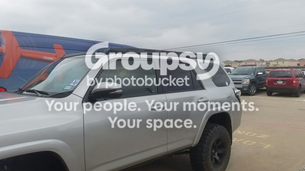

I love the look of the TForce rack, but it isn't adjustable or configurable. Right now I am getting some wind buffing noise on the sunroof because the rack redirects wind forward at highway speeds (65+). It isn't horrible, but it is annoying when I have the shade open and the stereo off.

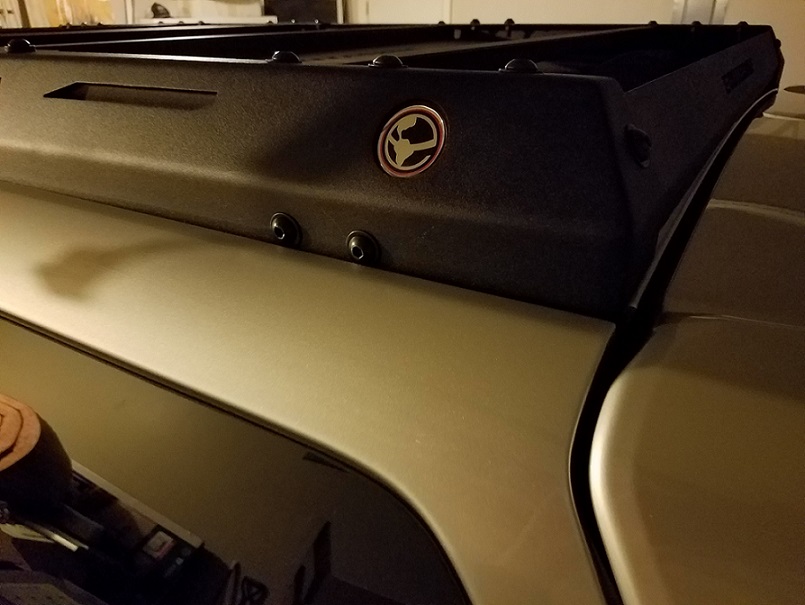

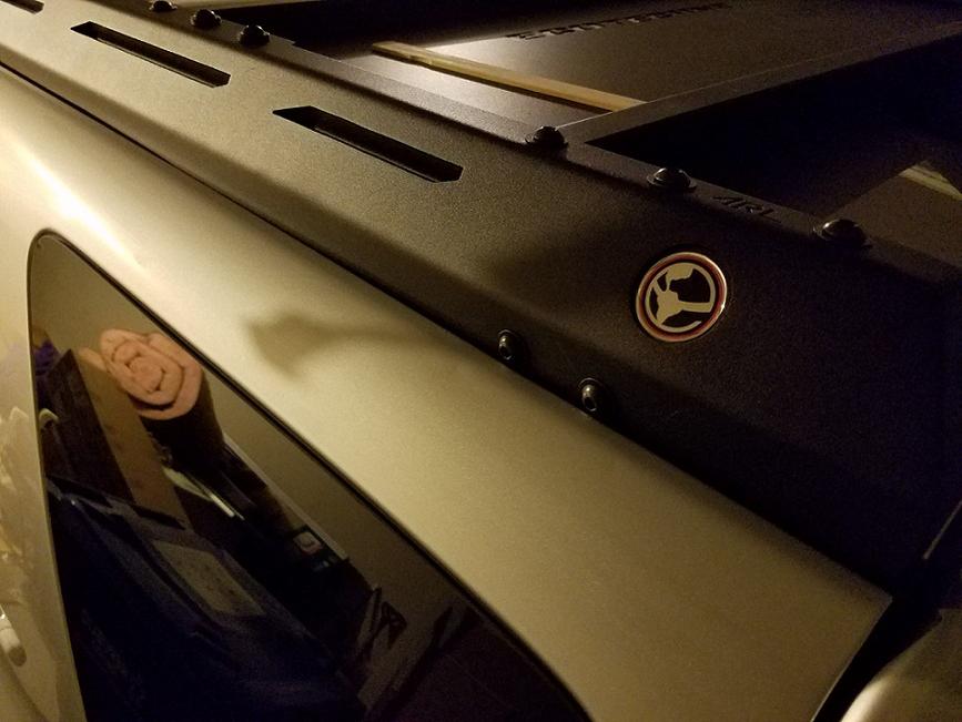

Finally got around to getting mine installed. I had some issues with the truck mounts, the holes that attach against the truck were in the radius of the mounts, not secure enough for me. I ended up replacing them by fabricating 4 new mounts out of 2" angle iron. The painted bolts were about half and half, so I ended up ordering the same hardware Quicksandpro recommended, they should be here in a few days. I also noticed one side rail was about 3/8" longer than the other, so I had to grind it down so they were the same length. It was more than I would want to do to something I purchase, but for the price and the look, I am still glad I decided to go with this.

That cinches it for me. It looks great but I don't have the time to mess with something I've purchased that much. More power to you guys though; it's definitely a good-looking rack!
Agreed. Seems the quality control isn't quite there yet. I love the look though. Price is great. But there are already posts about powder coating issues, not having mounting holes drilled on some brackets, missing hardware, and now needing to fab new brackets and grind down part of the rack because it was uneven.

I know others made them work with the mount brackets as is, I just wanted a better solution. I could have made them work and not modified any of it, but I am kind of anal about that stuff, its the helicopter mechanic in me. I do understand some may not have the equipment, skills or time to deal with these small issues, but I am still 100% satisfied for what I ended up with for the cost. The cost savings allowed me to get the SSO front bumper at the same time, which really justifies this decision. Plus I dont think there is a better looking rack on the market right now.

Also, just to share with you, the way I have this rack set up, I have no wind noise, and no vibration with my Sunroof opened or closed at any mph, and my wife and I can actually have a normal conversation. For this alone it's amazing, Interesting Aero-Dynamic design.
