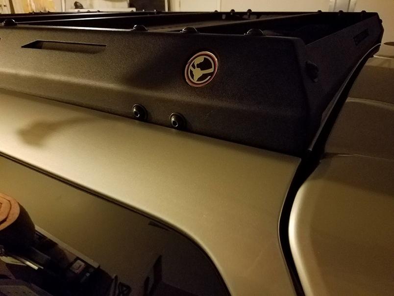

Weather got better so i snapped some pics.......Looks great from a distance. Up close you can see the different in the gaps from the passenger side and driver side. The gap on the passenger side front as well. The cuts and angles all could of been better. Once again I'm still for the most part happy I'm jus very anal about things being perfect and up close it does bother me. Once again thanks [MENTION=109477]Rorck[/MENTION] for all the help :hail:

Looks great!
The L brackets have room for adjustments so you can elevate the rack a bit or drop one of the sides.
Slotting the holes a little in each direction on the side rails helps a whole lot on trying to get it to be uniform side to side.
Got mine on tonight. Not terribly difficult but I did have to start with everything loose and tighten at the end.
