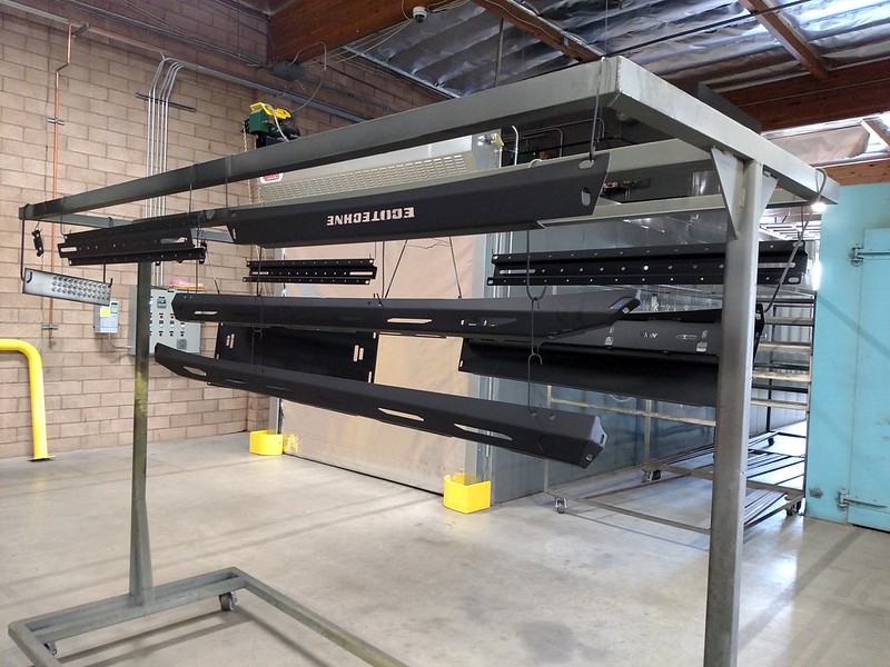

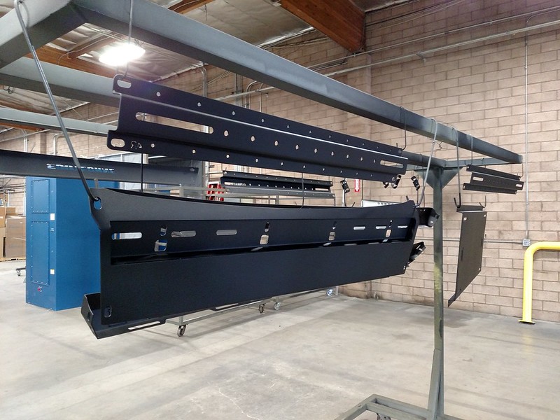

- I wouldn’t trust the powdercoat from the company itself. If they coated the parts just like I received them, I understand why rust is a huge problem for others. The parts are made of sheets of hot-rolled steel and were still covered in dark scale, which flakes off easily and allows rampant porosity to the base steel. I only saved $20 by forgoing their powdercoat, so I am inclined to think it’s not the best part of their work.

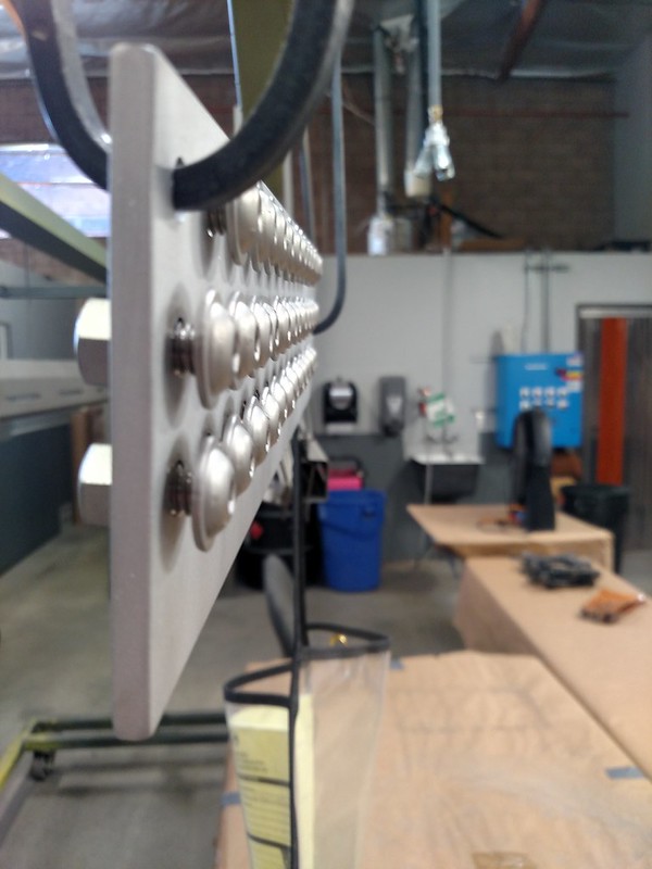

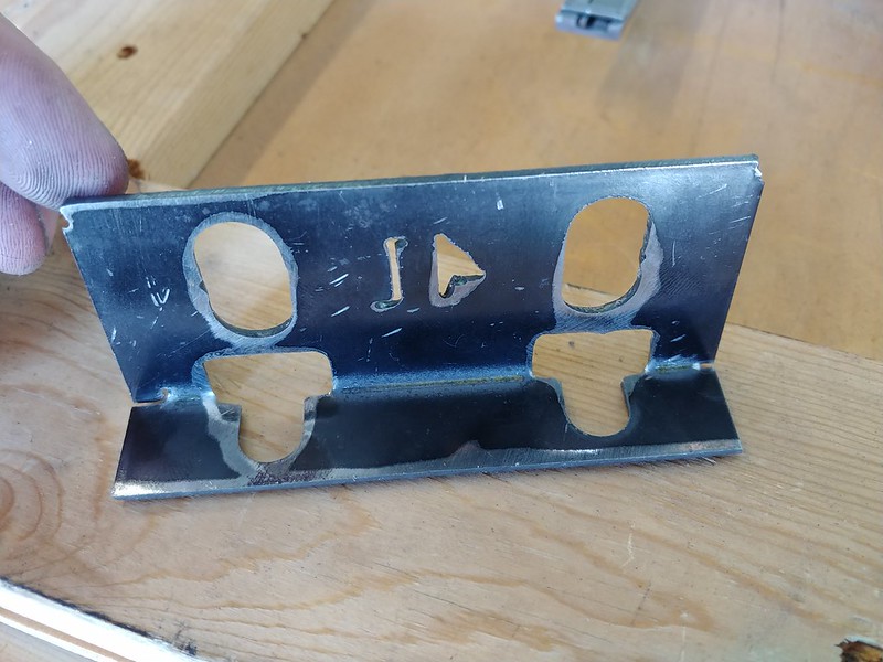

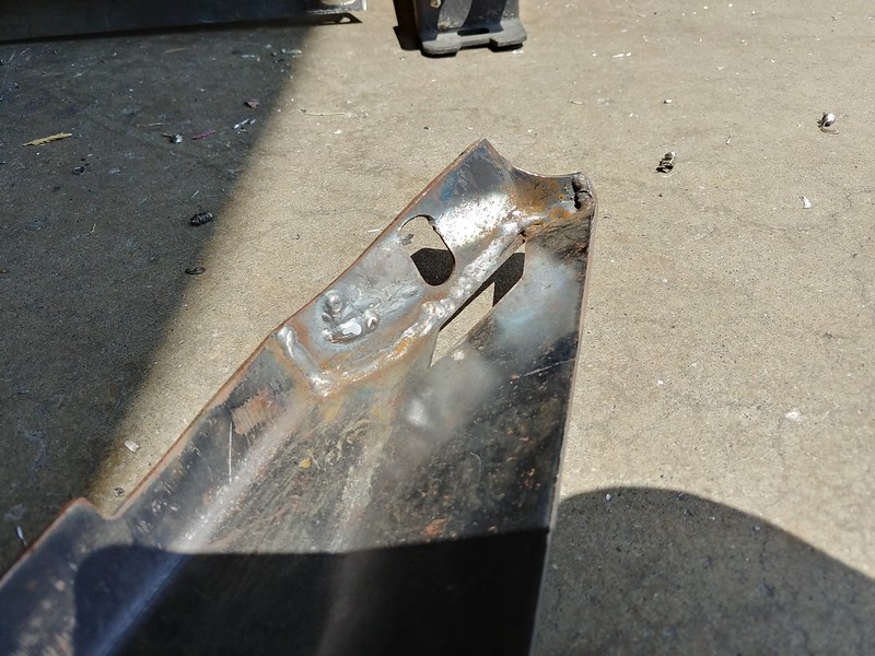

Here are some of the quirks that I mentioned above. The MIG welds are boogery in some spots; this one missed the fillet entirely in the corner.

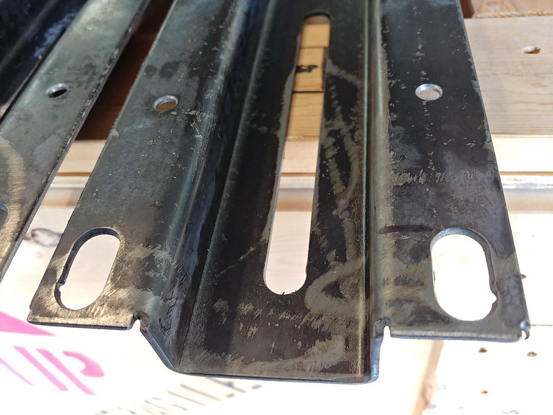

The edges and corners have cuts on them. The one furthest on the right is likely where the machine started cutting the part, and the other ones are added so that the metal won’t crimp or crack during brake-bending.

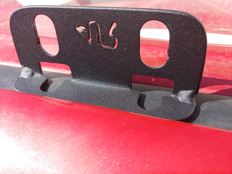

Here is an example of how I “fixed” one of the brackets. Again, the cuts in the bend corner are not cracks; they are intentionally cut as crimp reliefs during bending. But since I don’t want them becoming stress-risers and cracking later I rounded off the corners and TIG welded the reliefs. This may not be totally necessary, but I wanted all of these to be very robust.
Also, you may want to check all of your brackets for equal bend angle. They are not perfectly 90 degrees; they’re a little more like 100°. One of mine was over-bent, so I tweaked it back to match the others.
I mentioned rough edges earlier, they are EVERYWHERE on these parts. I want to be able to grab my rack and pull myself up without cutting my hands. I set the parts up on sawhorses and attacked them with a dull flap wheel on a cheap harbor Freight grinder, smoothing down sharp edges and grinding off excess weld spatter. Now my parts look smooth and uniform.

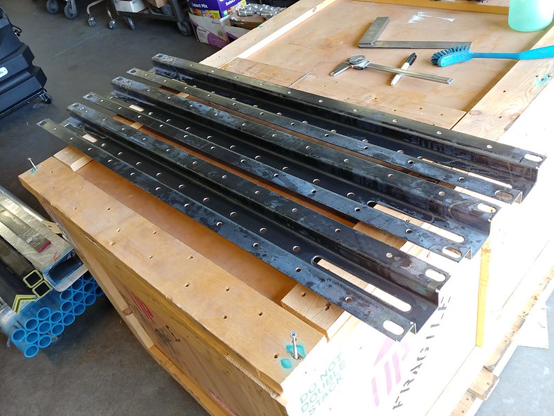

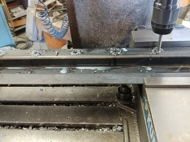

One of the other weaknesses is the difficulty of adding new parts. I wanted to be able to attach stuff in the future without drilling holes through the powdercoat, so I drilled them ahead of time. I set them up on a Bridgeport and drilled 9/32” holes on the top faces, arranged in 3.5” squares, and 13/32” holes every 3 inches along the bottom face. Each series of holes was started in the center of the part and then moved outward to the next. These parts have pretty terrible tolerances, but any capable machining shop should be able to do this if you’re so inclined. Basically, I can make mounting accessories in the future and attach them with ¼” or 3/8” hardware.
After the parts were massaged, I did some quick fit checks on the truck to make sure everything looked right. Actually, I should have done this FIRST. It would suck to do a bunch of work and then find out they’re the wrong parts, or that some are missing or don’t fit. Everything looked straight and fit together well.
After this work, I was pretty satisfied with how the parts were coming out. Now they were ready for sandblast and powdercoat. This is where I believe EcoTechne should do the most improvement. I sent my parts to Andrews Powder Coating in Chatsworth, and they did a phenomenal job. Notice here why I chose bolts with integrated washers: I had them coated at the same time and they are a lot less complicated to coat and assemble later. Honestly, the bolts could just be spray-painted with a similar black, since they are stainless and won’t rust. But if you are sending all the parts for coating, you may as well do the bolt heads too. Andrews sandblasted the parts down to fresh clean metal. After that, they performed a two-stage process with a zinc-epoxy base coat and a micro-texture flat black top coat. This ensures that the coating is super durable and resistant to rust.

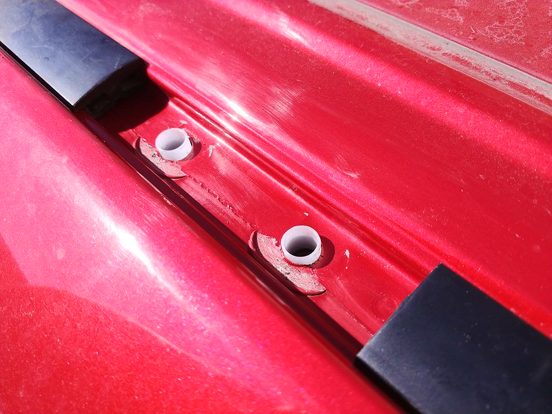

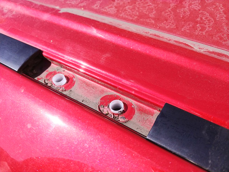

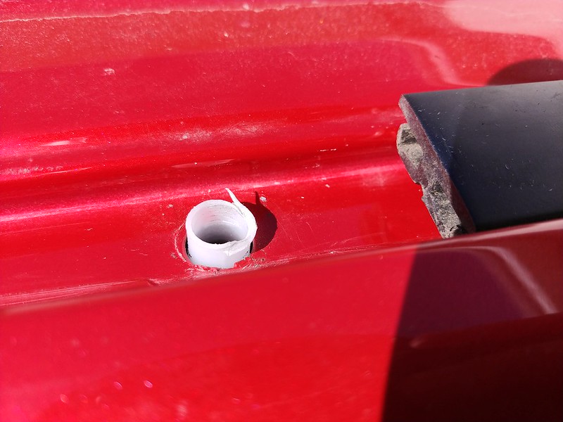

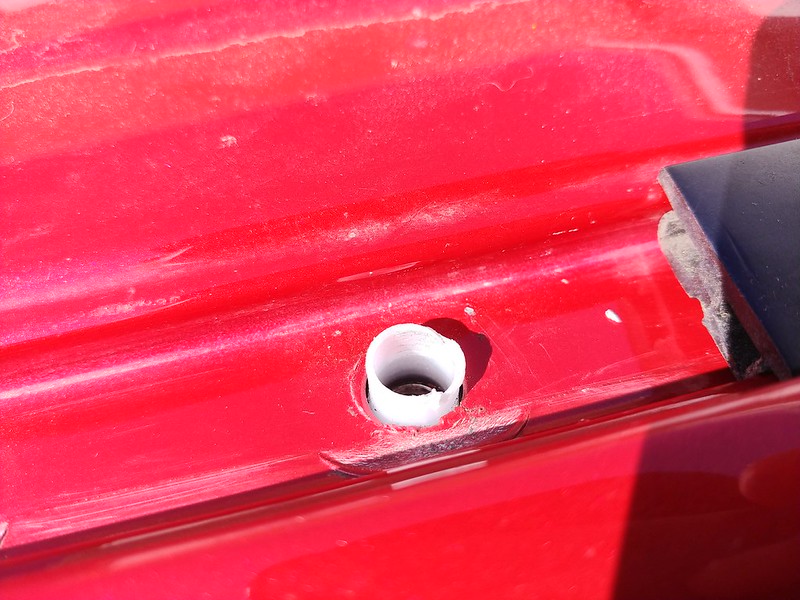

After you take off the stock rack, you’ll look at something like this at all 4 corners. Clean it up well with isopropyl alcohol (rubbing alcohol). Go ahead and clean a bit under the weatherstripping too, it’ll probably be the last time you’re here for a while.
Good. Also, if you have any deformed tubes like mine, trim them with a razor to make them clean and straight. I messed this one up while playing around with different hardware and testing sealants.

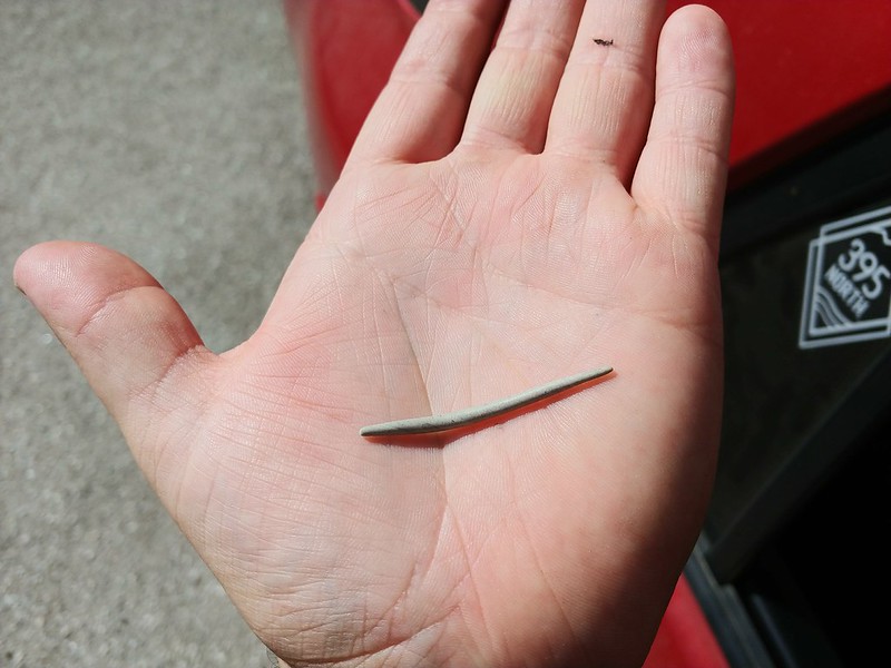

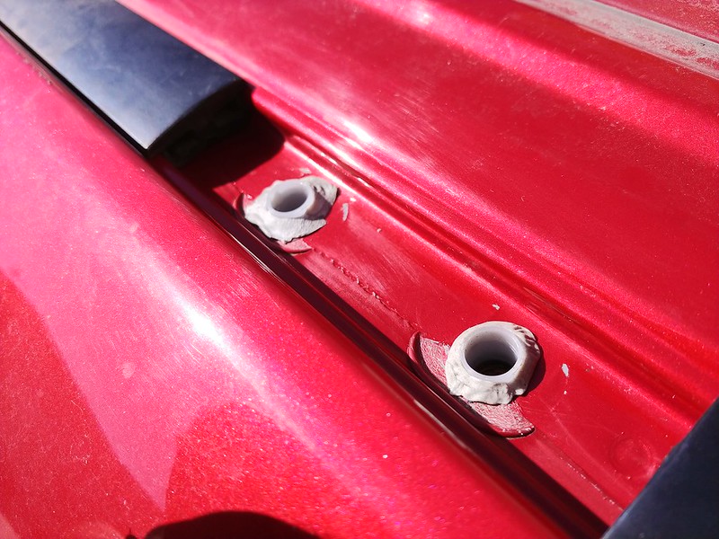

Ok! Now we need to make sure water can’t leak in around the tubes. At first, I tried butyl rubber tape exclusively for this, but it just squished out like toothpaste during tightening. Butyl rubber is a great sealant; it stays tacky and pliant for decades. OEMs use it to seal windshields, headlights, etc. But using it by itself isn’t the right application here, especially with the tubes sticking out of the roof. It deforms too easily and lets the tubes get crushed, it’s basically like Play-Doh. By the way, here is the sealant I ordered.
Butyl tape
It can be butyl tape from pretty much anywhere though. Sorry you have to order so much and use so little. Remember making snakes in arts and crafts? You get the idea. By the way, butyl rubber is also nice because it doesn’t glue into place. If you mess up, you can try again. And you can go back to stock if you don’t like the rack.
Basically you’ll want to squish it around each tube and create a little fillet. It will get squeezed into place in the next step. Get the 3/8” silicone washers and snug them around the tubes. They have an ID of 0.355” (tubes are about 0.375”), so they are another layer of protection against water intrusion.

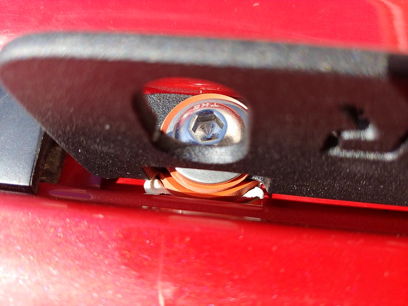

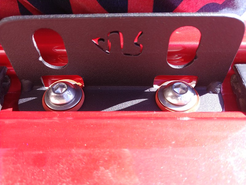

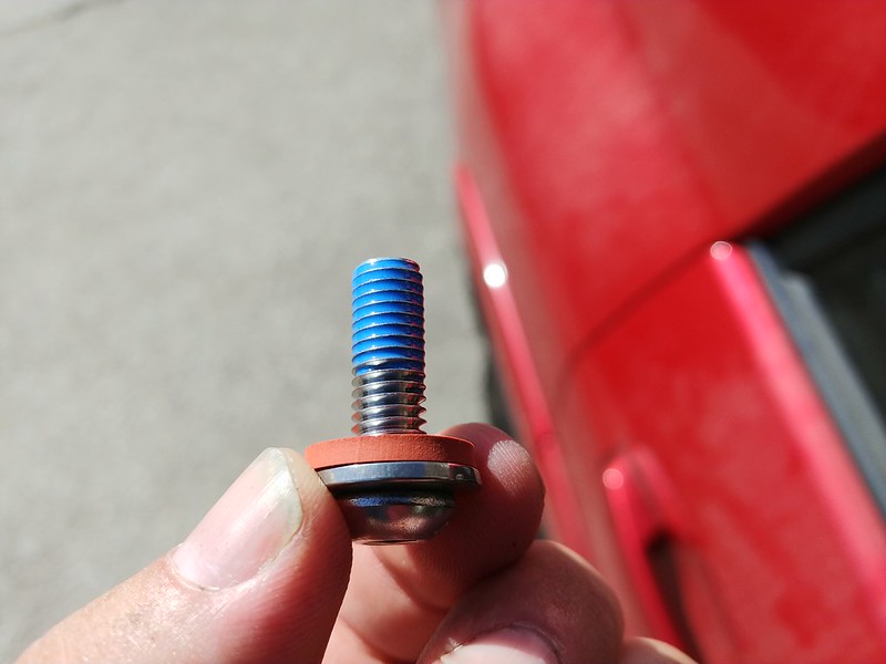

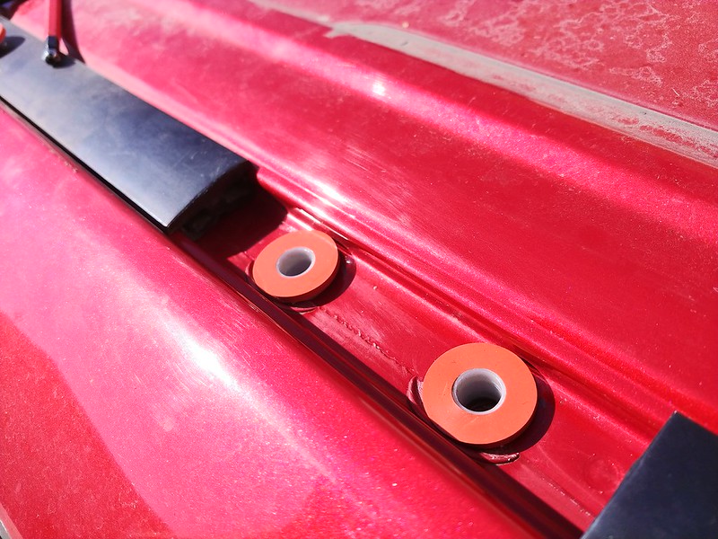

Now you’re ready for the bolts. Take your M8 bolts and add the Bellevue washer (cup downward, facing the threads). Then, twist on your 5/16” silicone washers. I know that these are for standard bolts, but 8mm is nearly the exact same size as 5/16” (0.315 vs 0.313). The washers are snug at 0.290, so you actually can thread them on until they are snug against the cup washer. This is our third method of protecting the interior from water, and a healthy application of blue Loctite (242) is the fourth and final. This is more of a means of keeping the bolts from moving, but it also acts a mild sealant just in case water makes it past the rubber washers.
Now, this is why I selected the cup washers: As the bolts are tightened, they squish the silicone washers into shape and basically fill the entire space under the bolt head. This ensures that the threads are also squeezed very tightly, preventing water intrusion through the threads.
I tightened each one until I started to see the smaller rubber washers squish out the sides, then a little bit more. The brackets are now very snug, but the firm silicone pieces should help damp any rattling or vibration from the rack. The top washer is also sealing the top of the plastic tubes, and hopefully not deforming them.
Here is another view from the top. You can see how the two silicone washers snug against each other, even over the irregularly shaped hole. You can also see some of the butyl rubber extruding out from under the bigger washer. Hopefully most of it is still doing its job, squished into the space around the plastic tubes.

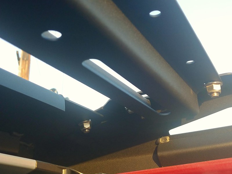

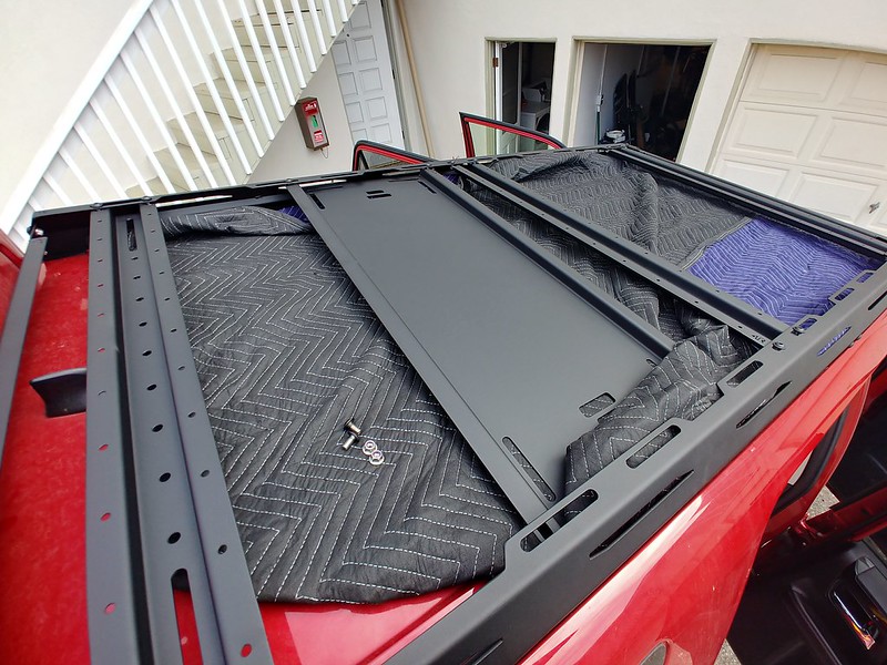

Now you can add the side rails, using the 3/8” hardware. You don’t have to buy the bolts and nuts with the integrated washers, but they do look nice and are easier to install. I recommend that no matter what, you get hardware with 3/4” thread length. That’s enough to put two pieces together, engage all of the nut threads, and have a little bit of thread tail hanging out. Assemble things loosely at first. I put a couple of moving blankets on top of the truck so I could put the pieces down until they were ready to bolt in. It helps to have another person with you, but I did these myself slowly. Everything goes INSIDE/UNDER the side rails.
If you have anything that you want to check for crossbar spacing, do it now. For example, I’m going to haul snowboards up front, so my crossbars are spaced out for when I eventually order rack mounts.
See what I mean about the bolt tails? They look much nicer if there isn’t a huge amount of threads poking out the back end.

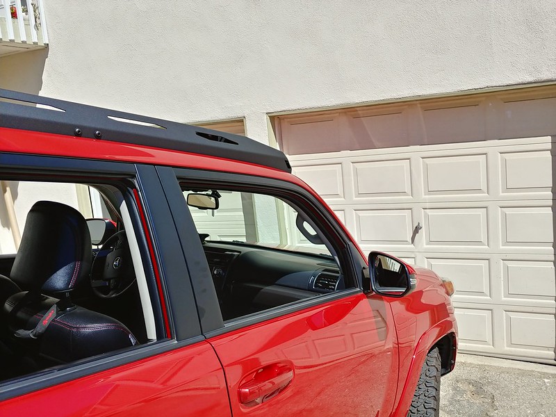

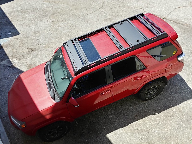

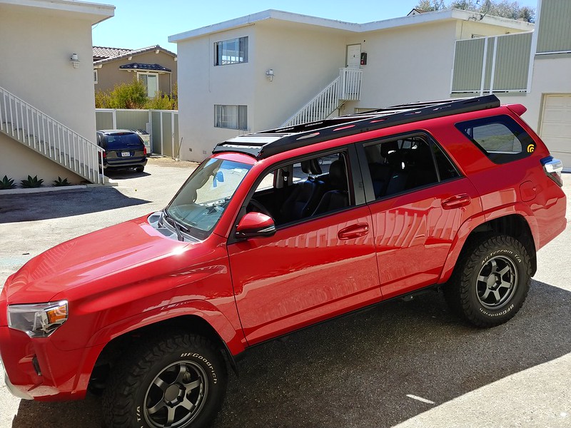

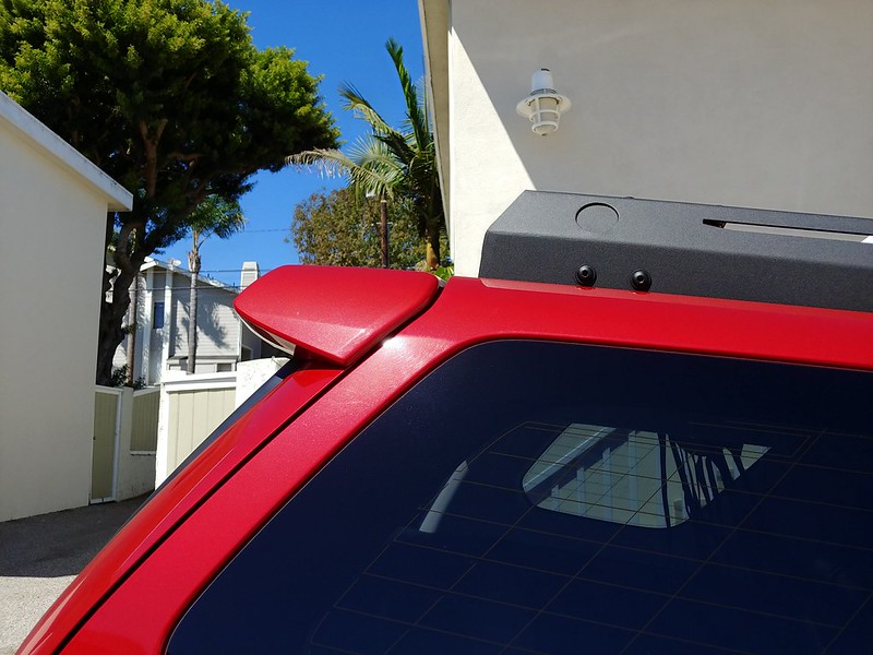

This is pretty much done, and looking nice.
You can see what I mean about this rack’s design being complementary. The front end of the rail mimics the geometry of the A-pillar, while the rear shape continues the same line as the hatch cut. The rack is actually kind of tough to spot at first, which is why I like it so much. It blends in well with the design of the 4Runner.
I took it to the car wash today and didn’t see any water in the headliner. I will update this thread with any long term rain or snow events, to see if my seals are working as intended.

Just curious, how much was powder coating?
I would shop around and get a few quotes in your area, most can do an accurate quote if you send them pictures. Blasting and single stage should cost around $200-300, and a good blast/dual stage is more like $400-600. The closest shop to me quoted $850 and didn't seem very knowledgeable, so make sure you shop around for the best value! Either style you select will be miles ahead of the coatings from EcoTechne I've seen in others' pictures. Most shops will tell you that the prep work (blasting and cleaning) is the most important part of the job.

Rather than selling it for cheap, I recommend giving some business to your local powdercoater!

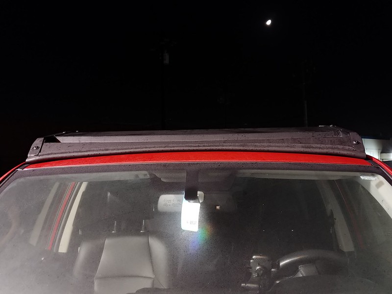

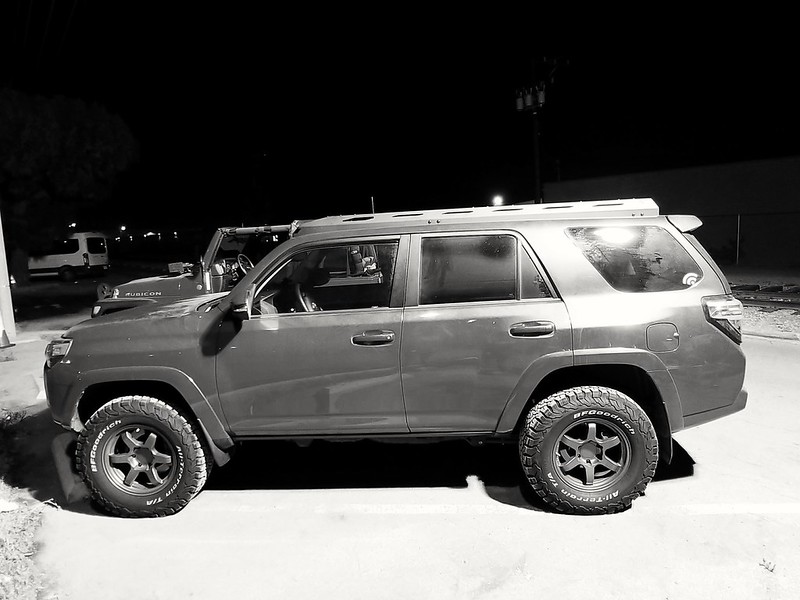

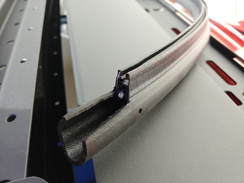

So this weekend I visited my best friend in Simi Valley, a round trip of about 100 freeway miles. I had sliders strapped to the roof of the truck on the way there (on the front of the rack actually), and bolted in place for the drive home.
I averaged 19.6 MPG, driving about 65-70mph. This is even with 275/70 KO2 tires. The best freeway average I'd been getting before the rack was about 20.5, and I'd bet I could squeak out an even 20 again if I tried. All of these measurements were at the pump, not using the MPG display.

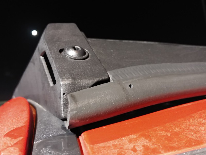

I think a real difference-maker was this rubber bulb seal on the front fairing. I didn't get a chance to do any MPG testing before it was installed, but the difference in wind noise is very noticeable! I can hardly hear any noise from the rack at all. Opening the sunroof on the freeway used to be deafening, now it's nearly as quiet as stock. HUGE difference.
Here is the part: 12335a25
The minimum order is 10 feet.
You can see that the bulb seal is offset to one side, I placed it on the fairing edge with the bump facing down. It's not a perfect fit, there's a little gap on each corner- but it's close enough. It has a spiral wire core in the pinch, so I put it in a bench vise and used a hacksaw to cut it. Using a razor, I also cut some reliefs on each side of the bulb so that it could extend to each corner.
Super happy with how it turned out, and the MPG/noise hit is almost negligible.

Hey Tory, I got the rubber stripping. Did you use any adhesive or anything to keep it on or does the grooved slot hold it onto the leading edge of the rack?
The weatherstripping grooves or teeth are designed to grip the edge tightly. Installed by itself and holds on great.
