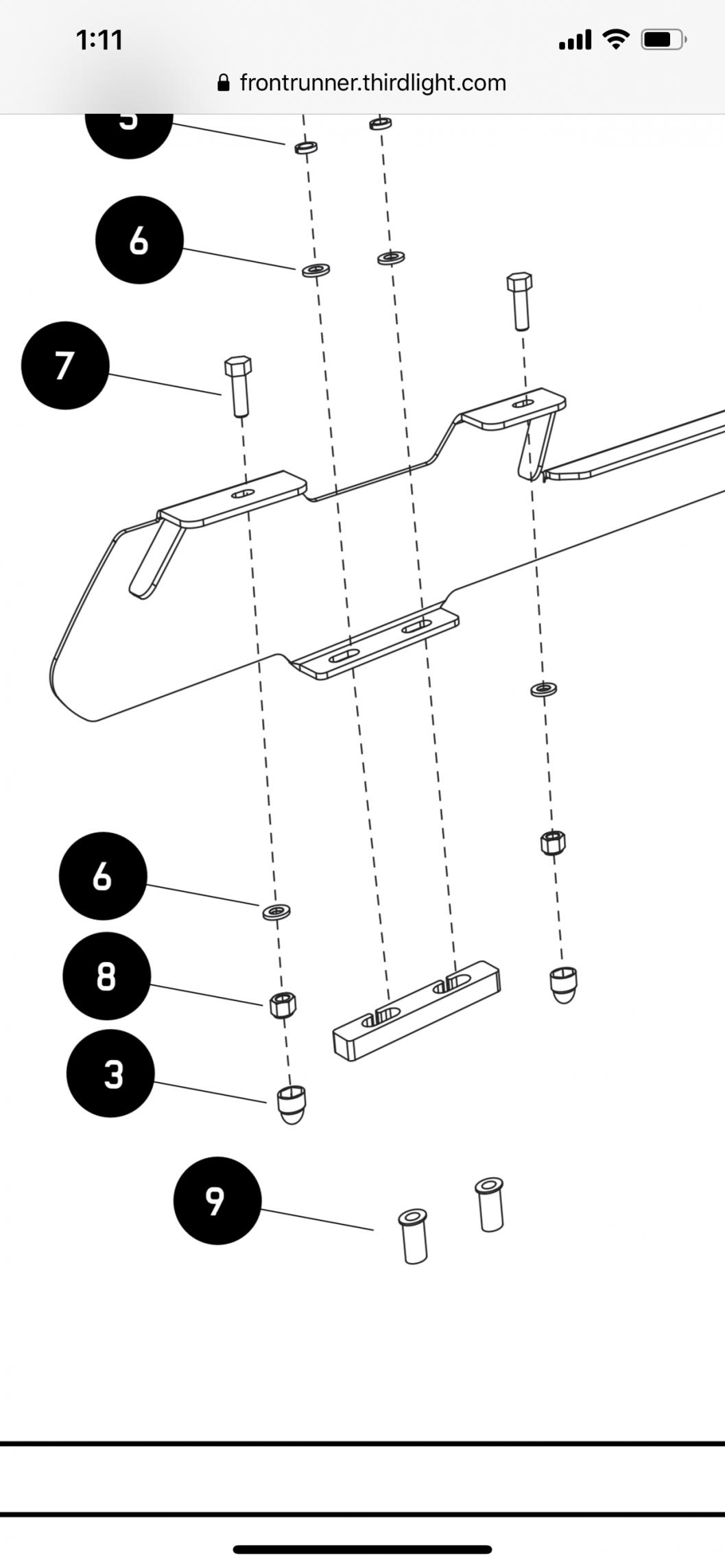

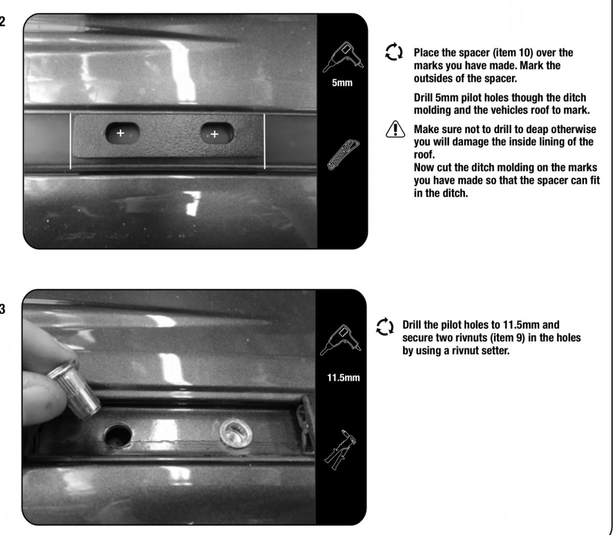

Can you take some pictures of the mounting feet and hardware?
Not of mine since it’s installed, but here’s some from the instructions.

So, I did not realize that Frontrunner racks have plastic spacers at the feet. Tried using the butyl tape and washers anyway and it was not good. The spacers don’t press against the washers evenly. Had to take the siderails off again and remove all the butyl tape and use silicone the next time. No other option really.
Not recommended for Frontrunner.
I’m not implying you suggested it would be, I should have investigated more before ordering $60 worth of supplies. Oh well.
I did end up using the metal washers though! Haha
For your plastic spacers, I still would have used the butyl tape but instead of the silicone washers, I would have bought a sheet of high temp silicone and cut gaskets that sit between the roof and the spacer.
So, lay a string of butyl down around the OEM spacer like mynameistory did in his pictures, then I'd lay a bunch more strips on the roof on the contact patch of the spacer/silicone gasket. Specifically, I'd make sure the perimeter of the silicone gasket has butyl around it.
So, lay down butyl, then 0.125" silicone gasket you cut to size, then your spacer.
edit: this is what I bought to put under my plastic spacers: Red Silicone Rubber Sheet Roll High Temperature Thick Commercial Grade 8" x 8" x 0.12": Amazon.ca: Tools & Home Improvement
