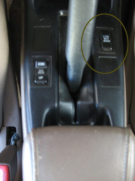

My ECT Power indicator light just came on. Does anyone know what that is and what needs to be done for it to be cleared. Any help would be much appreciated.

Your ect light isn't a bad thing. What year do you own? Ect is a button you can push to allow your 4runner to hold it's gear for longer and at higher rpm's. If you have a 2nd hen then it should be behind your automatic shifter and have a green stripe across it. You use it when you need te extra power like going uphills, towing and merging/passing.
Thanks, this helped me out. I thought it was randomly coming on and going off.....I have the ebrake area filled with CDs and I've been driving my '98 for over a year without realizing....must've kept hitting the button. Would this cause more or less gas to be used (while in ECT mode)?
you'll use more gas when using ECT, it extends the shift points causing you to have higher RPMs before shifting. It's useful for towing or passing as you can get a little bit better acceleration.

ECT isn't a mode. It stands for Electronically Controlled Transmission.
The switch has a POWER position and NORMAL position.
In the POWER position the trans shift points and Torque Converter lock-up occur later. The engine winds out longer, resulting in more power/quicker acceleration.
In the NORMAL position, the quicker shift points and earlier TC lock-up result in better MPG.
