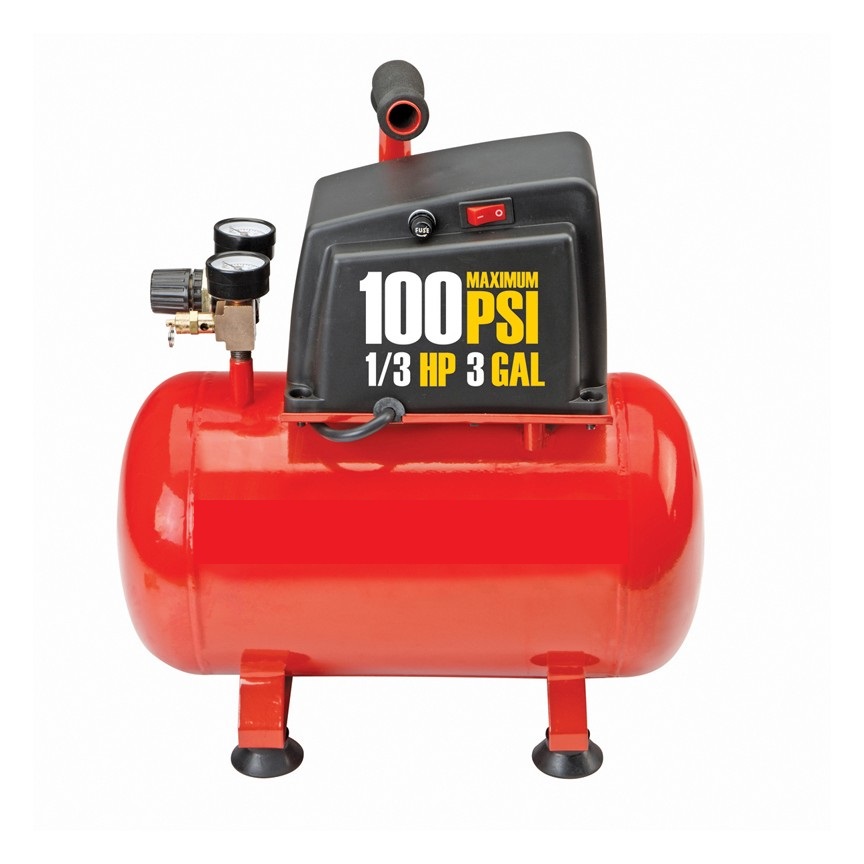

So what are the specs on your current air compressor? Is it something like this...see pic below.
That's what I started out with (except it had a Coleman name on it)...ok for car tires, but on the 4runner, it probably would burn itself out airing up just one tire.
Then I got a 10gal, 1.5hp, 150psi max oil-less unit...no problems. Don't remember CFM or have a picture (sorry).
