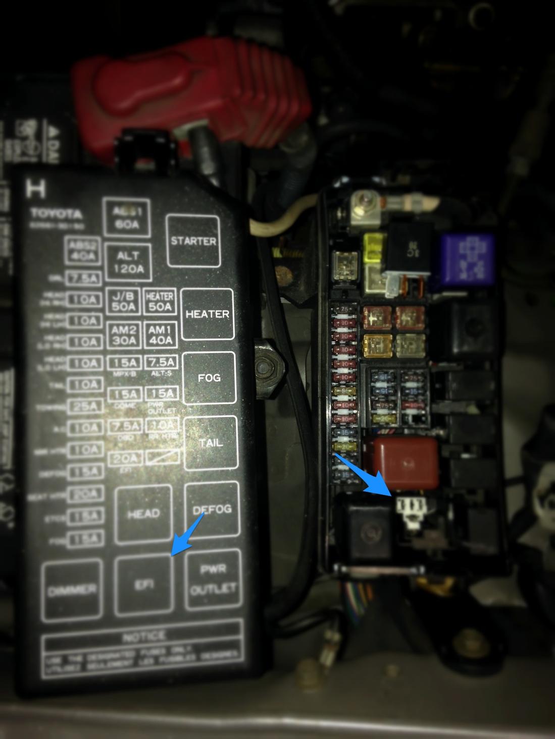

I want a picture of exactly what I need to unplug, circled in red or pointed out, if possible. The last thing I want to do is sabotage my vehicle when it already needs some work. I get about 16 mpg highway with 265/75/16 ATs.

Go look in the fuse box under the hood. Pull the cover off and then look at the diagram on the cover and find the one labeled EFI then pull out the corresponding relay for about 30 mins. Relays are the solid black block looking objects. Put it back in and you're good to go. About as simple as it gets

A) There are 2 EFI labels, not one. One is large and on the bottom right of the box, while the other is smaller, and on the left side more towards the middle.
B) The guide calls it a relay, but you call it a fuse. Which one is it?
I'll edit in a sec for a picture of mine.

I re-edited my post but I think you had already quoted me before I did. I read back through and realized I said fuse and not relay, the fuses are the multicolored smaller ones. The relay is the large black box shaped one. That's the one you want to pull. Pull it out and come back in 30 mins and put it back in and you're good to go. You probably won't notice any difference until your 2nd tank, you may not even notice a difference at all.

This sucker will not come out. I feel like I'm going to break it if I keep pulling on, but I don't see a clip anywhere.
Do I just need to man-up on this one, or is there a clip that I'm about to break?
Edit: Nevermind, I got it with some pliers. There's no clip, it's just in there pretty good.

Here is a picture of my 2001 Limited Fuse box
As far as I know, on our trucks, you can just pull the EFI fuse. No need to pull the relay. In fact, just the relay won't work. The point is to cut power to the ECU and force it to re-learn its settings. The volatile memory power bypasses the relay.
