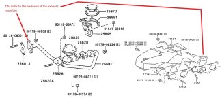

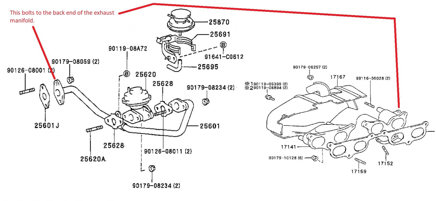

The 4-cylinder Gen 3 models, 3RZ-FE engine, have an EGR. Or at least the ones sold in North America do.
As a side note, the nearly identical 2RZ-Fe engine, 2.4 liters, used in 2WD Tacomas, did not have an EGR.
Possibly if a manufacturer is selling a header that fits both the 2RZ and the 3RZ it's necessary to distinguish 2 different headers. Or maybe 3RZ engine in some markets don't use an EGR.

The EGR version only pertains to some 3.4L Tacomas that did come with an EGR valve. You'd see on the stock exhaust manifold a pipe that goes up to the intake and pumps exhaust back into the intake. As long as you don't have that you are good.

The easy way, on the V6 5VZ-FE, is to look at the top of the throttle body. Those mystery little elbow pipes with the rubber caps are for connection to the non-existent EGR. If it IS connected, then you won the lottery. AFAIK, when the 5VZ-FE was updated to OBDII, the EGR was eliminated. Thus all EGR 5VZ-FEs are from 1995 or earlier, and thus no 3G 4Runners.
