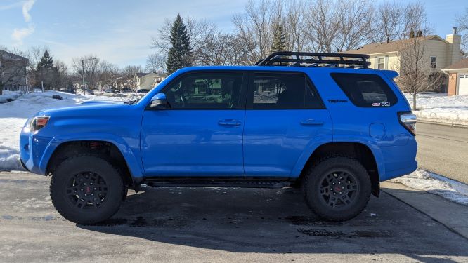

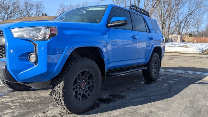

Just got mine swapped today, really pleased with how it came out, the ride quality and the height so far. Also, and I'm not saying this is a fix, but I had zero clunking from the shocks on the way back from the shop, despite having it on the way there. YMMV
