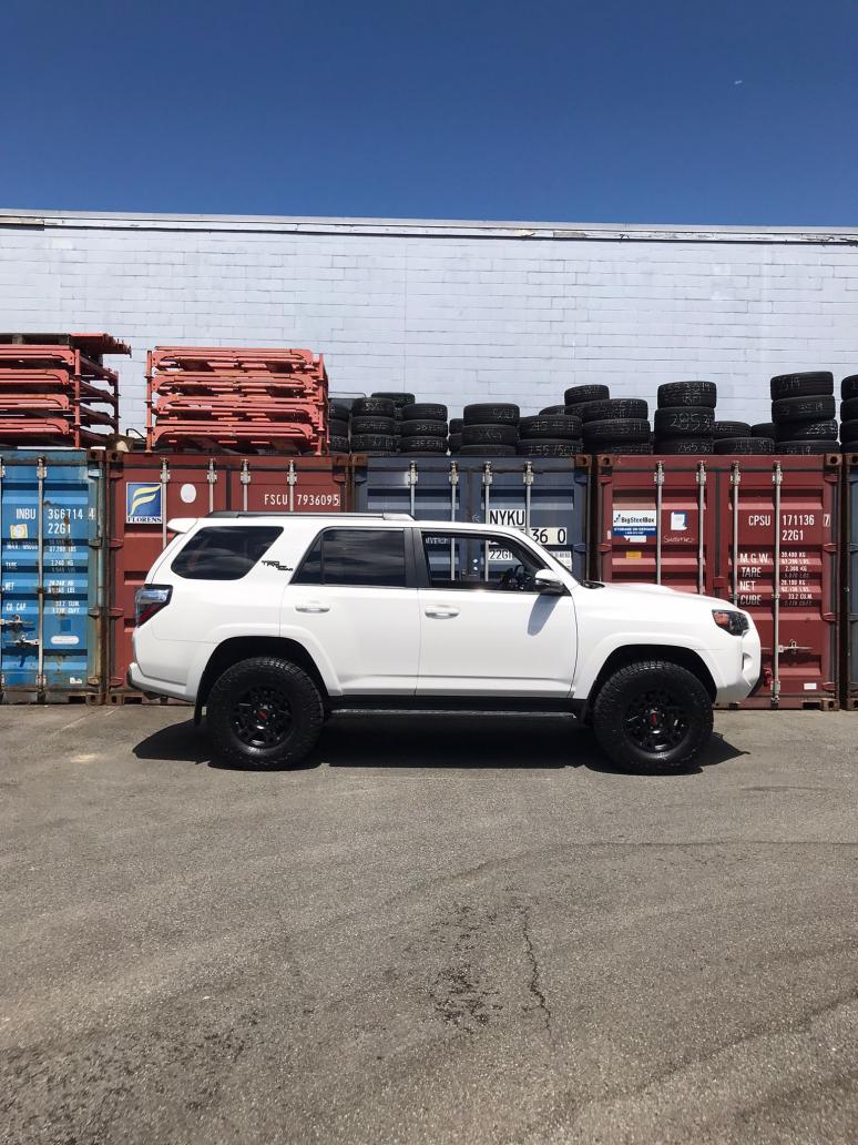

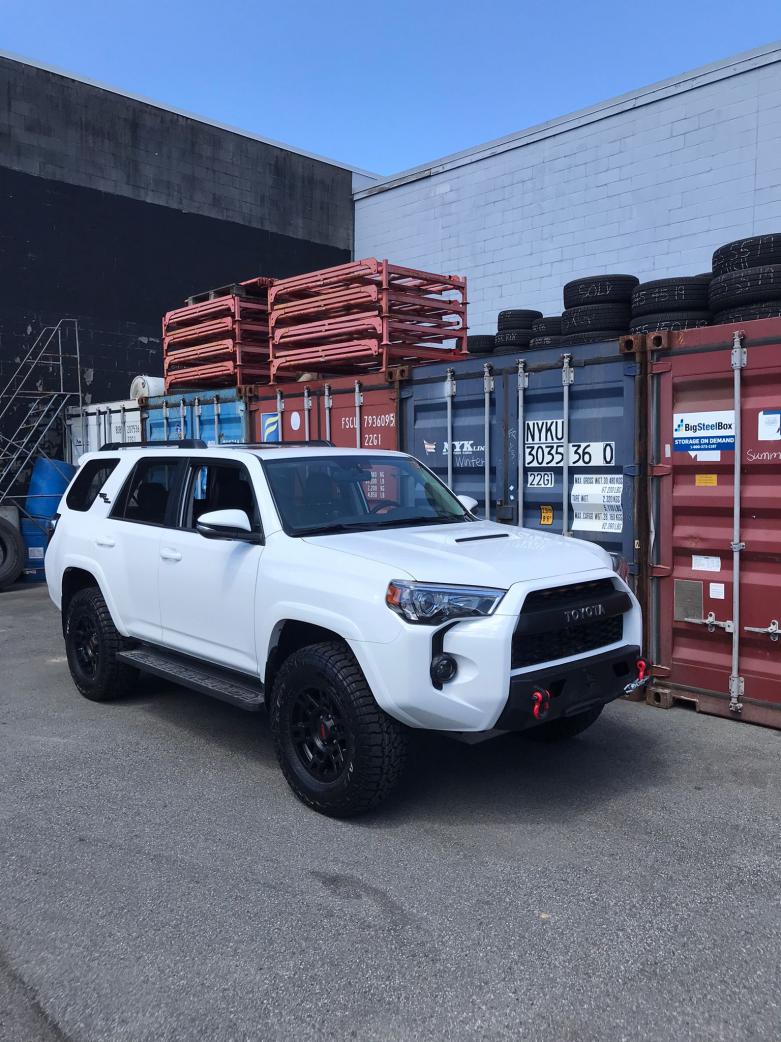

Finally got the springs and installed them today; added some 285 wildpeaks for good measure!

No UCA's. No trimming of any kind. All I did was add the springs, then the 285’s, went for an alignment and then remove the spacers because it was rubbing. They were able to get 2.4* for caster. Toe and camber were in spec. It drives straighter than it did from the showroom. I’m very happy with how it turned out. No idea if it will need trimming once I see it flex off road.

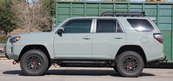

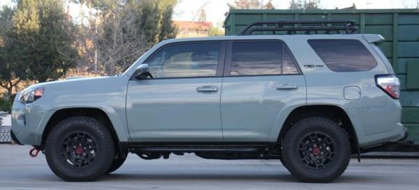

Let the front spring development begin! I'm kick starting this project for you guys myself.
I need your stock 2018+ Pro for a full day to measure in the next few weeks. Once the prototypes are complete I'll bring it back in and leave a set on your rig for free.
Who's in?
