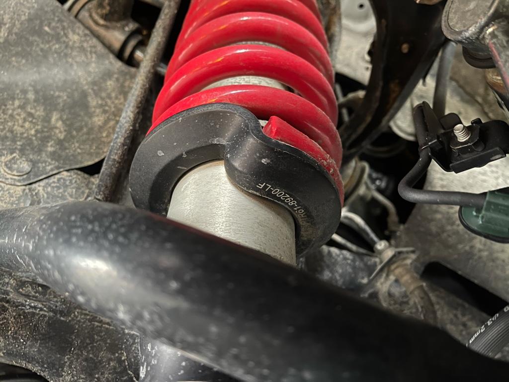

Hey Mark, I took a look the other day and didn’t see any numbers stamped on the springs or shock individually, but I did see a part number stamped on the lower spring perch. The part number matches that found in the tsb. Here are photos of the dealer repair order and the part number found on the front driver side assembly. Please let me know if there are any other places I should look to find a part number.
That's helpful, thank you.
Unfortunately, this part number does NOT match the 2020 Tacoma which is PTR61-35201. That doesn't mean the dimensions aren't the same, but without any part numbers on the springs themselves it requires having something in hand to measure.
