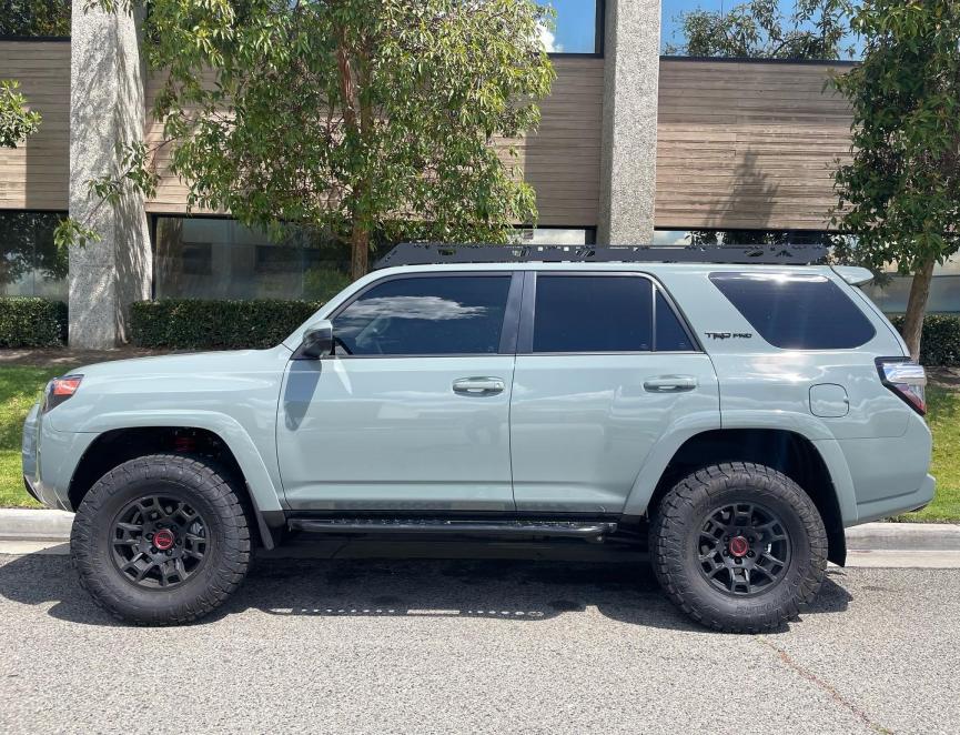

Eibach needs a stock TRD PRO in SoCal
I've only had it a week, but I'll do some measurements soon. I don't have any rubbing with normal on-road driving so far and I don't think they did any additional modifications when installing, other than mud flat removal.
That looks great. I have the exact same truck and will be getting these springs installed with Toyo open country at3 285's. Do you have lift height numbers after the springs settled? Also besides removing the front mud flap are you getting a new rubbing or did you do additional trimming?
The lift heights are in line with the advertised numbers from Eibach. When measuring as best as I could to the center of the hub I have +1 9/16 in the front and +1 1/8 in the rear.
