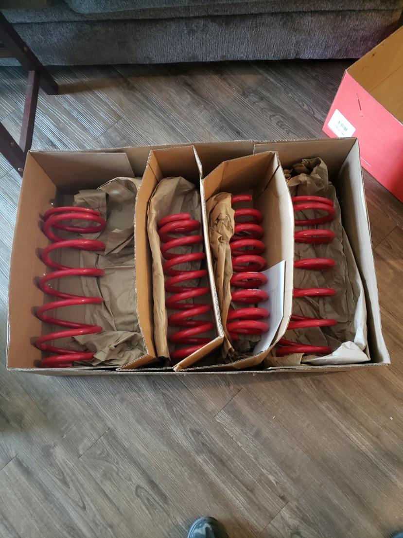

They came in couple days ago. Here they are, bad pic, as color looks off....but they look great in person.

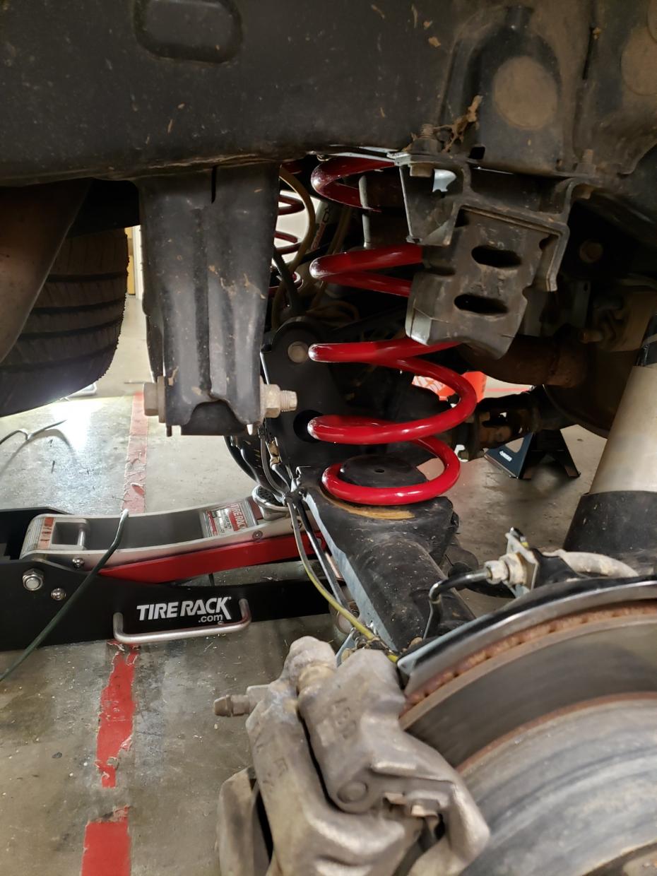

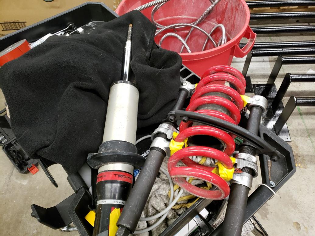

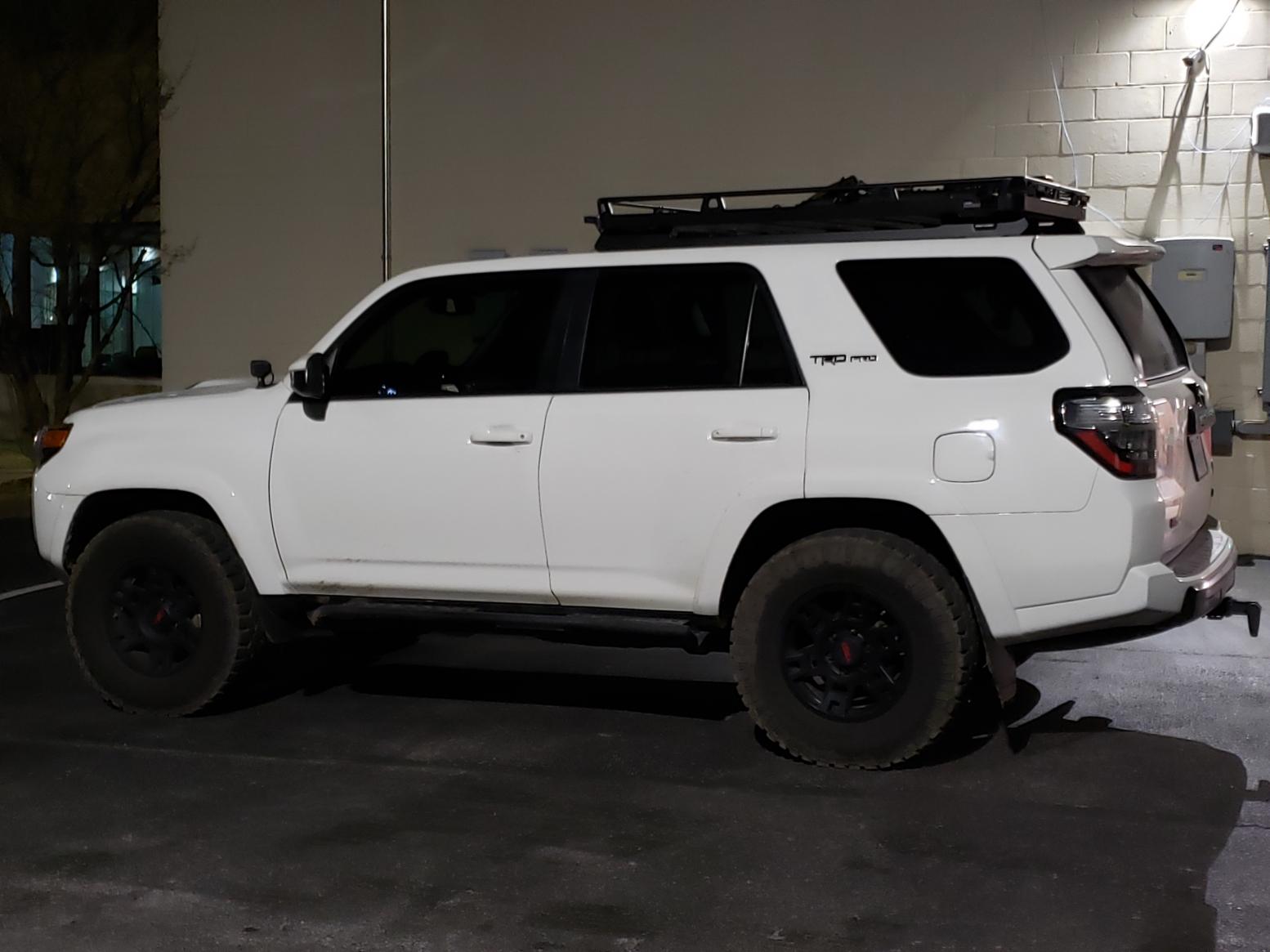

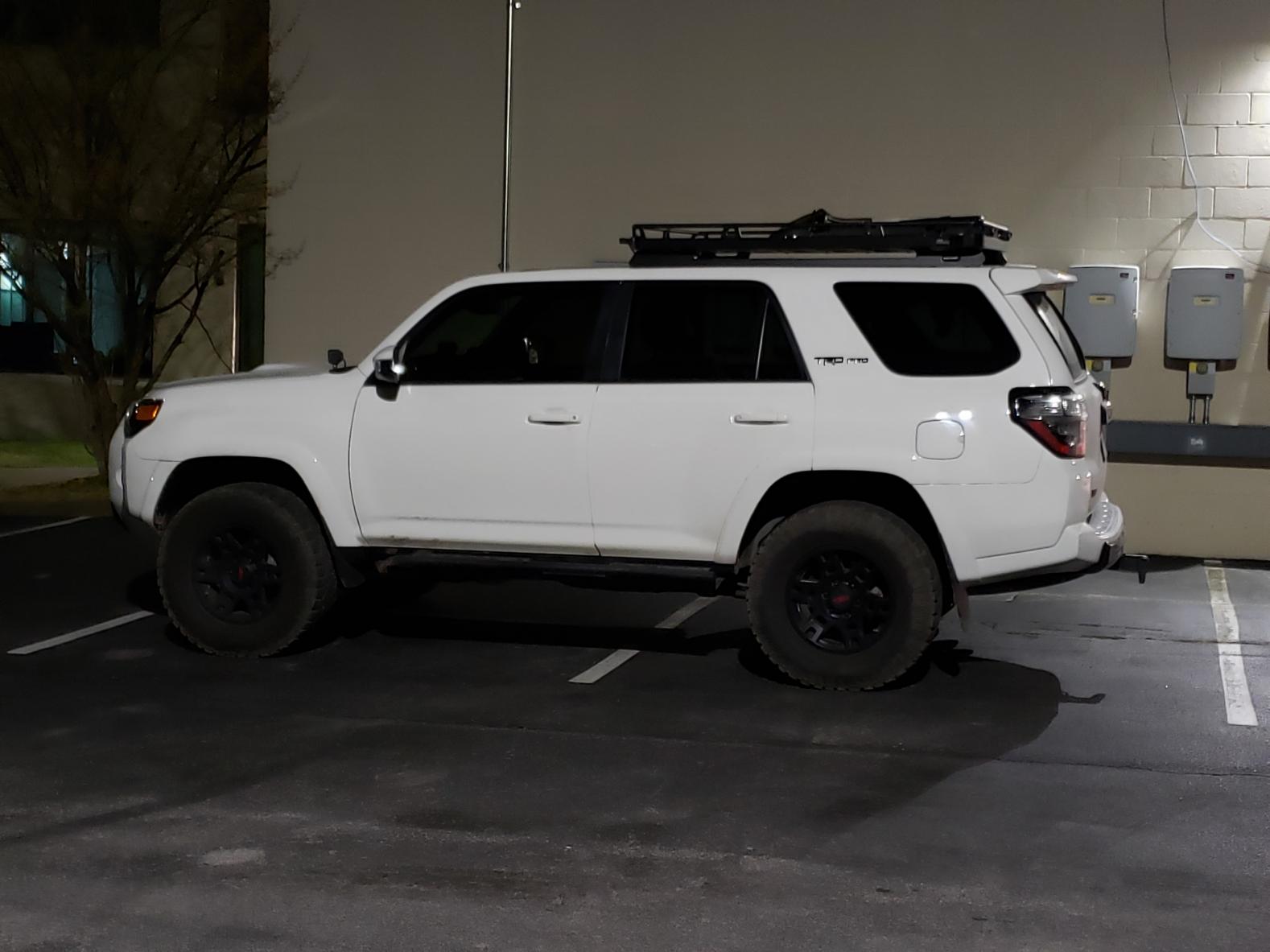

perfect timing...did mine last night...
from my "what did you do post....."
swapped out the stock TRD pro springs for the Eibach pro lift springs.
Pro tip...make sure you replace ALL parts BEFORE reassembly. One of the large washers that goes on the front strut, on the shaft below the tower fell off and i did not notice it. Found it sitting in cart as i was taking apart the other side. Anyways, had to do it twice. But I did get practice, and have the fronts down to about 30 min per side.
results....front end went from 21" to 23" from center of hub to fender edge.
rear when from 22 to 23 inches.
crappy pics, but it was late at night.
Dont have good impression yet as I only drove home last night, but intially they do feel a bit firmer and more controlled. I will be having alignment done tomorrow. After that I will see how they feel.
it did solve the very slight rubbing issue with the 285 70 duratracs.

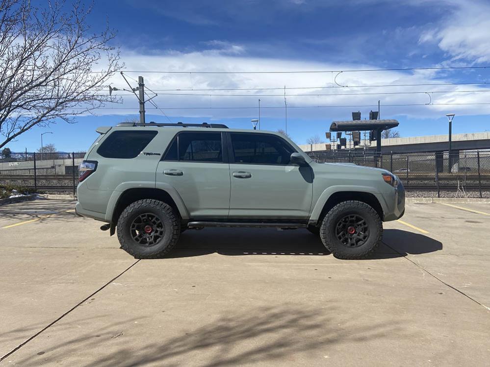

After a long wait, I got the Eibach springs installed and new 285/70/17 BFGs.
That looks great. I have the exact same truck and will be getting these springs installed with Toyo open country at3 285's. Do you have lift height numbers after the springs settled? Also besides removing the front mud flap are you getting a new rubbing or did you do additional trimming?
